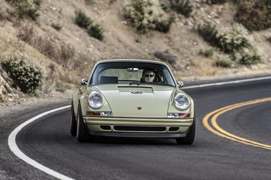

Thanks for moving this over here. I am very interested in what people have to say and what people are doing. I must’ve met I really do love the look of the singer shown here
I know it doesn’t look period. Correct but it looks really cool to me. Ideally, perhaps two the lights would be yellow and two white although I think it would look really cool to have them all white.
