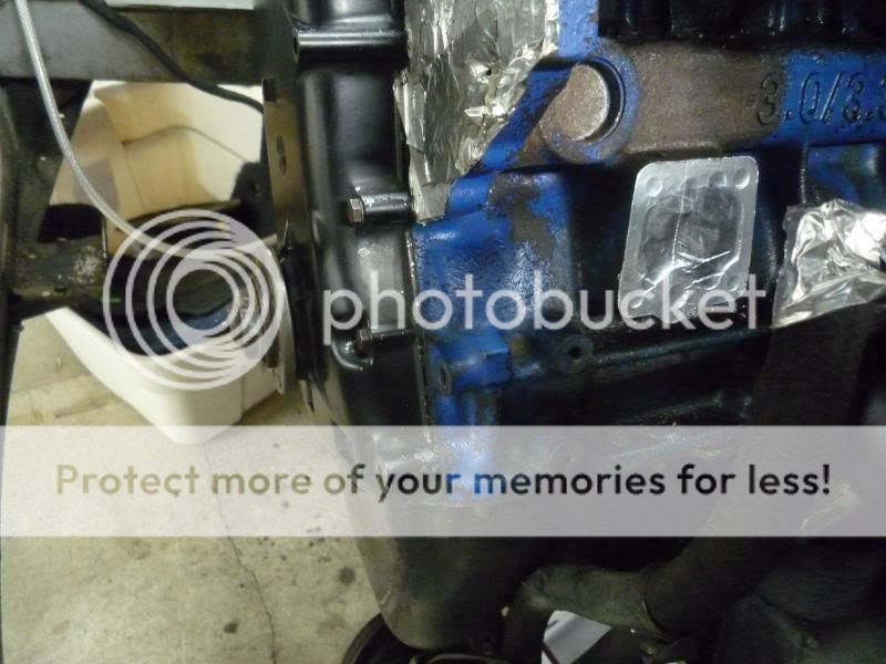

Started cleaning off my Block and getting it ready to repaint. I will probably use a Brush to do it. Tried cleaning the old paint off with a needle scaler (Suggested for my floor undercoat BY SF Don ...Thanks). It works basically instantly on a cast iron block to get it to bare rusty metal.
I am unsure if I want to go with the Blue or make it Black. Whoever built the engine originally did a very nice job finishing the timing chain cover in Black (Was this ever original on an M30?). Maybe leave it Blue if the engine might be a Korman or some other builder? I still don't know who put this engine together or what is inside.

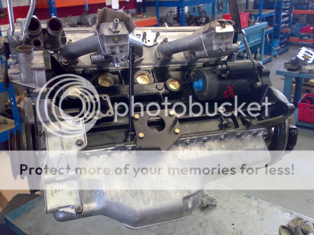

i painted mine in RUST-OLEUM black 750ºC resistant temperature paint, satin finish, wonderful
i used the same paint on the exhaust manifolds, and the result is still great
as far as i can tell, the block was originally black, see pic:

That looks very good DQ. Was it a brush on paint?

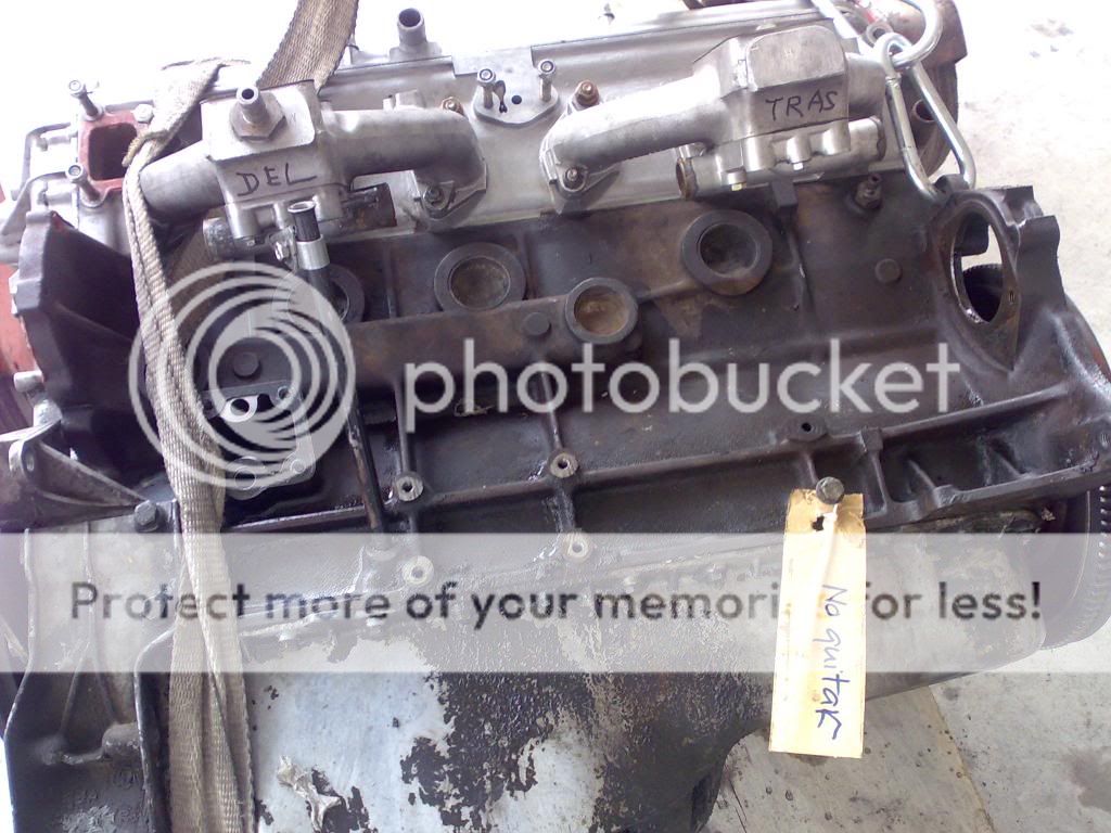

Something looks odd with your carburettor manifolds - have you got the the front manifold on the rear and the rear manifold on the front of the head?
The carburettors do not look like they will sit on the same plane. If this is the case you will have trouble getting the air cleaner fitted and, potentially, bonnet closed.

hi Rod, considering that you are referring to my engine, this one is deQ' s:
i am going to answer you:
1 - the manifolds are in the right position, the vacuum port comes from the front manifold, the only odd thing of my setup (being an euro spec car), is that these manifolds are the USA version because you can see the caped ports for the ECU system, incidentally i used these ports to interconnect the intake and thus to balance it, a great idea that our prosche61 friend (aka Jerry), told us some time ago
(BTW, ....on an RHD car everything CAN happen....:p ...don't put the blame on Fritz...)
2 - the carburetors sit in the same plane, and the manifolds are correctly mounted, your mistake is that you are not seing the engine in its position, when the engine sits on its plates, it is tilted a certain angle, that is the reason why to get an horizontal plane for the carburetors, the manifolds need to be seated slightly angled too

Can't argue with the results Luis. Looks as nice as I have seen. I do not want to use a spray paint if possible, as I do not want to get into engine removal. The level of detail you have achieved is what I hope to parody.

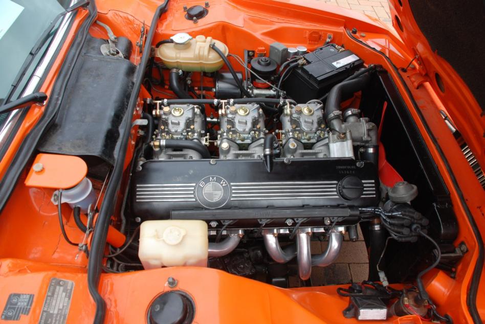

Here is mine. It is running 10.5:1 pistons 91.5mm diameter on a 3.3 crank (3.4 litres all up), balanced and a bit of a cam. I have port matched all of the inlets, custom extractors and running 40mm Webers. All through a five speed and LSD.
Power and torque is impressive (I think it is faster than my M6). I does need to be held at slightly higher revs to extract it - but it comes with an induction noise it is sensational.
