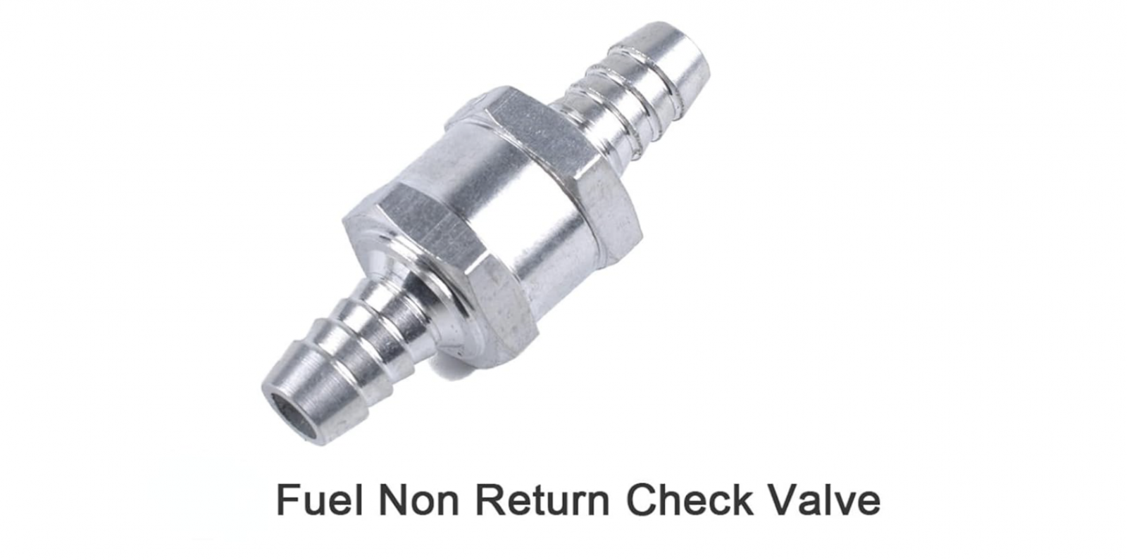

Hey Chope,
I used to experience the hard starting after my Coupe would sit as well. Also twin Weber 32/36 setup. After installing a fuel line check valve, some fuel would stay behind in the fuel line, closer to carbs, after car was parked. Was much easier to start if it sat a week or so. Not expensive, simple install, perhaps worth a try before you go the electric route? Good luck.
