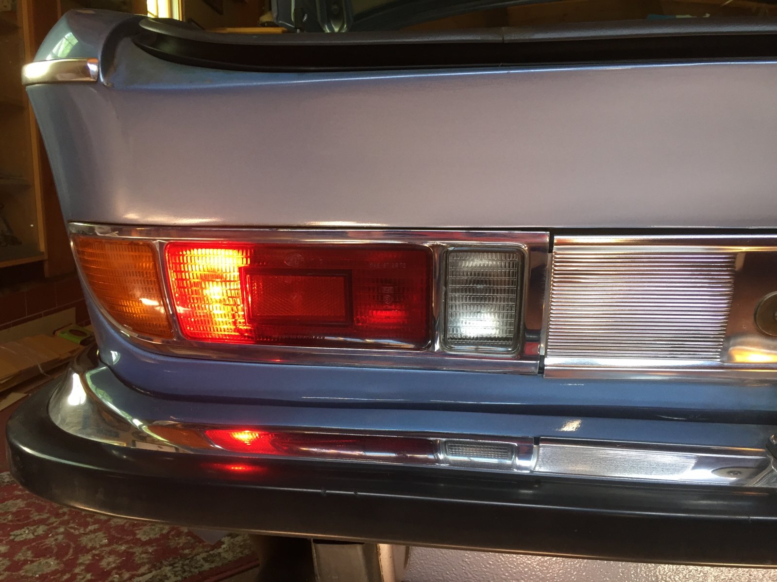

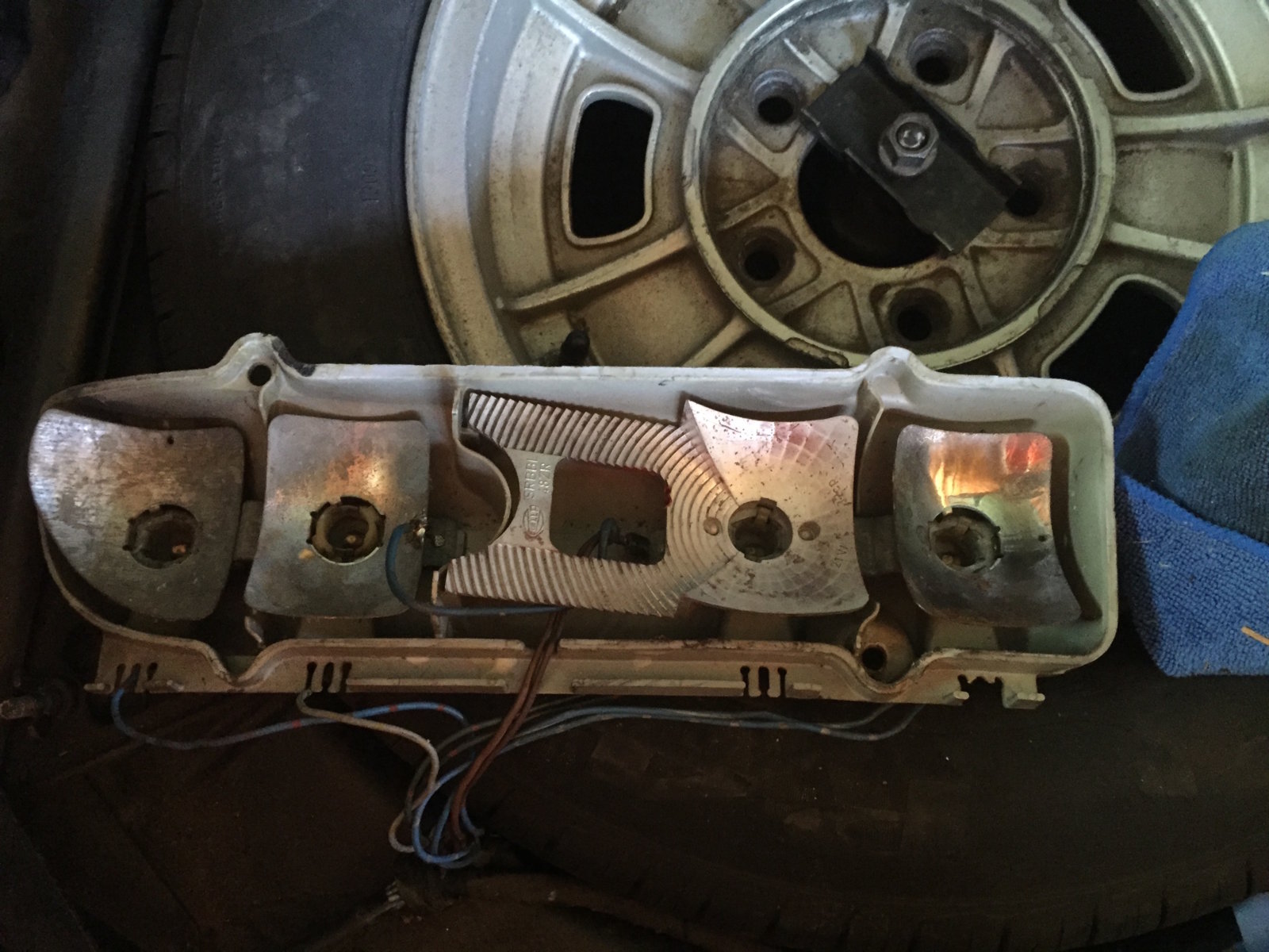

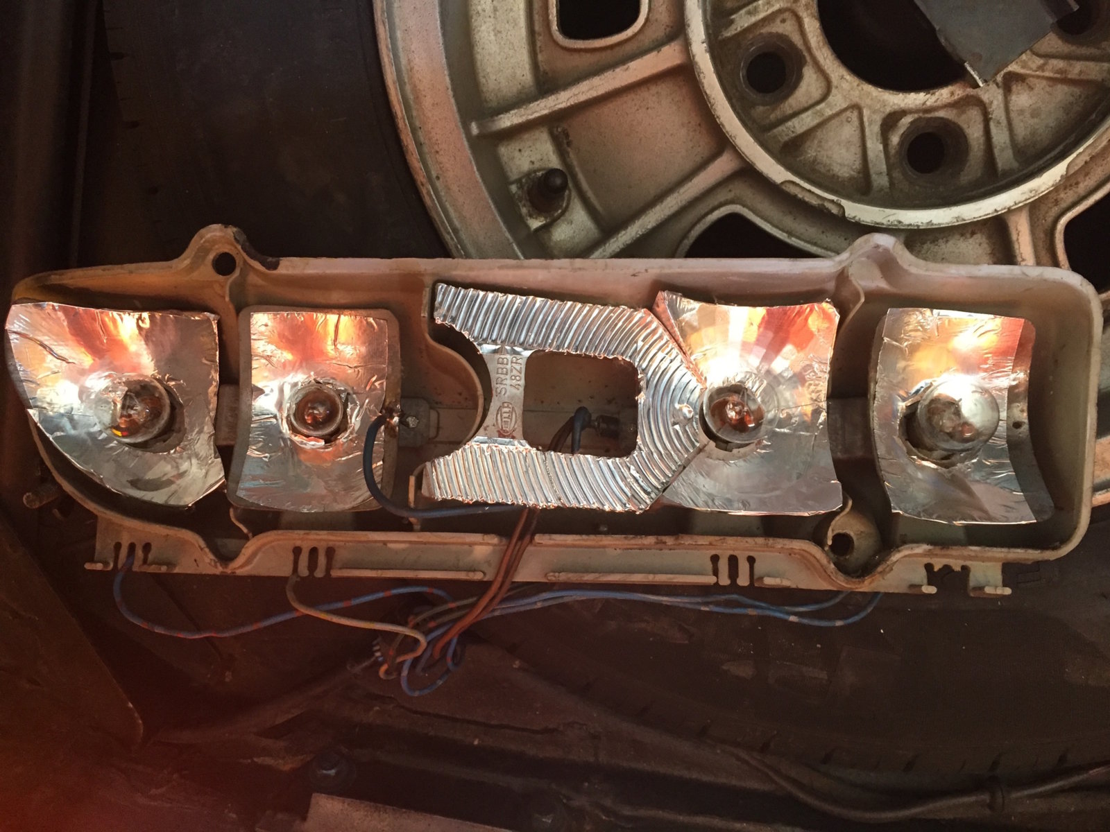

For tail lights I used aluminum tape to restore the reflectors. Simple inexpensive and works wonders for brightness. I refuse to use LEDs when Incandescent bulbs are very inexpensive and readily available.

@Stevehose can recommend some high quality regular bulbs for the rear lights, number plates and interior lights. I did the heat resistant chrome tape job too, very effective.

Another vote for the chrome tape. I am going to upgrade to the 4W incandescent bulbs in the dash so as to be able to continue to use the dim function. On longer drives or darker roads at night, I like to keep the interior dimly lit to help with my night vision (its a bitch getting old).

4 watt bulbs, reflective tape these are great suggestions, Thanks! I've order some 4w bulbs from eBay already. Now just have to find the tape.
