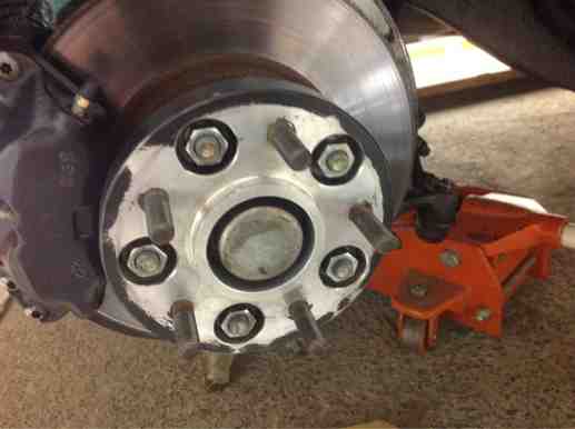

Here are the wheel spacers I run to let fit these wheels, they are 24mm thick

Thanks Steve - mine are 245/40/17 on 8" rim ET 20 and I'm looking for the max spacer width possible without flares. Lots of room on the inside (25 - 30mm) but guessing 10mm to the lip which has not been rolled.
Any reason the rear lip can't be rolled like the front? Seem to recall Pamp said he did his for his gorgeous style five 9 x 17" wheels. Have to search.

Can't see why you can't roll the rears as well, I didn't need too on mine. The rear lip is much thicker as it is two thicknesses of steel, not sure if you could do this without stuffing up the paint on the outside of the car?
