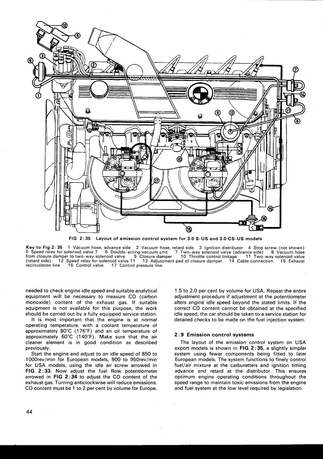

Assuming your ignition system is properly functioning, (e.g., ignition timing is not seriously retarded or advanced) have you tried adjusting the potentiometer on the ECU? In short, this can affect idle mixture, assuming all other systems are in working order. (See Slow running adjustments - below.)
