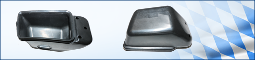

Some of y'all might have seen this email blast today...
Rubber fuel filler surround is available from Walloth at a special introductory price of 49.95 euro.
https://www.wallothnesch.com/en/newsletter/dichtung-fuer-tankeinfuellstutzen.html
Now... if anyone has any tips/tricks in installing this. When I removed mine before paint, I knew it would be a challenge to reinstall it. ....lots of patience will be required to keep from scratching the exterior paint.
