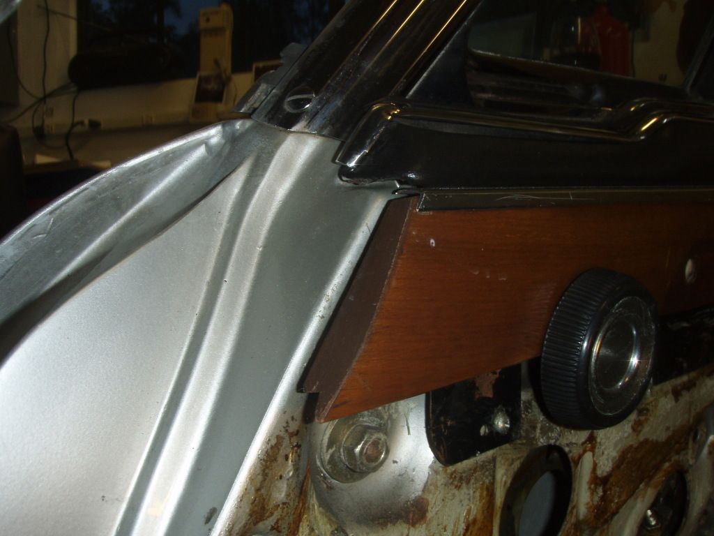

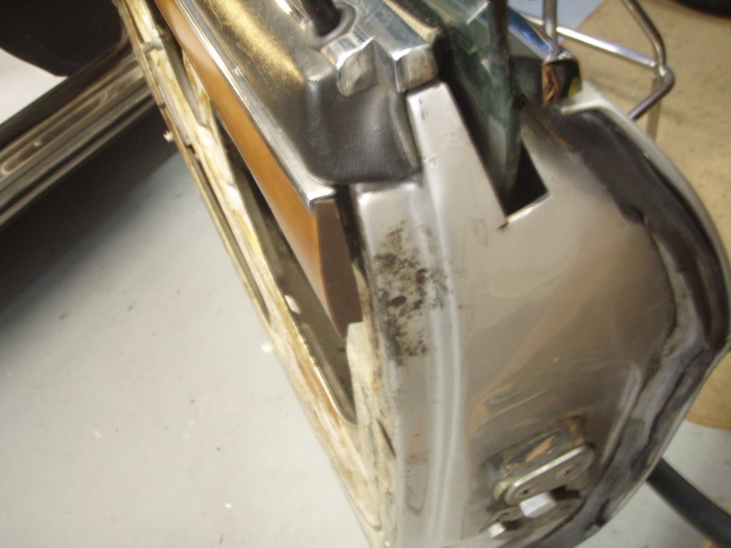

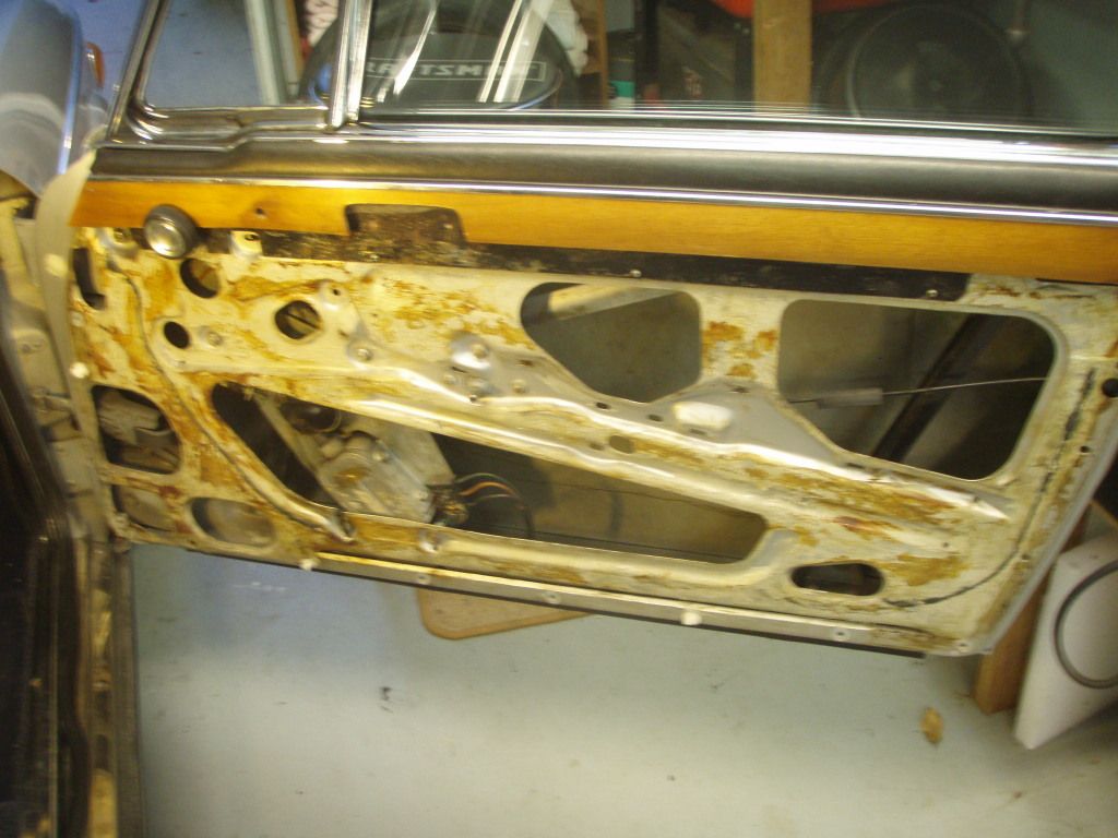

Step one: remove the door panel. This is no more than popping out the plastic pins from the door frame. If this is the first time around, you'll probably have some pull out of the cardboard panel instead of pulling out from the door. Watch out for any small screws used to hold the panel in. I had one located in the rear upper part of the panel on the drivers side, nothing on the passenger side. You don't have to take off the wood trim or wing window knob, the panel fits in underneath it. I also removed the ashtray for good measure.
You can see the gap under the wood trim here

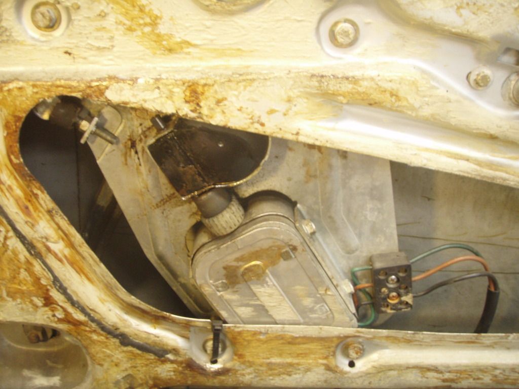

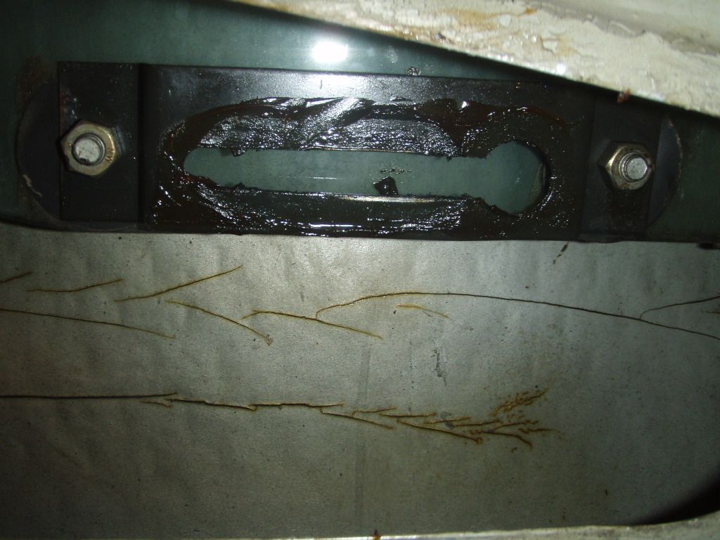

Next, I'll make a long story short. I partly disassembled pretty much the whole window assembly in one way or another. There are two sets of bolts in the window, one that holds the lift mechinism to the window, the other that hold the guide shoes to the window. Don't mess with either. The short answer is to remove the four bolts that hold the motor drive to the door. You can see them here at the upper and lower corners.
The ty-wrap holds the wiring harness up against the door so it soesn't get into the drive. Once the assembly is loose, you wiggle the lift arm around until the flange at the end can come thru the enlarged slot at the end of the lift plate. Easy peasy removal although you might get a helper to hold up the window until the drive assembly is removed.
Next, drop the lift arm via the switch to get it parallel with the door so you can take the whole assembly out of the door. I started with the window in the "up" position so I could reach everything but then the lift arm is in the wrong position. Here you can also see where the four bolts were.

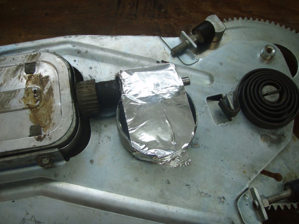

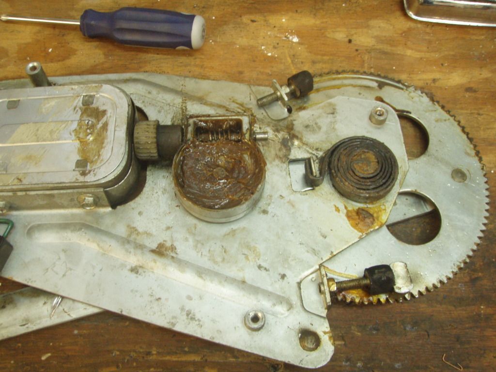

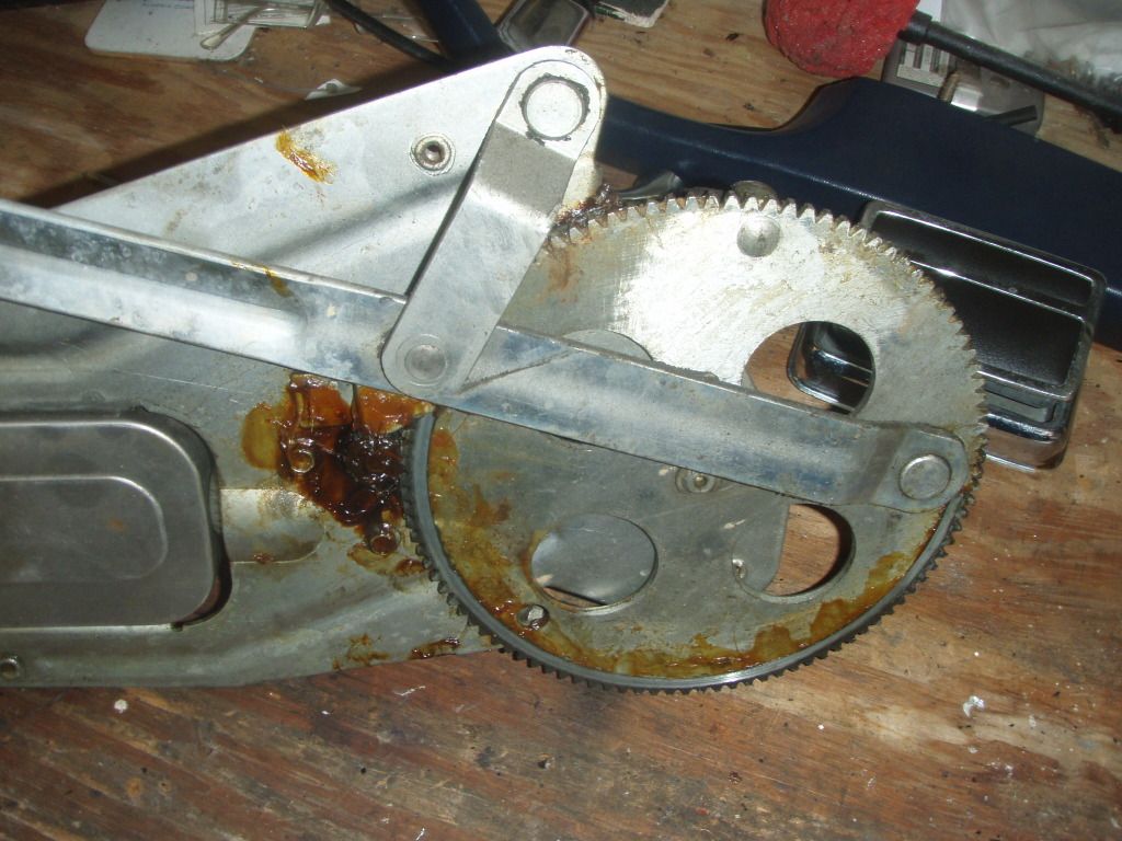

Here's the assembly on the bench. I've unbolted the motor and pulled it away from the gears.
The back side

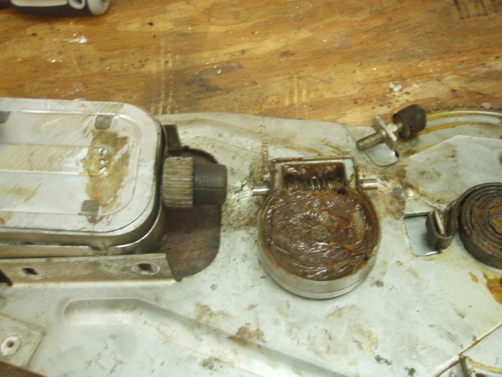

Are there any "user serviceable" parts in the motor? If I take it apart can I do anything like clean bearings and replace brushes, much like with the windshield wiper motor? Or should I buy a new one? Any tests to see if it's good? I've got a good auto electric shop nearby, can they rebuild it?
I can't get the worm drive assembly apart because one of the mounting bolts is hidden behind the big gear. I can take that all apart by removing the big spring but the arms are all riveted so I'm not sure I'd be making any headway. Maybe just wash the whole thing clean in the parts washer?

If you turn the gearbox shaft manually so the regulator arm is about halfway up, the third gearbox screw is accesible through a hole in the regulator gear. Then you can remove the gearbox and clean out the old grease and inspect the plastic gear and regrease. If it is worn out the only option is to track down a decent used box. Also inspect the housing around the little metal gear, this can get bent out of shape from sticky regulators.

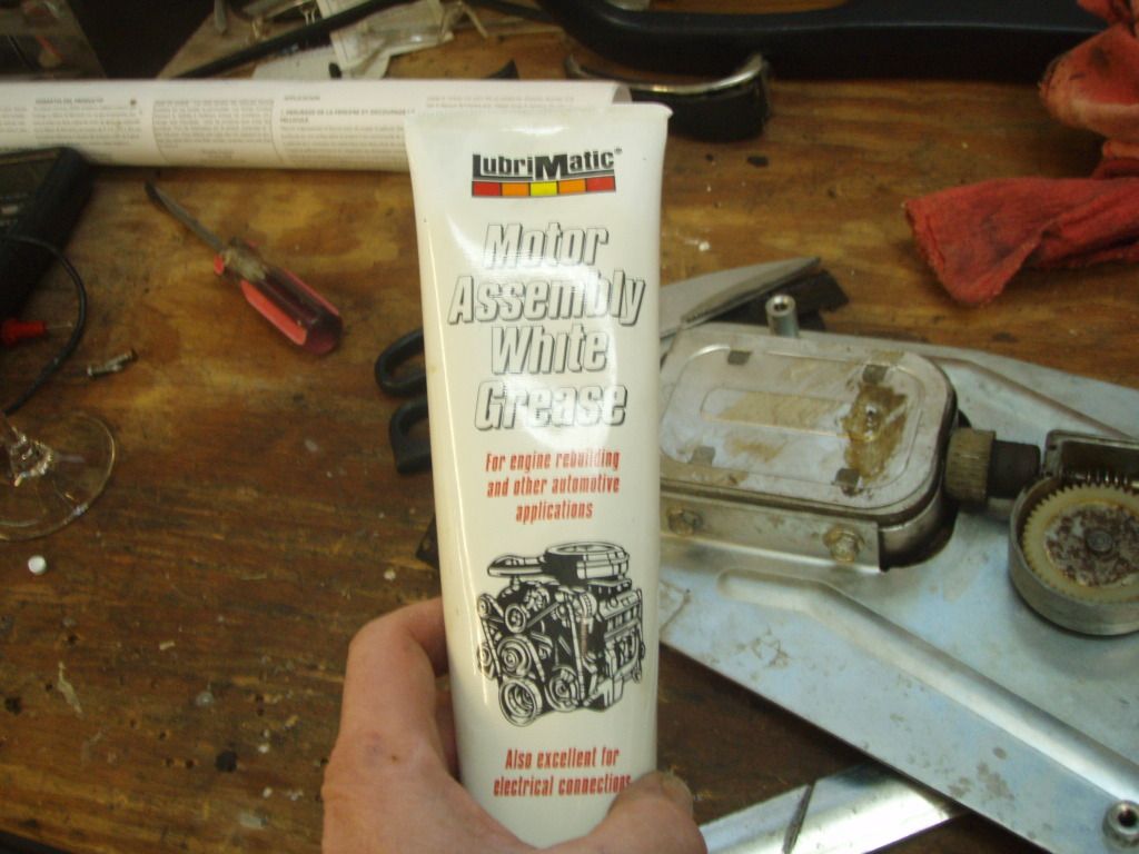

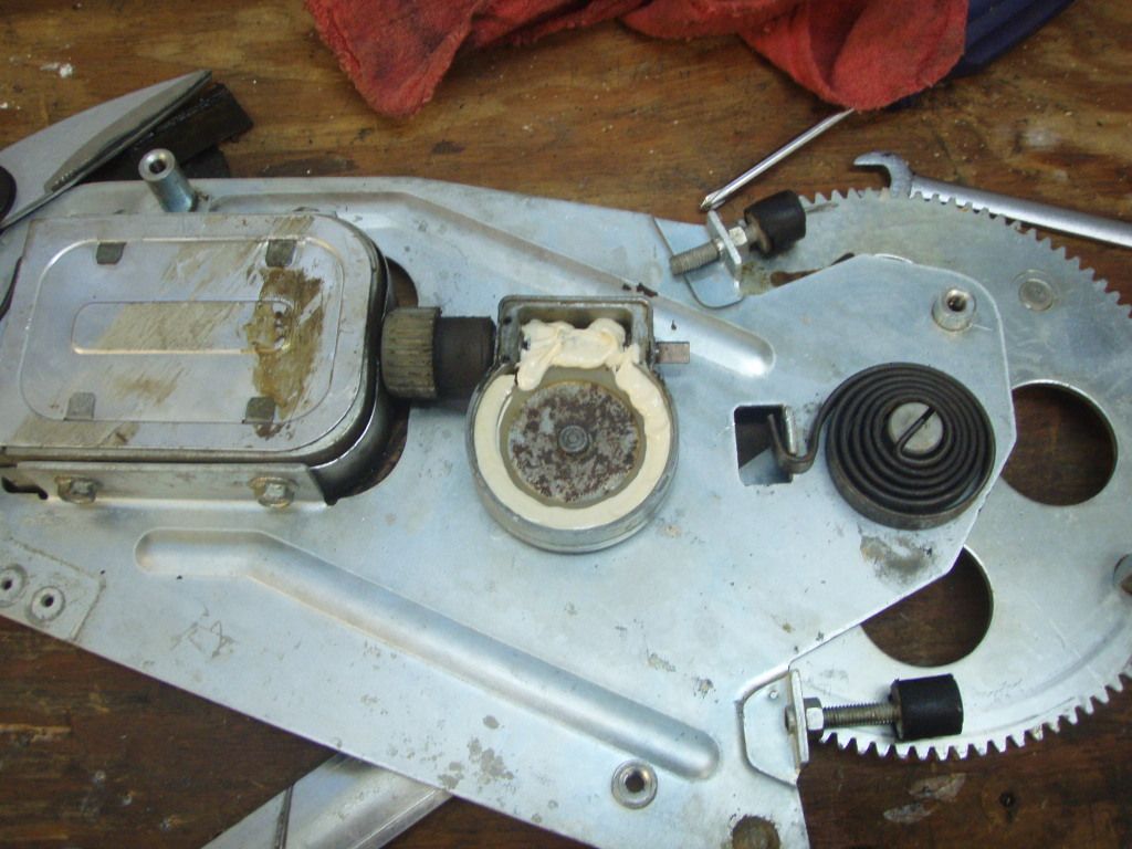

OK, so now I've cleaned up the gear drive and motor (didn't take it apart). I used this for grease:
It's lightweight but designed for EP service
Job done
The plastic backing broke but I think this will work. I used duct tape (the real stuff) over the broken pieces

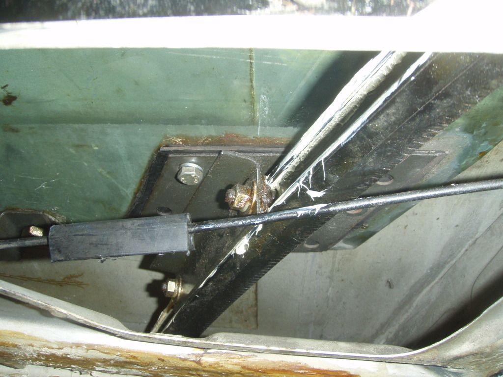

The motor still gets really slow in about the last 4 inches of travel in the up direction. I made the mistake of loosening the bolts that hold the track brackets to the glass when I did the original disassembly. The cap screws against the glass (you can only see one in this photo)
Well, the window seems to have shifted because it's really slow at the top, almost doesn't make it. I've loosened the four bolts and run the window up and down to try and "settle it into position" but no luck. I'm also reading the voltage at the motor as 8.5 VDC. I've got the relays but am trying to avoid installing them. Looks like I may have to.
Edit: I just tried full voltage to the motor via a direct jumper. The window definitely jumps to the top but this doesn't seem right to have to use voltage to overcome the resistance of the window in the track
But why is the window so stiff at the top now? Any suggestions on how to adjust it?
