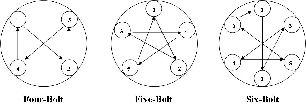

I remember when I had my second BMW a red 1986 325 ES and bought new snows for winter driving. I had my mechanic put the snows on every winter and immediately I would get warped rotors. It took awhile and I finnaly realized what caused this to happen. The wheels were being torqued wrong,causing the rotors to warp. This would happen both when snows were put on and than again when they were taken off and the reg. tires were put on. I told my mechanic I wanted the wheels put on using a hand tire wrench and the problem was solved.

I will almost bet that the torque is the culprit. It happened everytime I changed my wheels. I would end up getting new German rotors from Greenfield Auto Repair for under $25 each and the problem still occured after nthe wheels were put back on the car. There was only one thing to do,CHANGE MECHANICS. That is what I did and the issue was solved.

Even if they are accurate, the "over" torque numbers presented would not likely warp rotors. Not saying they can't, just that it is unlikely. The more likely scenario IMHO, is when lugs are tightened unevenly, and especially when the wheels are hot. Something rarely discussed is the fact that just like other fasteners, the addition of oil, grease or even water on lug threads can change torque readings. One would like to think that most shops dealing with expensive cars, tires and rims - know enough not to use an air impact wrench capable of 300+ ft./lbs of torque for tightening. This practice might explain so many cars driven with one or two broken lugs. The lug torque specs include enough tolerance for the average Horst to remove and reinstall them for roadside repair - without a torque wrench. This doesn't mean the torque shouldn't be checked, but I submit it is less critical if the star "crisscross" pattern is followed.
