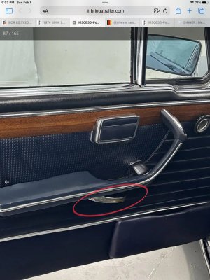

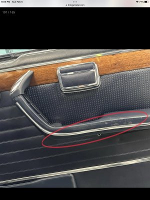

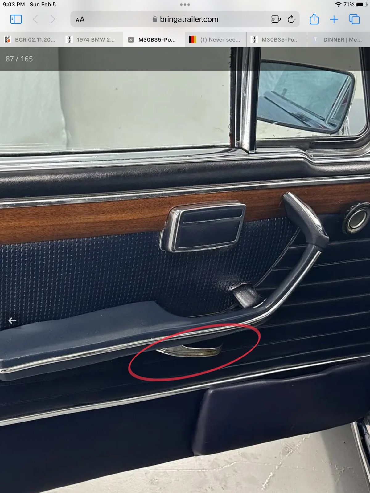

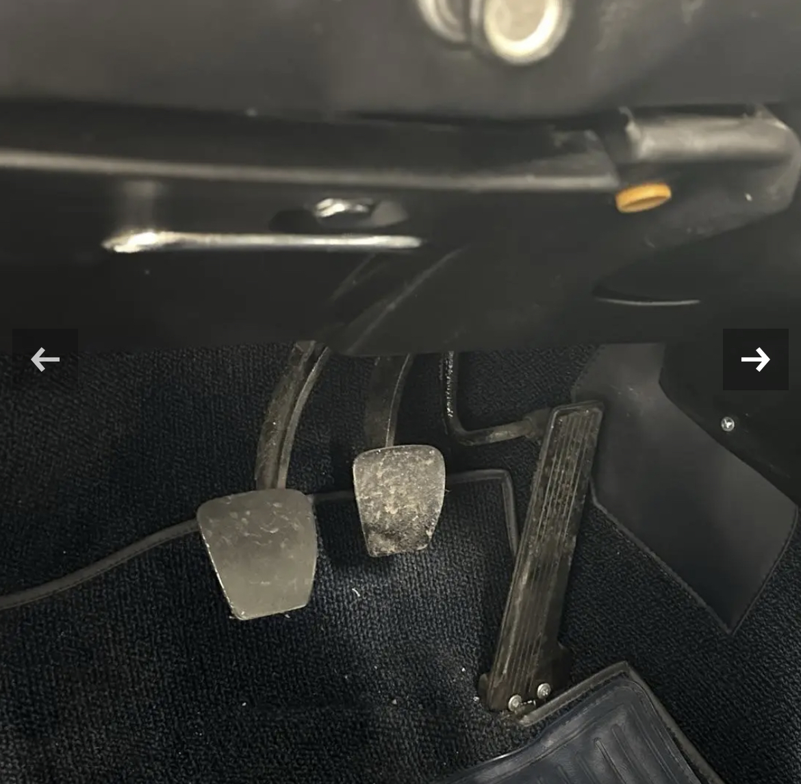

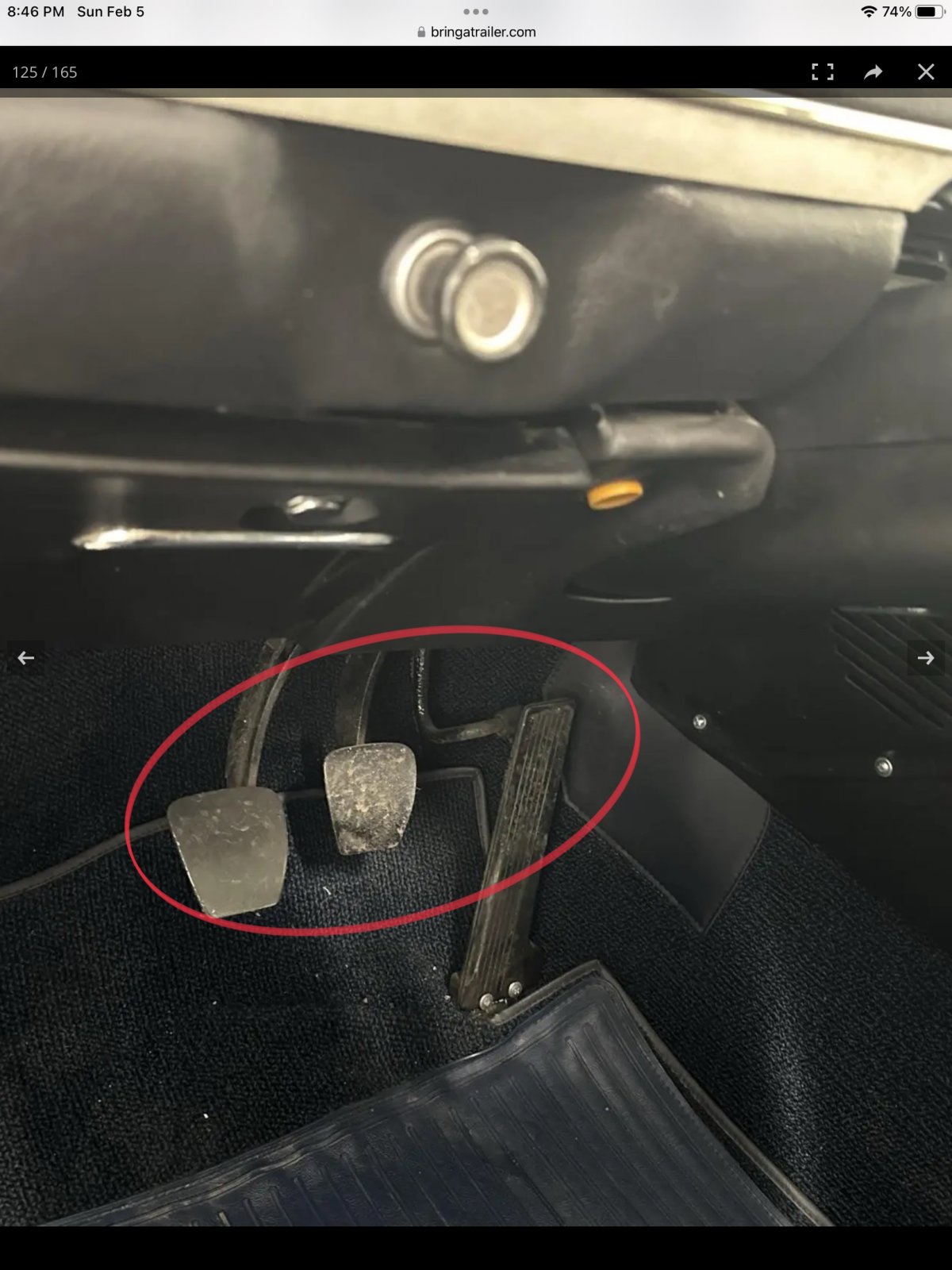

I don’t know why those E21 rear side markers were left during the repaint. Look at the pedals.
Speedo doesn’t work and seller obviously never told BaT as they would definitely disclose that.

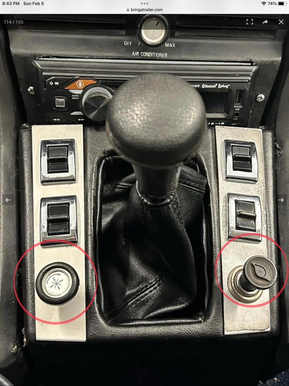

Someone put this switch back on the car!

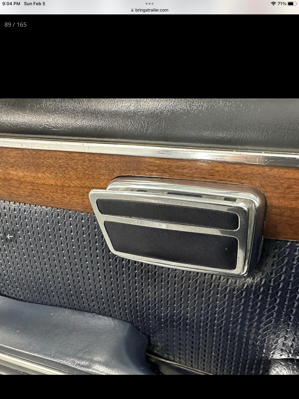

Air-conditioned rear window.

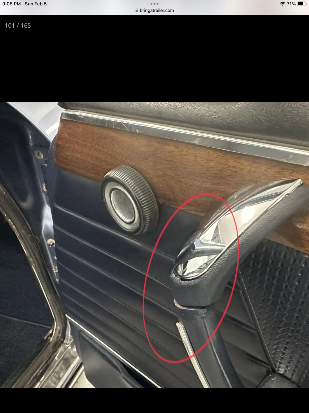

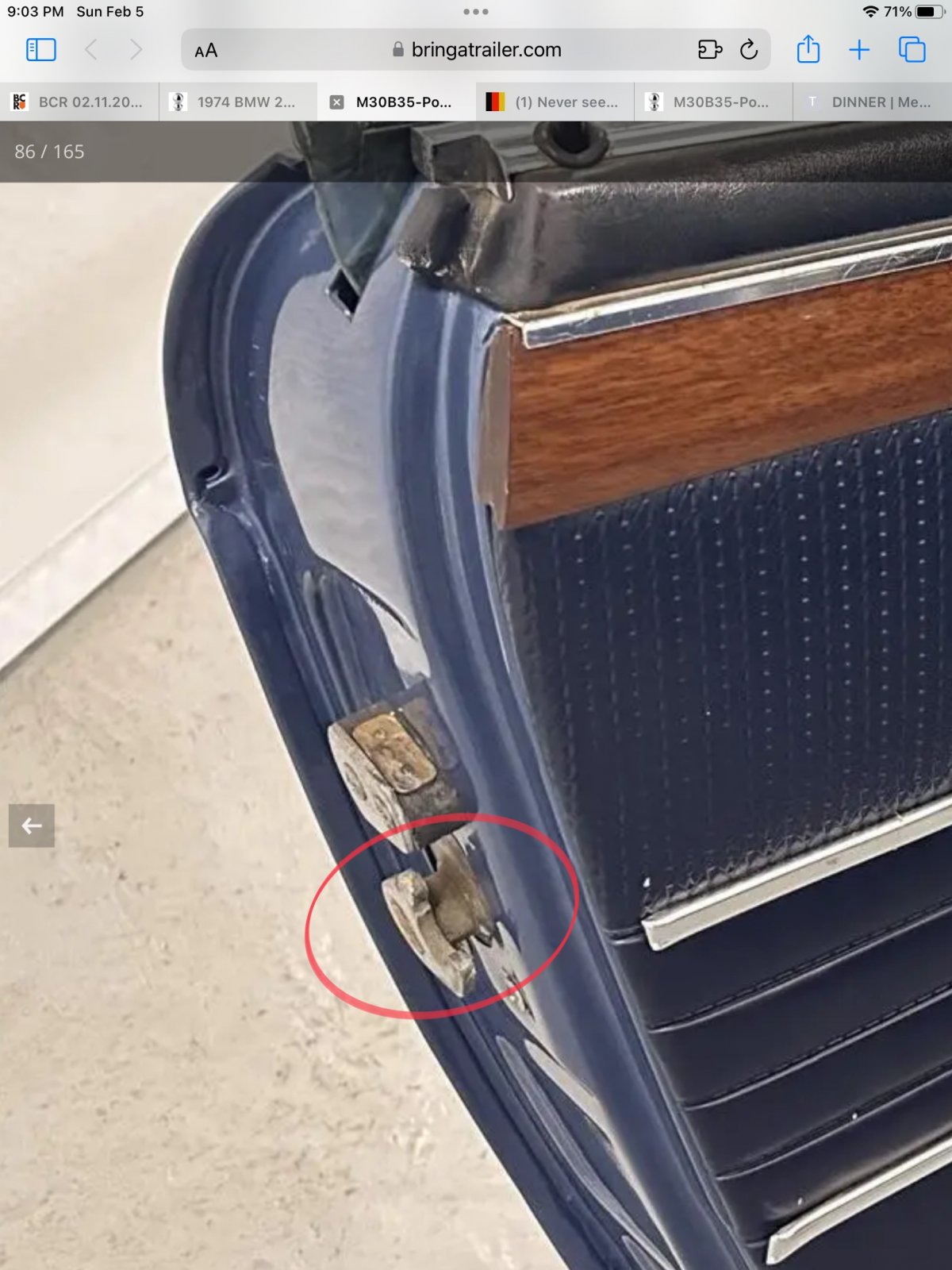

Door latch buffers are $10 ea now and black so I can see why they were left off. Of course the doors are about a foot back from the front fenders so they might not fit.

@HB Chris the steering column is a fine spline E28 column (both top and bottom column trim is plastic, you can tell by the hub on the steering wheel as well). I think the pedal bracket must be from an E12 or pre 9/82 E24 which is the only way that intake manifold would fit.

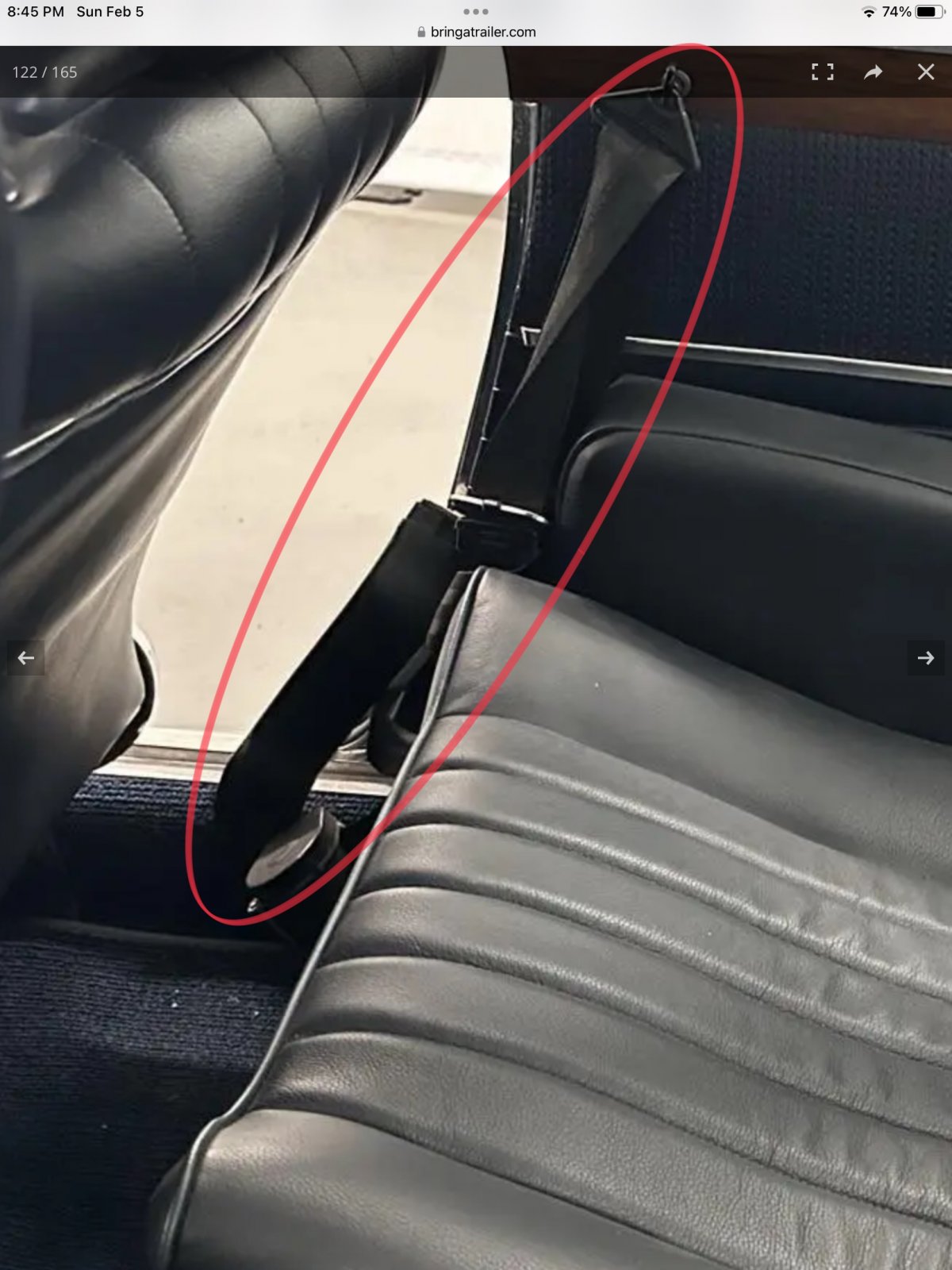

Re-posting here. The floor pan replacement work is indicative of a dangerous lack of detail. It is evident that the floor is not fastened to the frame rails as it should be. I fear the buyer/driver of this car will be hurt by even the smallest fender bender - if not simply driving over a speed bump. The seat belts are useless as installed. Isn't there some level of oversight for selling such a car on BaT? Does this car even have a clear title, or is it salvage?
