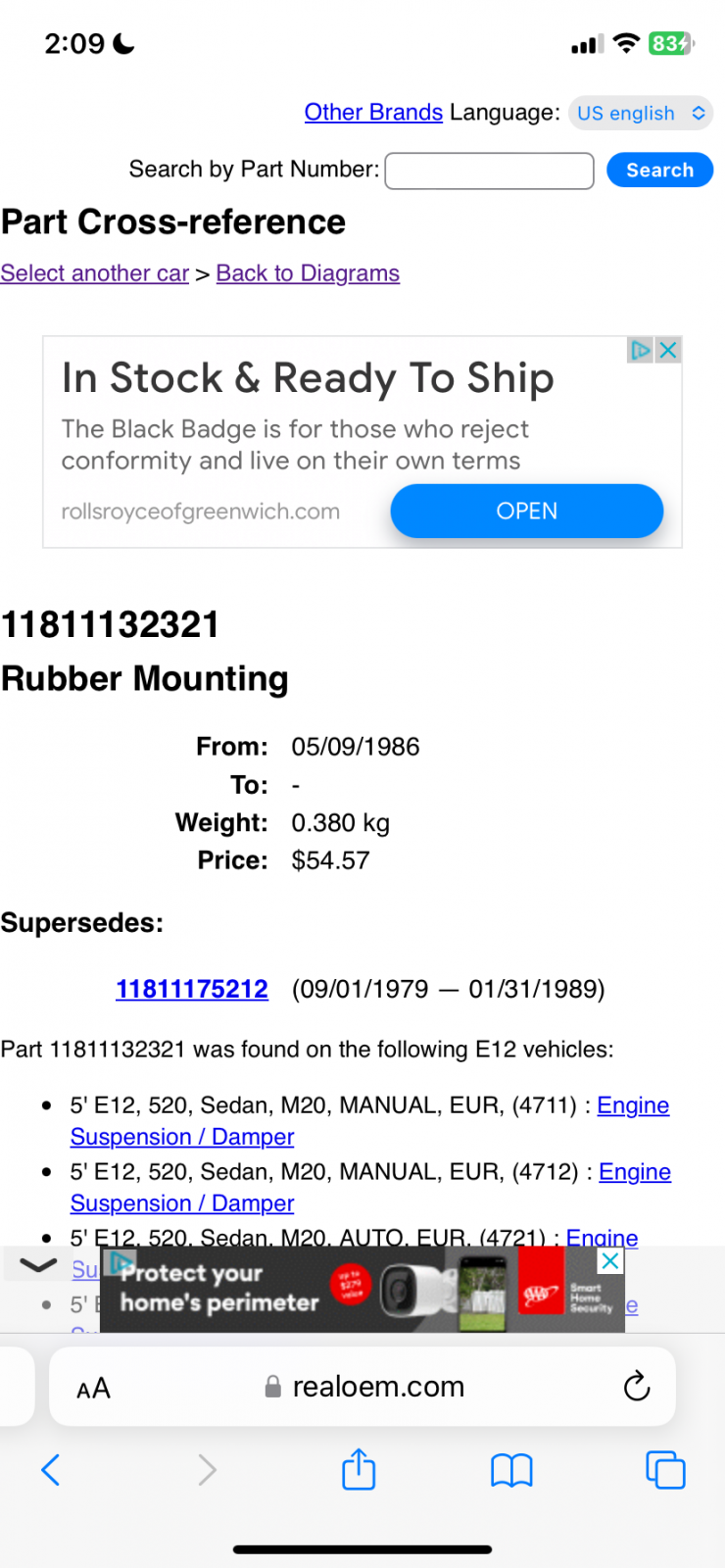

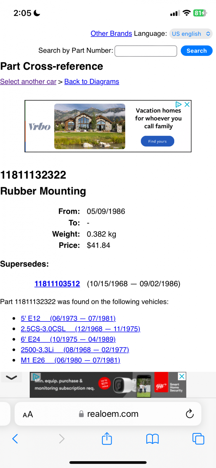

One query I have on the mountings, Real OEM gives part number 11 811 132 322 however I have sourced a Febi Bilstein part number 06739 that cross refers to 11 811 132 321. This shows in Real OEM as E12 '97 to '81 whereas 322 shows E12 '77 to '81. I hope this is the same part, time will tell.

Part #11 811 132 321 is specifically for 2 liter engines?

Thankfully they are identical apart from one stud being about 1/2" longer which is neither here nor there with regards fitment.
