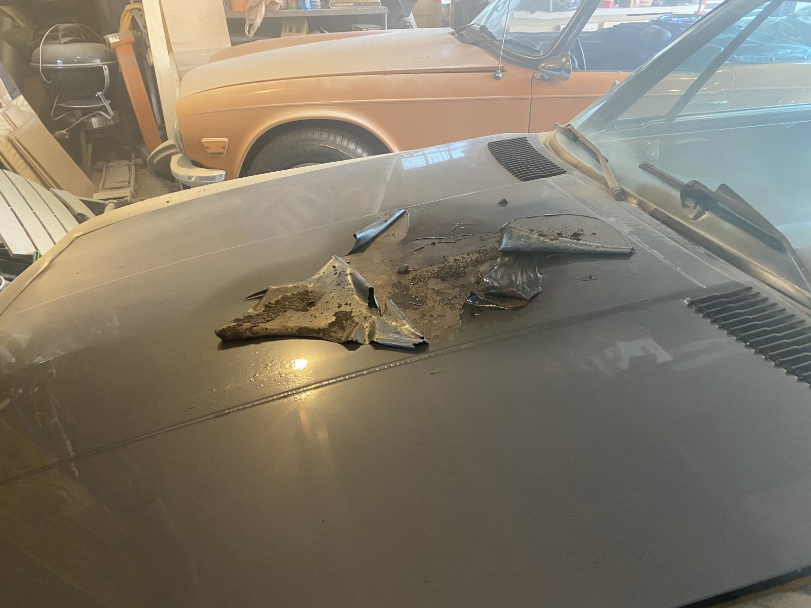

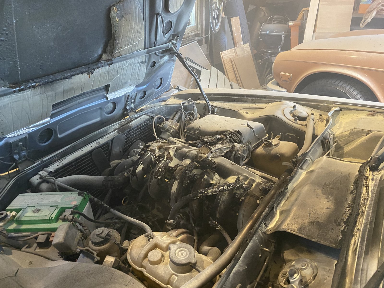

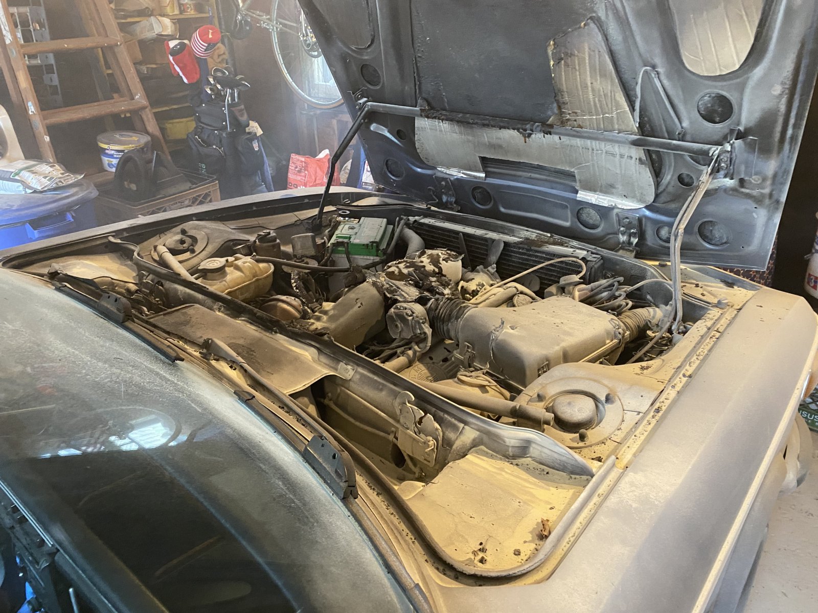

I went to start the car yesterday, and as usual after a few weeks of sitting, it won’t start on the first try. I usually give it 5 or ten minutes and It starts with no issues. This time it caught fire. The battery was connected and the ignition was off. I attached some pictures.
I was lucky, I was in the backyard next to the garage when I saw the smoke and had a fire extinguisher, or the fire would have probably taken the garage too.
I need to call insurance on Monday, hopefully I’m covered. I don’t think it’s a total loss but my agreed value is only 35k.
I not sure I can sort this out by myself. Fuel injection and electrical wiring are not my expertise, especially on a 50 year old care with many parts made of unobtainium.
This bad timing as I’ll be out of town for 2 weeks, and I’ll need to get thing done remotely.
I’m in north jersey, Bergen county. If anyone knows of a good mechanic please let me know.
Thanks …

Luck favors the prepared. It's hard to tell the extent of the damage, but you stopped it before it got much worse. Others will chime in, but it looks very repairable to me, albeit the time frame will be dependent on parts availability.
I wouldn't rush it off to a shop until you get confirmation of coverage from your insurance company. They may want to send out an adjuster and if you've started repairs, then the condition of the car will have been modified and they may decline payment or reduce the amount because they can't see the full extent of the damage or be able to determine the source of the fire. Been there, done that.

You will want a new engine wiring harness. Not used. Used is 50 years old and brittle.
Somewhat difficult because cores are required by both AutoSpark and myself.
That said, I have cores available. It’s the conduit on the valve cover and the connectors that are needed. Think 3-4 months for AutoSpark and 8 weeks for me.
Your trigger points are likely ok which is really important, not so good for your TPS and injectors and MPS which will need to be replaced. Possibly you can media blast and powder coat your intake.

This is not a carburetor problem. The car has fuel injection.
This may be a failure of the short little fuel hoses connecting the injectors to the fuel rails. Because they are hidden below the intake runners, they are often neglected.
