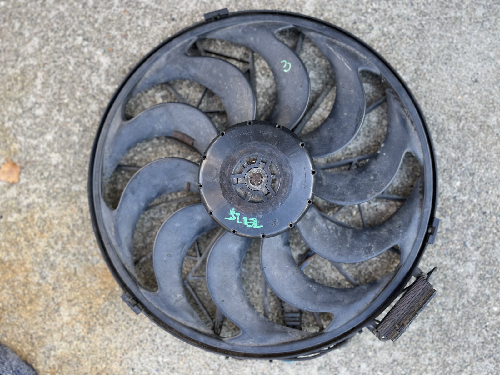

I have an electric fan on my e3. It's the auxiliary fan #64541392913 from an e31,32,34 or 36.
I use a 90/99 dual temperature switch hooked to a Volvo 2-speed fan control relay to operate it is two speeds.

Kent - For best fan efficiency, you want the largest fan you can install, along with a fan shroud. I first seek out an e24 fan shroud, which (I think) will fit on our radiator, and then get the largest SPAL puller fan that will fit within that envelope.

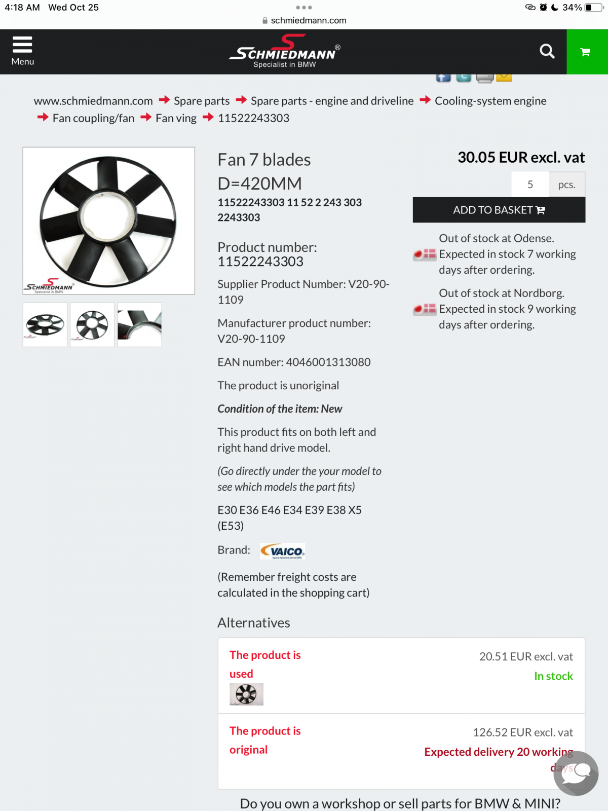

Being in UK, you can easily buy the e32 fan clutch and super duty 7 blade extra thin reinforced fan combo that we install. Add a quiet high flow pusher fan with curved blades like the Spal 30102056 (NOT Chinese fake on EBay). Installed with an aluminum radiator and a 6er fan shroud with a 90*C sensor at the thermostat….. If you are old school original thermostat housing with one sensor hole, you can install the Saudi version BMW 70*C sender (12631285018) in your new aluminum radiator at bottom fitting.. Now that’s cool! Remember to drill and index the thermostat…and if you have AC and are using the same relay to operate the auxiliary fan for temperature control and AC you will need a diode (61 31 1 358 265) so your hot engine doesn’t turn on your AC.

It only over heats when stationary for a long period in heavy traffic, due to the original 5 blade fan clutch being worn. As the fan it self was in poor condition I was weighing up changing the water pump and fan clutch to the later style (Already have spare 9 blade fan) or going electric.

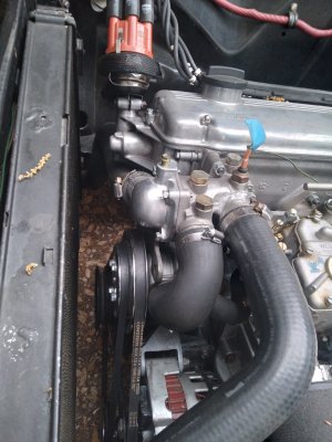

Hi Adam, the fan is in 'Pusher' mode and I enjoy the added clearance for dealing w/ belts, etc.
Mine's configured the same way, in the pusher mode. There's not a lot of clearance for a puller fan in my car. If I'm idling for a while the low speed comes on at 90C and that's usually enough. Once I'm on the road doing 35 or so it cools down and the fan shuts off.

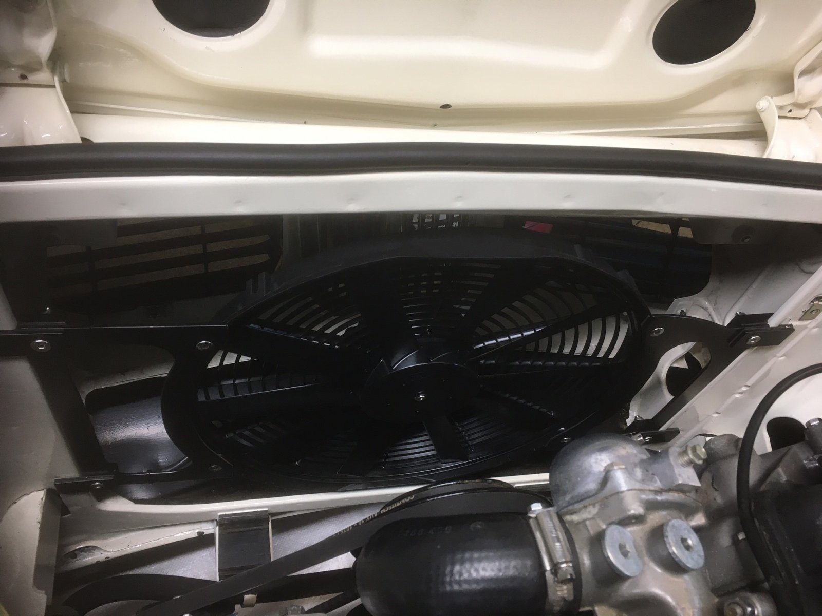

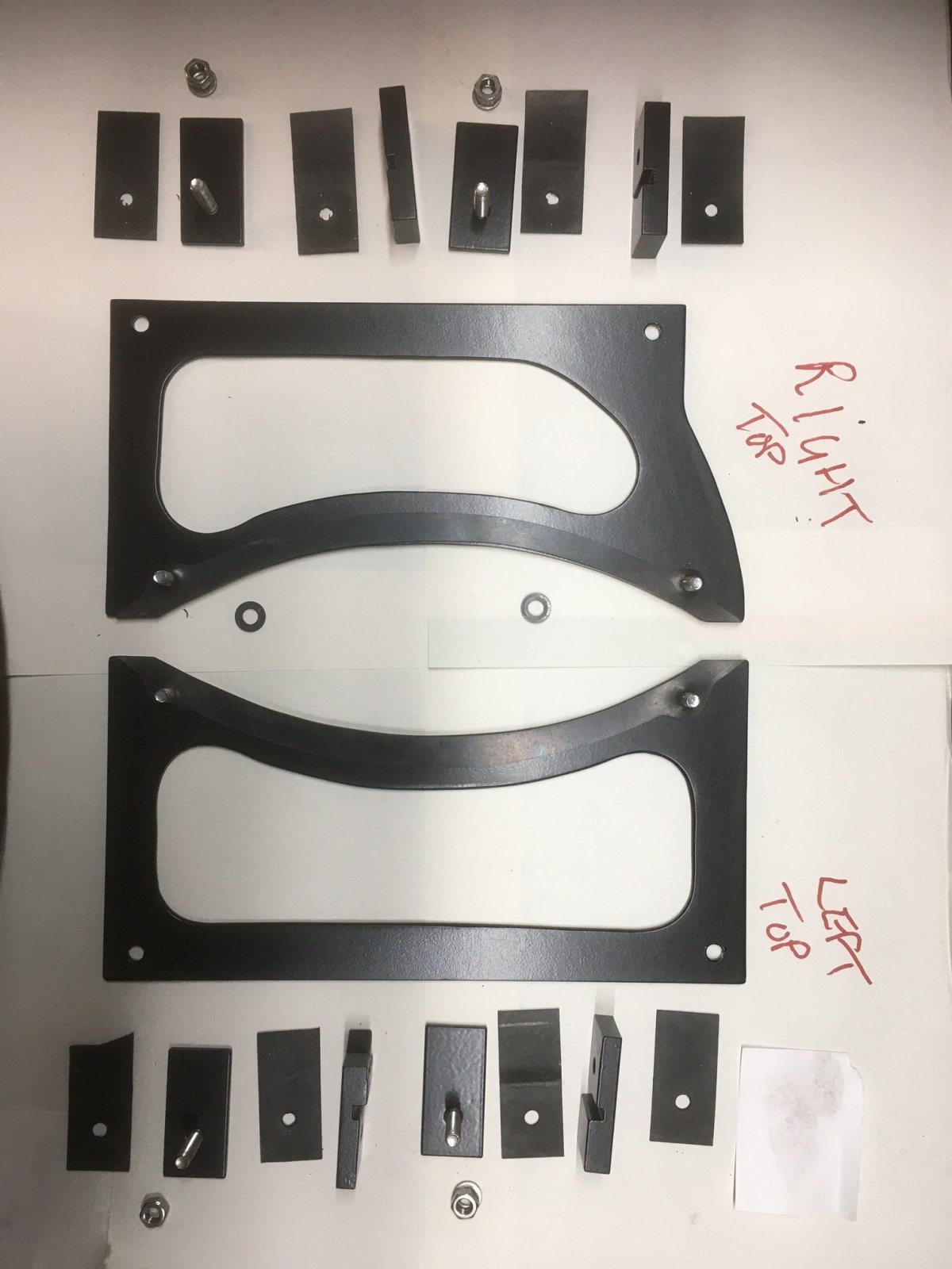

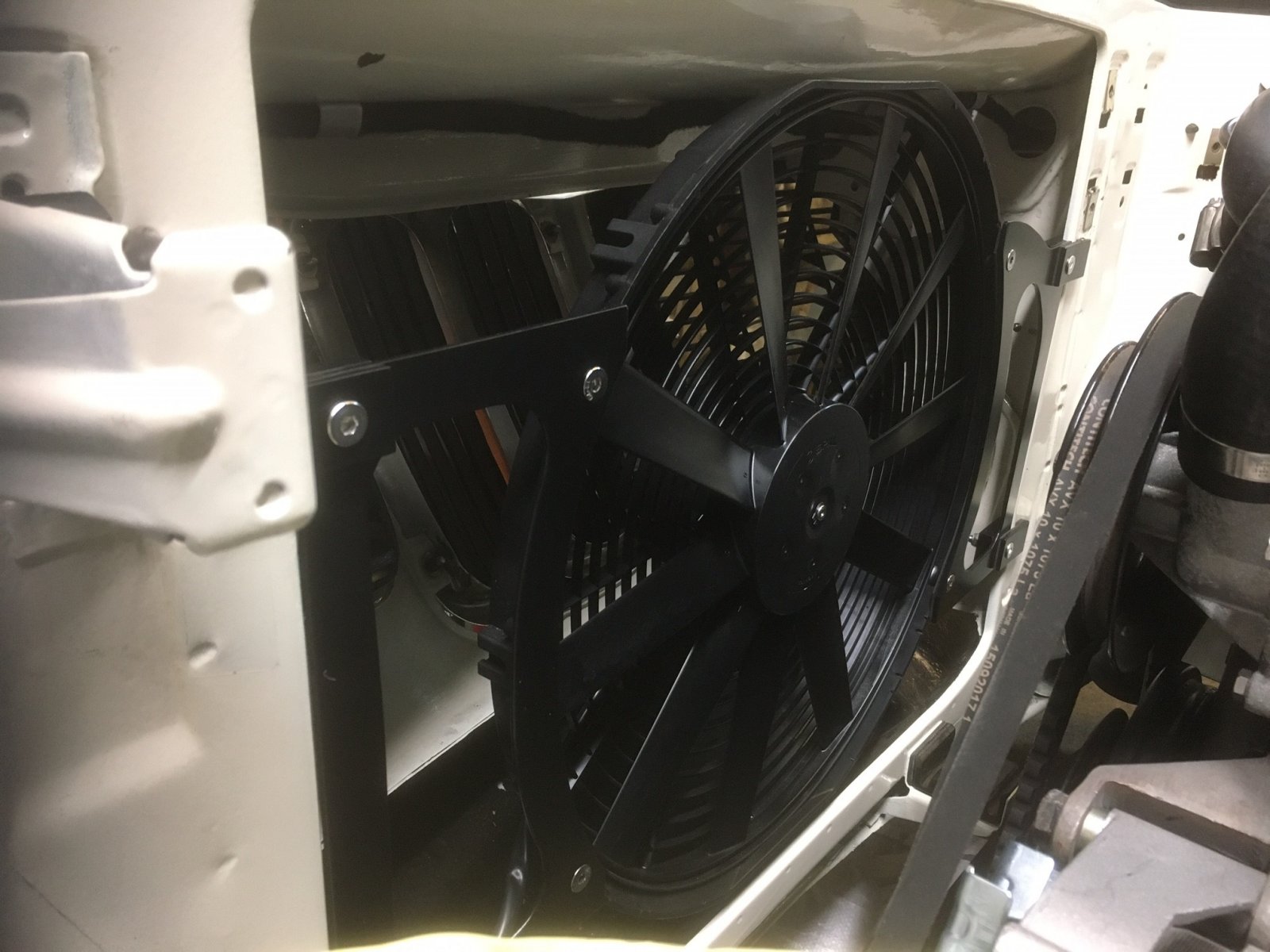

Eventually got round to installing an Electric fan. I managed to get a Spal 16” Blower fan new old stock at a bargain price off Ebay.

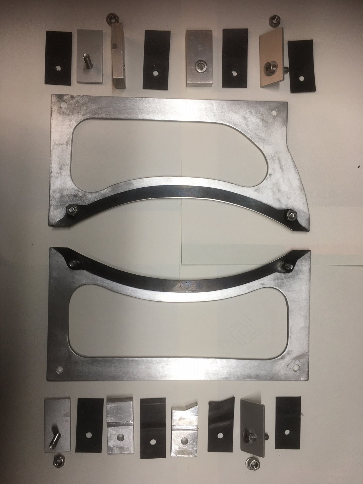

I didn’t want create any addition holes in the body work and don’t like the idea of mounting directly to the radiator, so I designed some brackets and clamps.
Bracket and clamps made from aluminium, mounted on thin rubber.
Powder Coated
