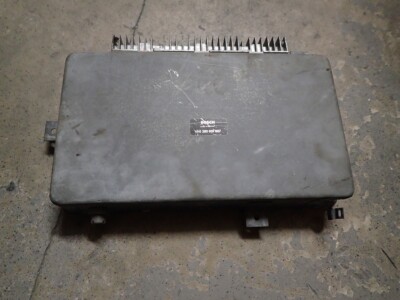

Hi everyone, I have a 1972 BMW 3.0 CSi VIN 2262612
I have an issue with the ECU it seems, do you now where I can get this repaired by someone competent.
I am based in Switzerland.

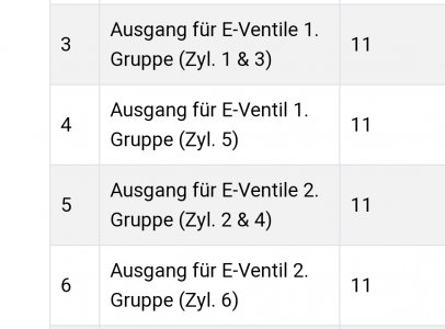

As fare as I know,
There are 3 cylinder are triggered together by the ECU ?
Check for broken wires from the ECU to injectors.
If not, maybe only a cold weld in the ECU.

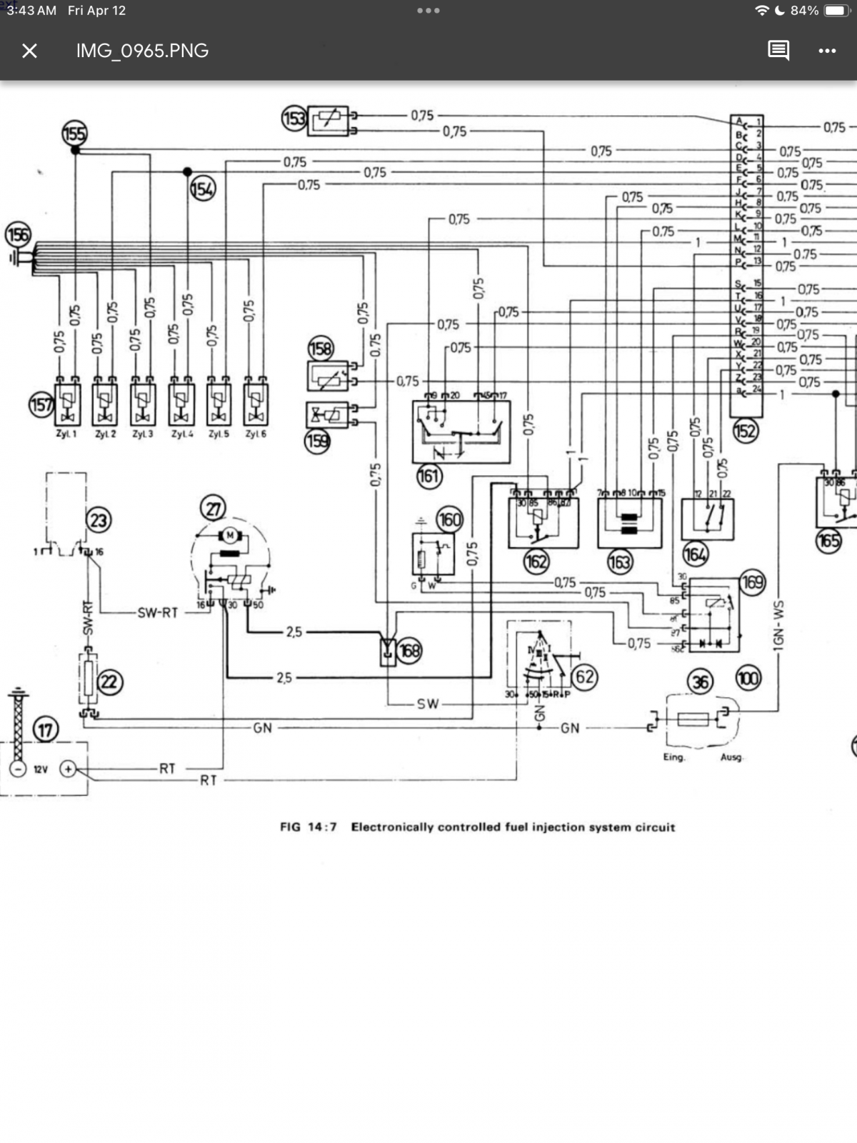

@sfdon Already post the diagram.

I think 2 drivers and 4 connectors at ecu.
Very unusual.
Firing 2 banks of 3 but using single wires to 5 and 6.

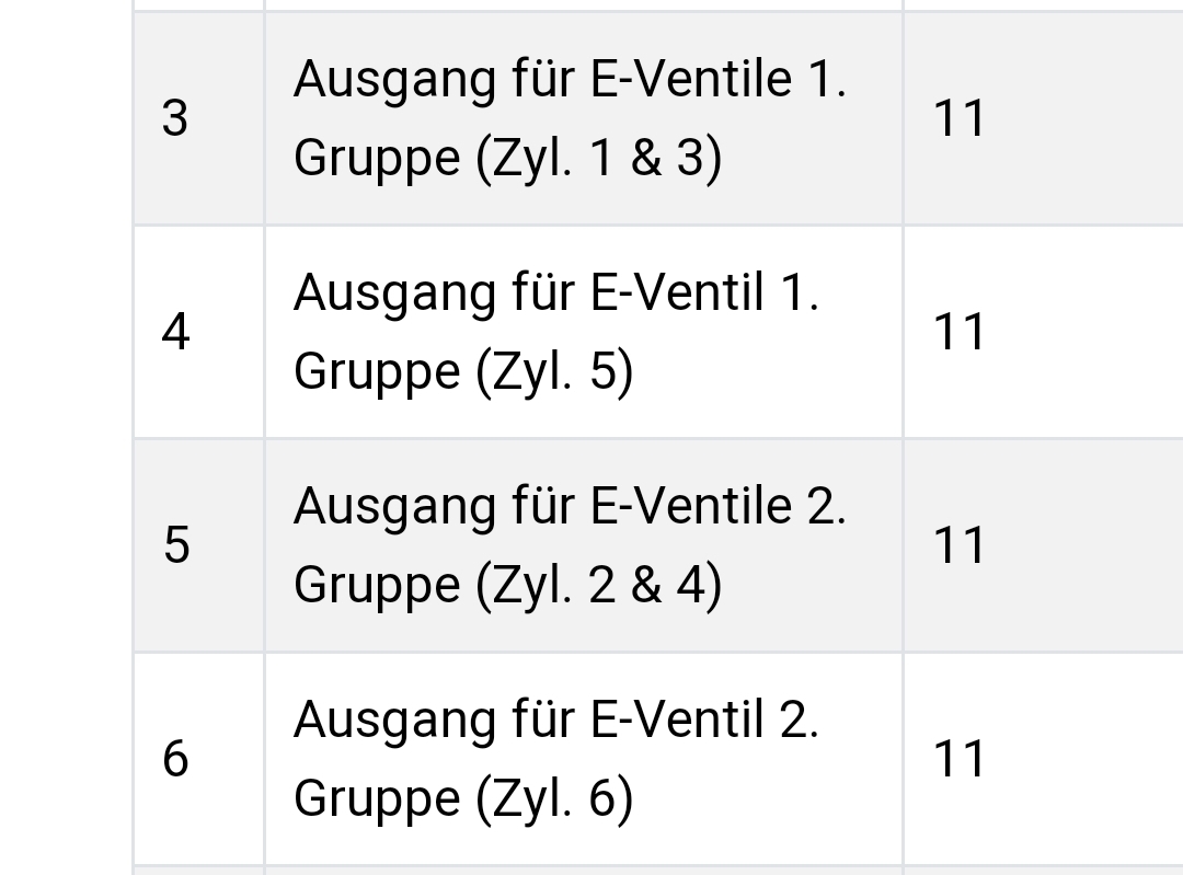

Check this side
Cylinder 1, 3, 5 and 2, 4, 6 have each a commen driver.
So if the electronic will be bad, you have 3 valves not working.
The rest is wiring outside the ECU or
a conductor path , a connector or a bad weld in the ECU.
Good luck
