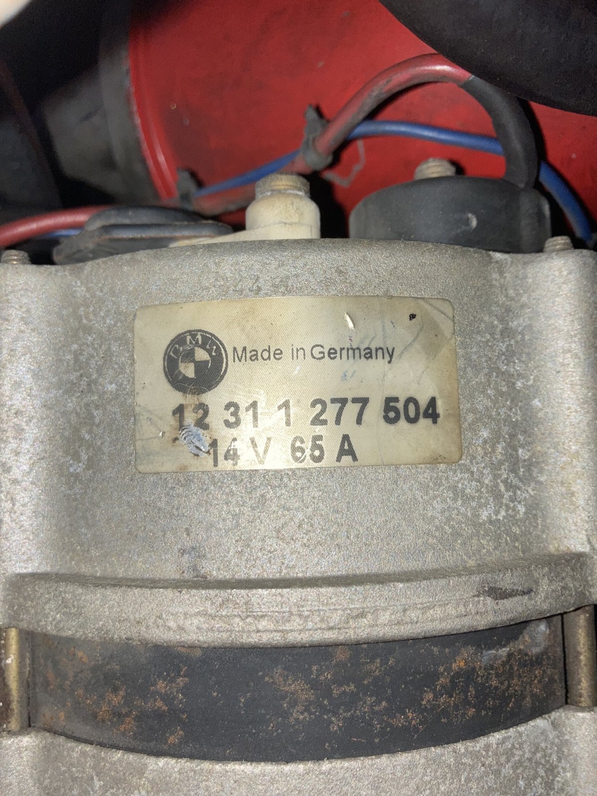

Anyone know where I can get a new alternator for my CSi? Seems cant find from usual parts companies - Might have to send it off for reconditioning I guess - anyone know if any of the ebay ones would fit?

If you are able to find a shop to rebuild it, I'd do that first. Bay is always buyer beware.
Bosch makes an internally regulated alternator, I do not have a part number.

The cheapest option would be to rebuild/refurbish. Sometimes you just sending them one and they are resending repaired other.

If its not making noise but failing to produce 13.5V+, just
replace the voltage regulator for about $40. The brushes wear out.
swapping in a new regulator is easier work than r&r'ing the alternator itself.

Yes, my experience is most "failures" are the diodes in the voltage regulator. Sometimes brushes wear out. I have never had bearings go bad.
When I needed mine rebuilt a couple of years ago, Bosch was rebuilding their alternators in a factory in China, using Chinese bushings, diodes and brushes.
I found a guy about an hour away who rebuilt mine with Japanese parts.

I agree. Diodes most often the problem.

The "diodes" and the voltage regulator are two separate components in the alternator. Some replies are implying that the "diodes" going bad are in the voltage regulator. There are no diodes in the regulator but it is the regulator that most often causes problems and is a 5-15 minute job to replace so it's worth doing first if no precise diagnosis is being conducted.
The rectifying diodes can also go bad but less commonly than the regulator (and brushes in the regulator, if built-in) and it requires more know how and disassembly of the alternator to replace.

The place I use is actually a " Starter motor rebuild shop " , they also do alternators.
I'm assuming you mean Rite-Way in the city. They are pretty amazing. Seen stuff like 250 GTO and Bugatti Type 35 generators and starters sitting on the shelve waiting for pickup in the weeks before Pebble
