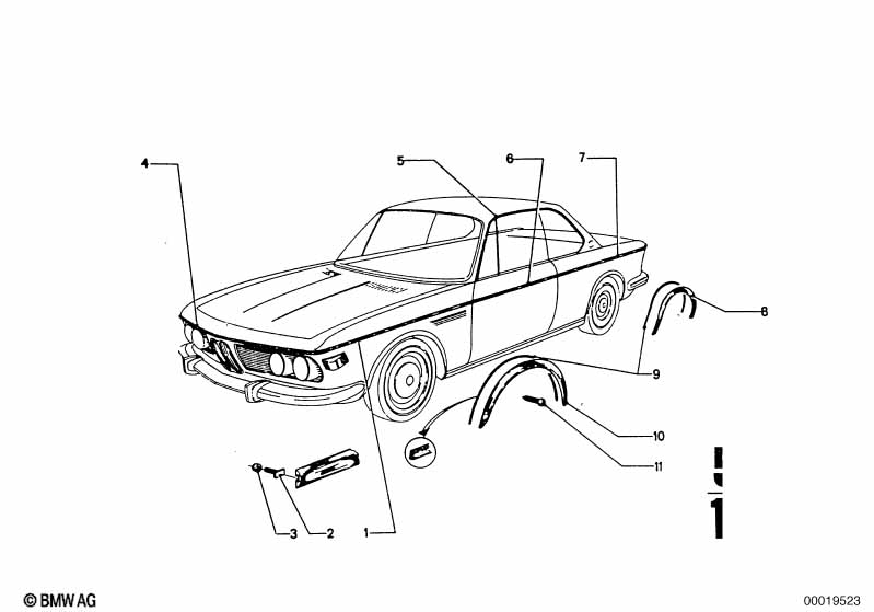

In dismantling my car for paint, I pulled the drip edge molding as shown. Why it is shot I am not sure since it was not removed when the PO had the car painted from Taiga to red (he is serving 5 for this BTW). I am unclear on RealOem what the part number is or if NLA. Also not clear what the part number on the gasket shown, is. Any help appreciated

Yes. I see the weatherstrip is in two parts but sold as one and I am on that.
The aluminum part is what I am looking for. There are two parts, the wider one that runs along the drip edge is the one I want. It has to be removed first before the inner /narrow one that holds the headliner in place, can be removed. Each side has a front and back portion. I show the front passenger side in the image in my original post (it is what you see after you pull the weatherstrip). Tx

No.DescriptionSupp.Qty From Up To Part NumberPriceNotes
01Moulding front left151131810541$101.63
01Moulding front right151131810542$101.63
02Screw4551135780108$1.16
03NutM 44511/197551135780115$1.41
03Hex nutM4-A2-704507119922854
04Decorative strip151131810538$139.00
05Moulding left151131813025$55.06
05Moulding right151131813026$55.06
06Decorative strip for door, front, left151131810543$148.01
06Decorative strip for door, front, right151131810544$148.01
07Left rear moulding151131810545$220.23
07Right rear moulding151131810546$220.23
08Covering rear left109/197211/197551131819607$415.42+core
08Covering rear right109/197211/197551131819608$415.42+core
09Synthetic stripX09/197211/197554129734126$1.95
10Cover109/197211/197551131819605$397.36ENDED, +core
10Covering front right109/197211/197551131819606$453.89+core
11Fillister head self-tapping screwST2,9X9,54209/197211/197507119907707$0.09
Notes
Moldings
number 5
