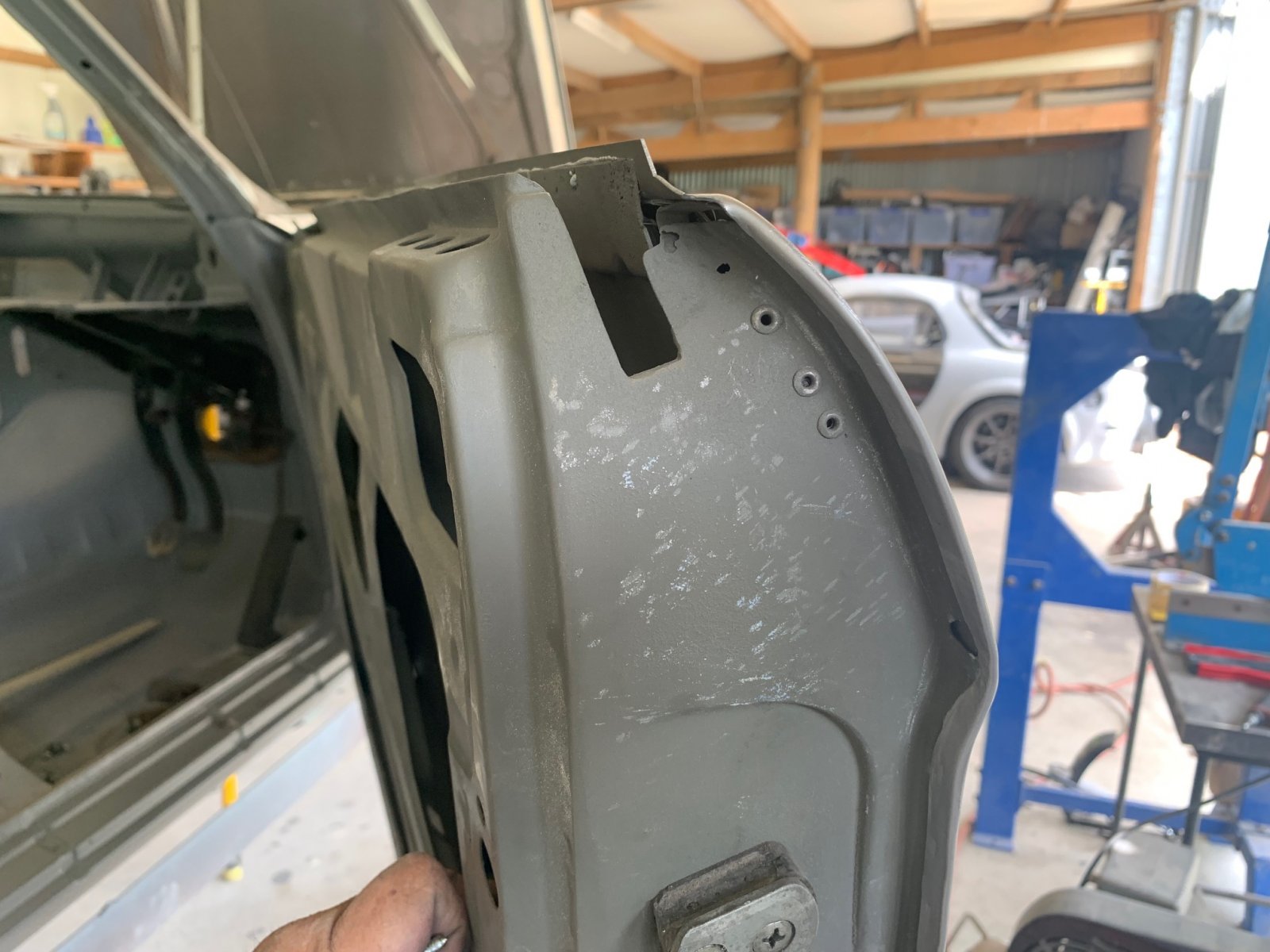

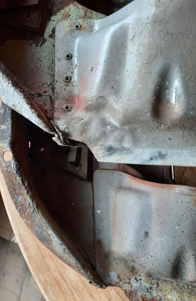

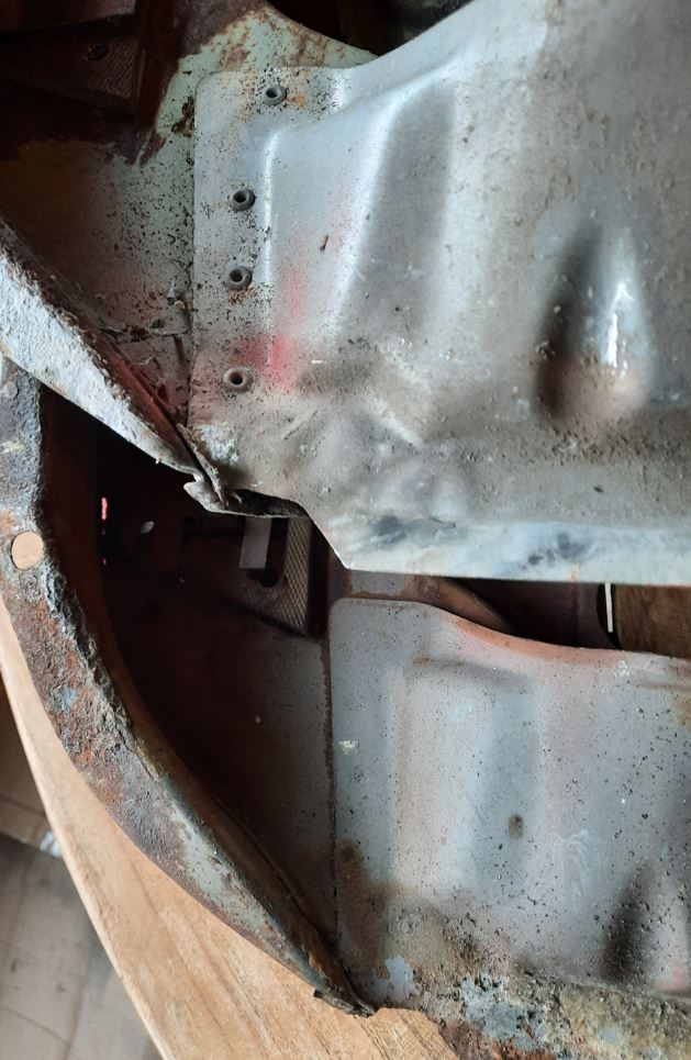

Hi everyone, are the rivets in this photo factory original for a CSL please? I've found photos of other cars that don't have them, but they could be CSIs, which have a steel inner brace.

Looks correct to me. I thought there were only three so I’m not sure about that upper hole. Could just be that I don’t regularly see a stripped door. Also just looks like a rust hole. Verify with @CSL177 since he has a NOS CSL door.

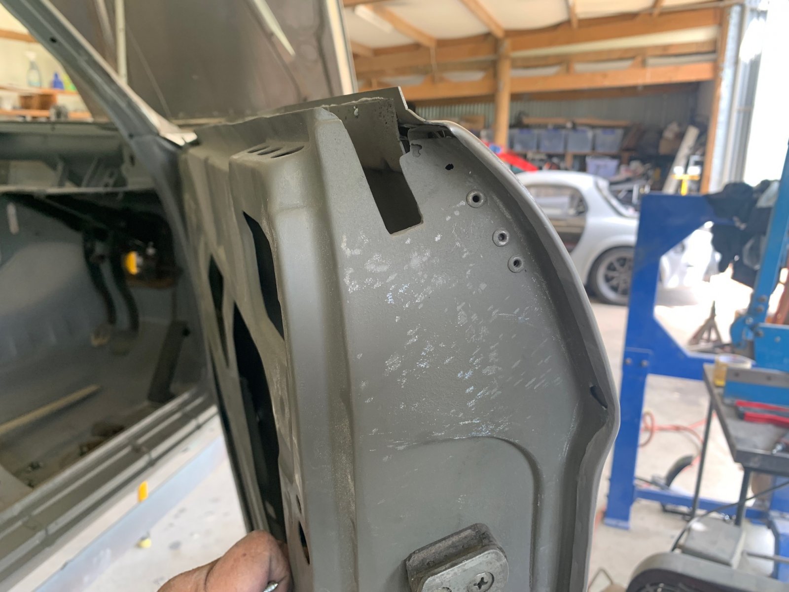

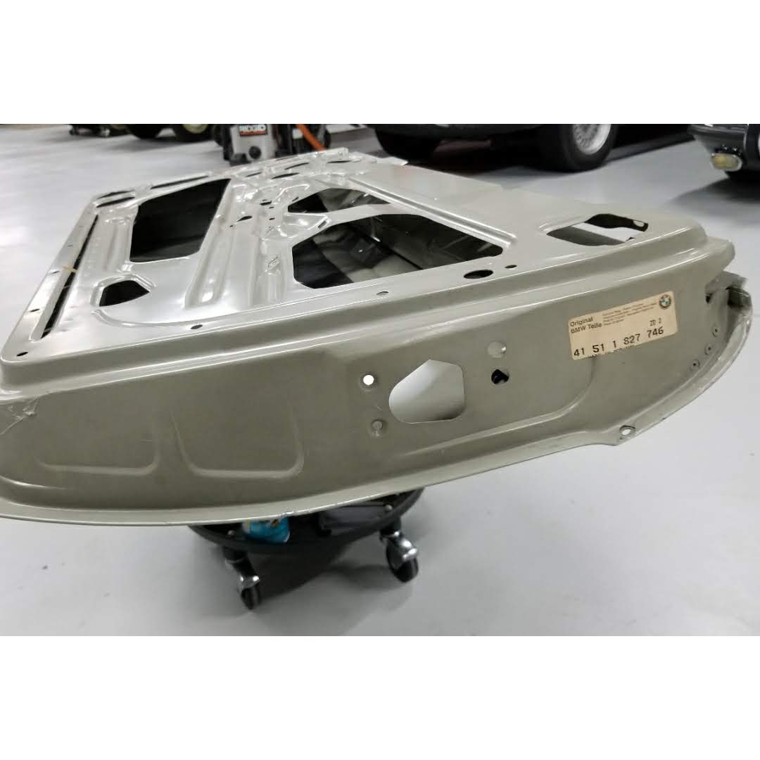

That IS a rust hole. Yes, i looked at a bunch of pics of csl doors. Those 3 rivets are indicative of the aluminum csl door brace. Here's a picture of @CSL177 door (that's currently for sale). If you look below and right of the part number sticker, you'll see those three larger rivets...

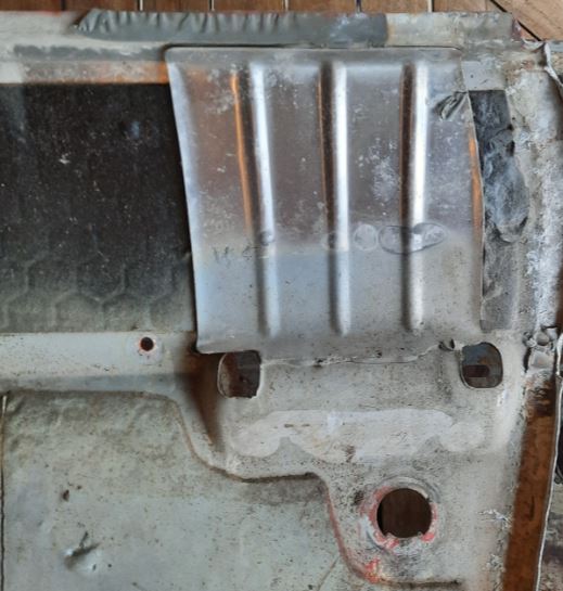

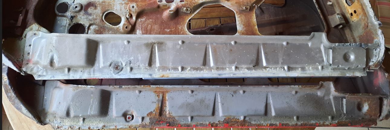

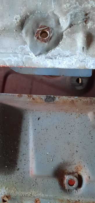

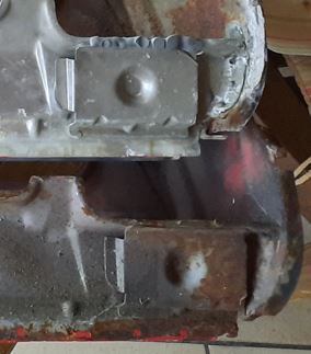

Hi everyone,

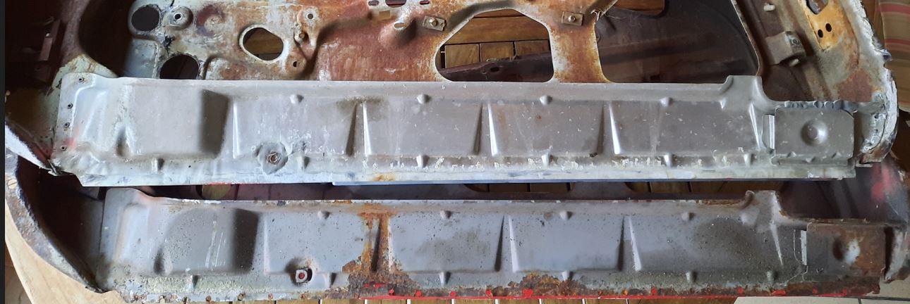

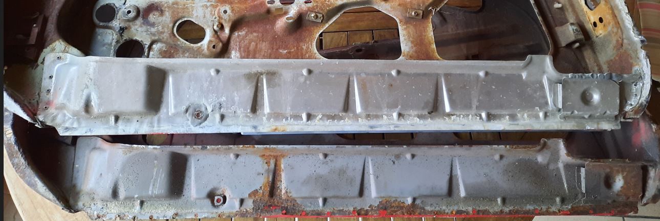

since I am just stripping my CSL doors I can show you how they look from inside and how the Aluminium parts are fixed to the steel frame by rivets and glue:Door frames standard vs Alu.JPGDoor frames Alu detail 1.JPGDoor frames Alu detail 2.JPGDoor frames Alu detail 3.JPGAlu at lock.JPG
The upper part belongs to the aluminium door, the lower part to the standard steel door
Regards
Thomas

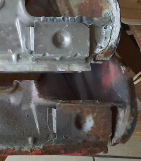

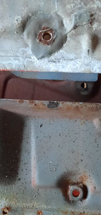

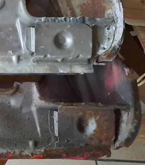

Very interesting and important for CSL restorers...

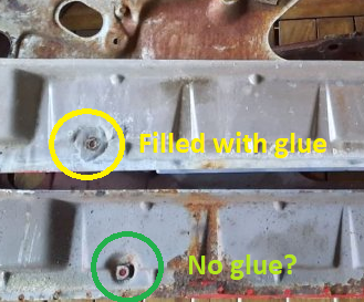

Do you think this is original or that's a kind of repair (gluing)?
Krzysztof
1,679
809
Poland

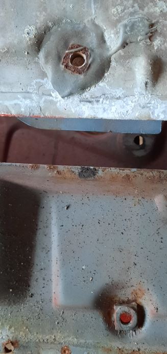

My question is coming from simple comparison between to sides.
It is more clear here:
One nut is glued but another one is not (at least not the same way).

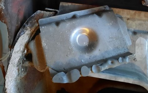

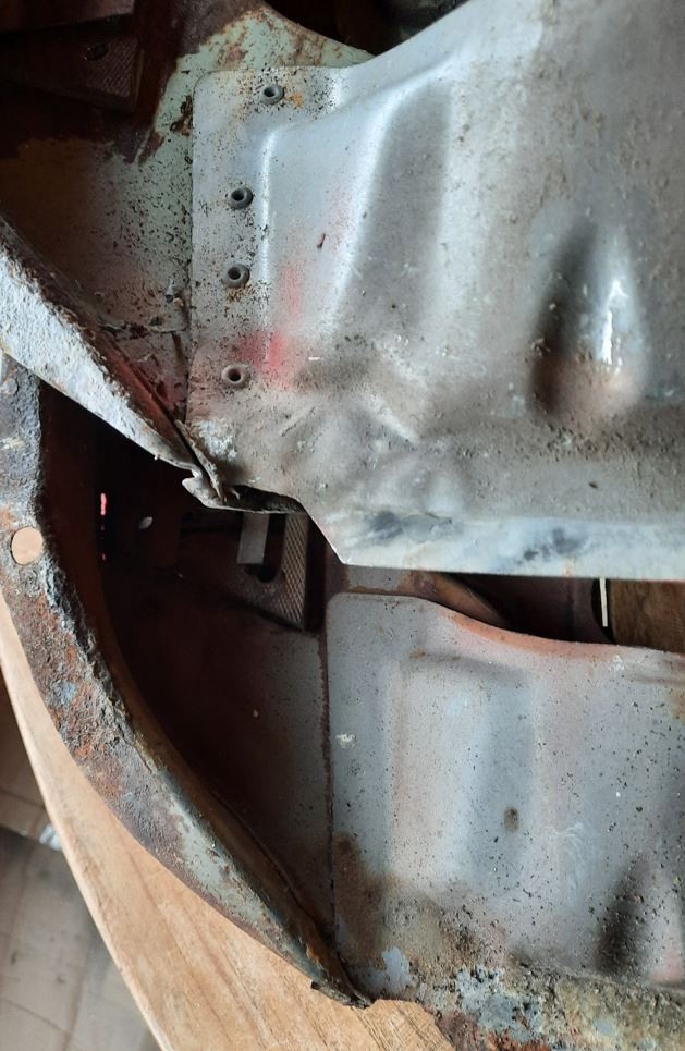

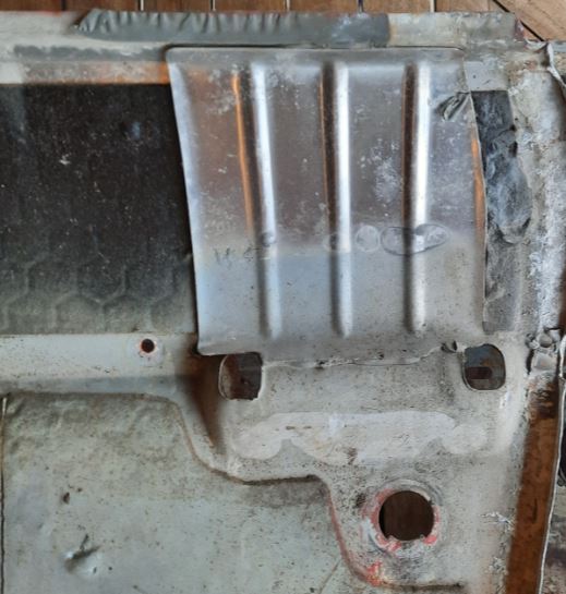

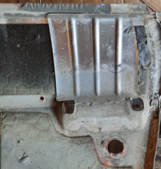

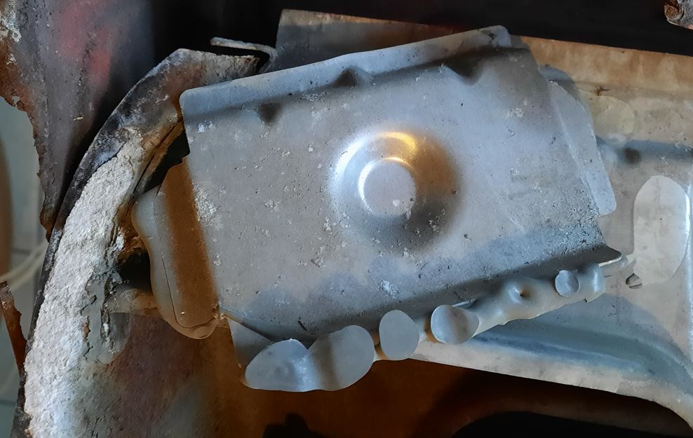

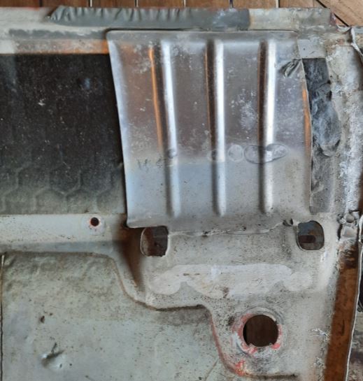

As tferrer said: on the steel body all parts are welded, on the aluminum they are fixed by glue or by rivets.
Not only the nut but also these parts. Alu at lock.JPGAlu at lock on frame.JPG
On the left picture you see a strip of glue still attached to the upper part of the shell. This is to make sure that steel and aluminum do not get in contact. Shell and steel frame at this position are fixed together by clamps.
Note the white powder aluminum corrosion on the right picture

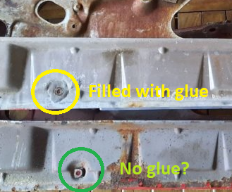

I think none of you've noticed what I'm about so let me show in color.
Both parts are the same but other sides. One is filled with a glue, silicone or resin while the other is not (or maybe there is much less glue like filler). :)
Perhaps the nut came loose because of the reduced amount of factory glue and the repairman said, I'll fix that!
Krzysztof
1,679
809
Poland
Is the square nut originally tackled steel or aluminum (can be check by magnet)?
If it would be aluminum it could be tack welded to the panel by e.g gas torch.
Just loudly thinking. :)
TomHom
366
318
Germany
Steel nut on both doors!
But one door CSL aluminum but the other one standard steel !
