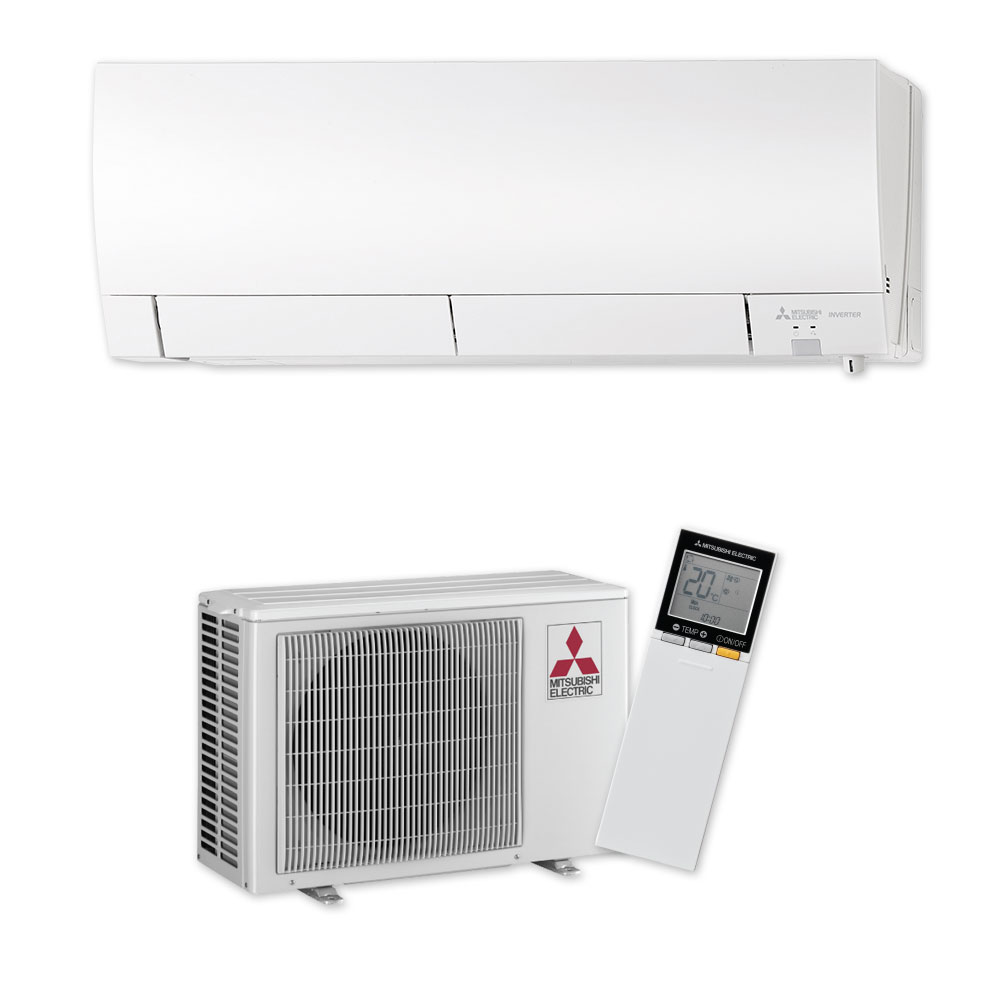

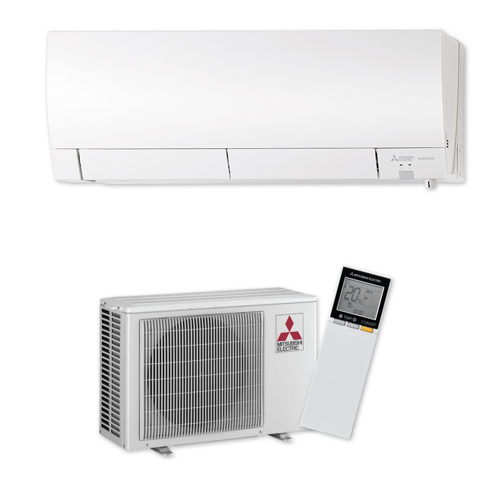

I have a Mitsubushi FH25VE-E1 in my garage, which can handle -25C° and still give heat, and it's doing a great job of de-humidifying the garage while it's humid outside. Not the cheapest but it's a very nice machine that I can recommend to anyone.

I'm jealous, and I also want this for my next garage/shop. I looked at mini-splits during round 25 of never-ending old home renovations, and they're just all-around smarter options. Also saw some good sales & discounts in the off-season. But I only had one available wall, and I couldn't stomach more work to navigate around obstacles. So I stuck with my stand-alone de-humidifier, which runs nearly non-stop during summer and makes me feel like an eco-criminal. I have a near-constant stream of drain water from May to September. But I have to heat up the garage in our relatively mild winter to get it to work. I'm confident I'll spend more on increased utility bills over the life of a mini-split unit than the difference in the price.
