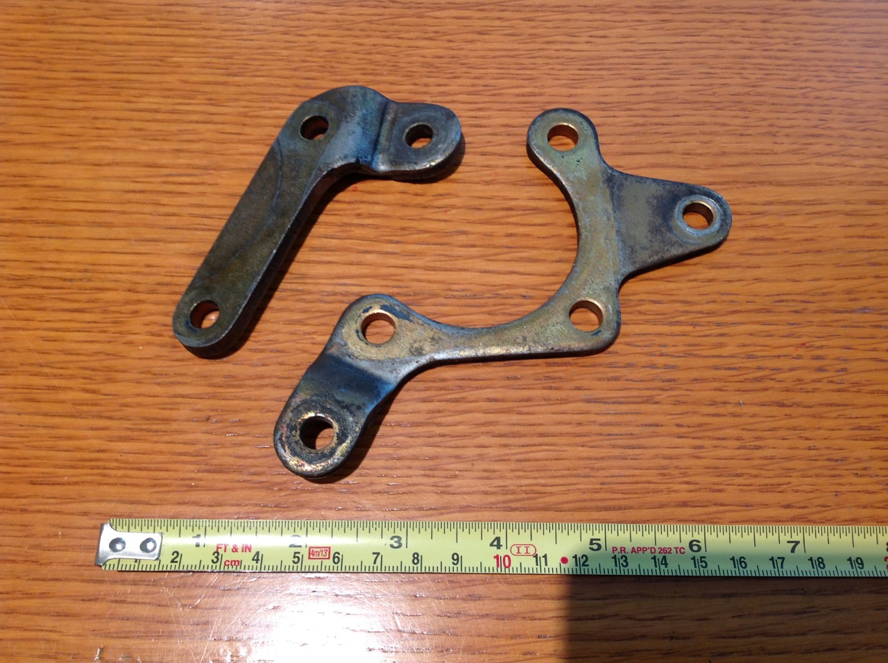

You'll need the other little offset bracket as well to mount to the rear of the PS pump. This set up makes adjustment easy and it holds the belt tension better than the original CS bracket (which always seemed to twist the alternator when snugged up).

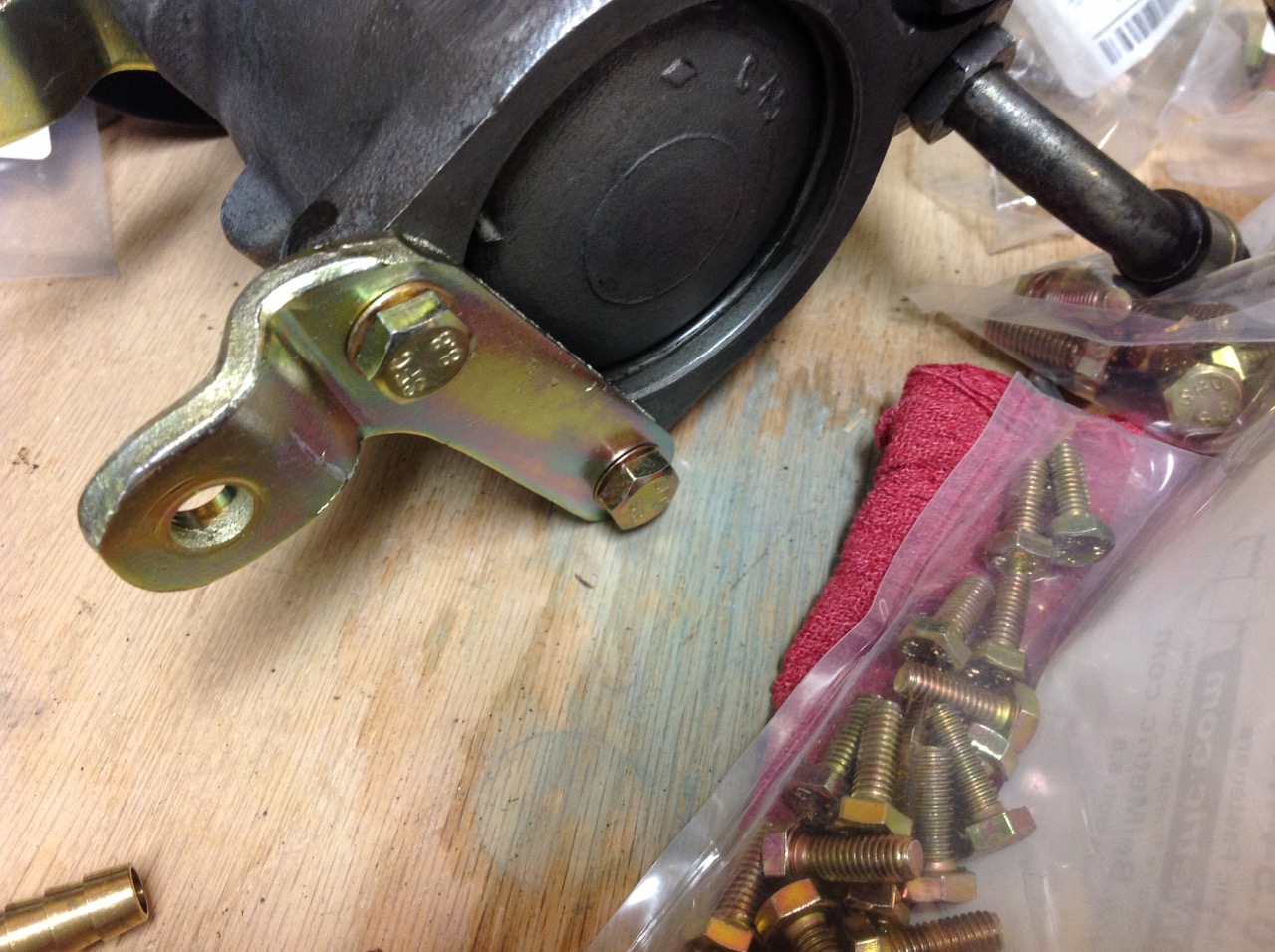

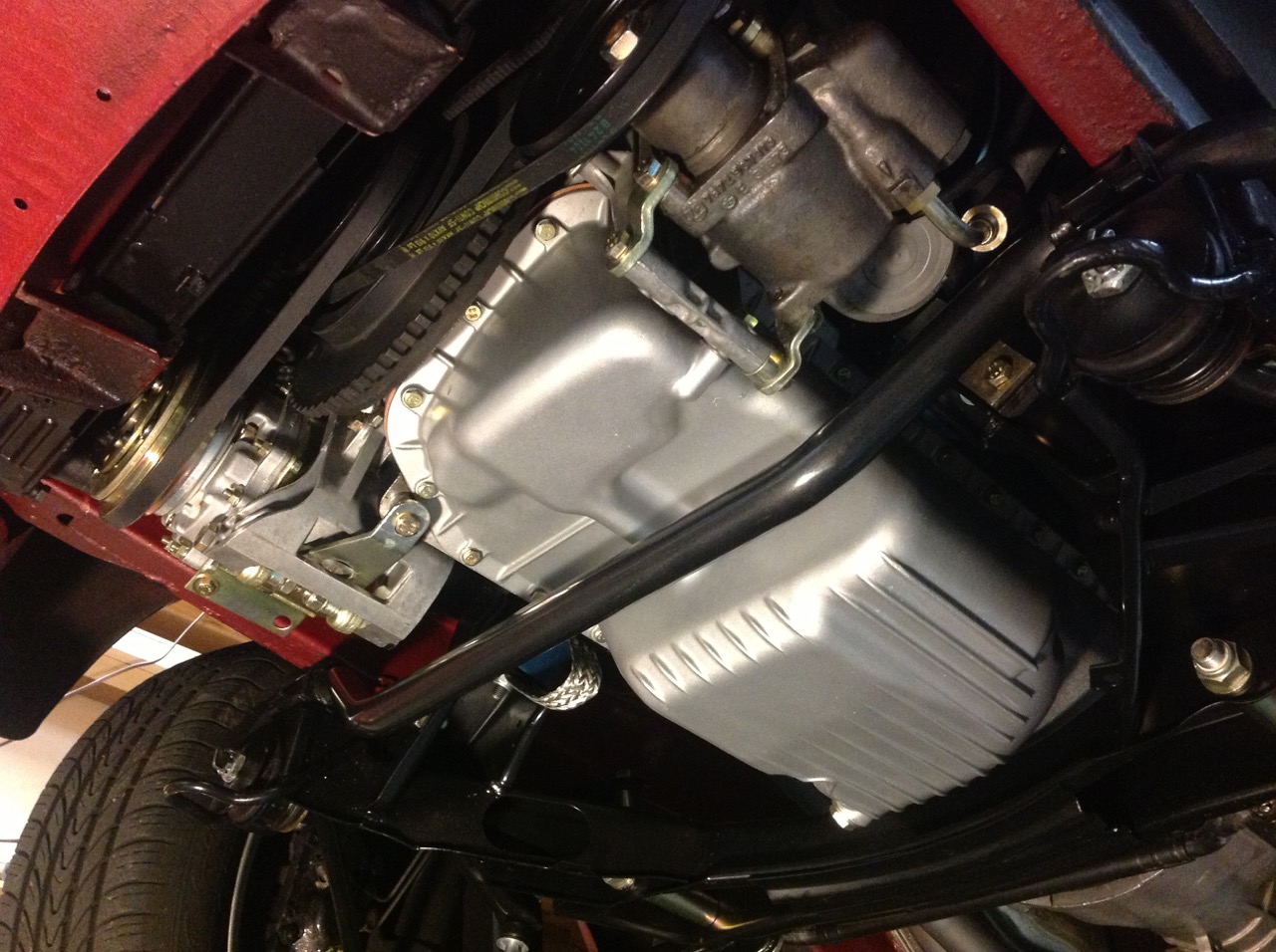

View attachment 44529View attachment 44529 View attachment 44530 View attachment 44531
Thanks a lot. Which PS pump is in the picture, original CS or a later style?

that all looks like the later B35?
Interesting AC bracketry too. Is that a Sanden? If so, those brackets are interesting for sure.
