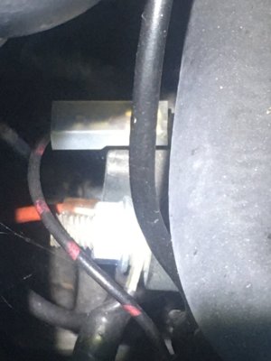

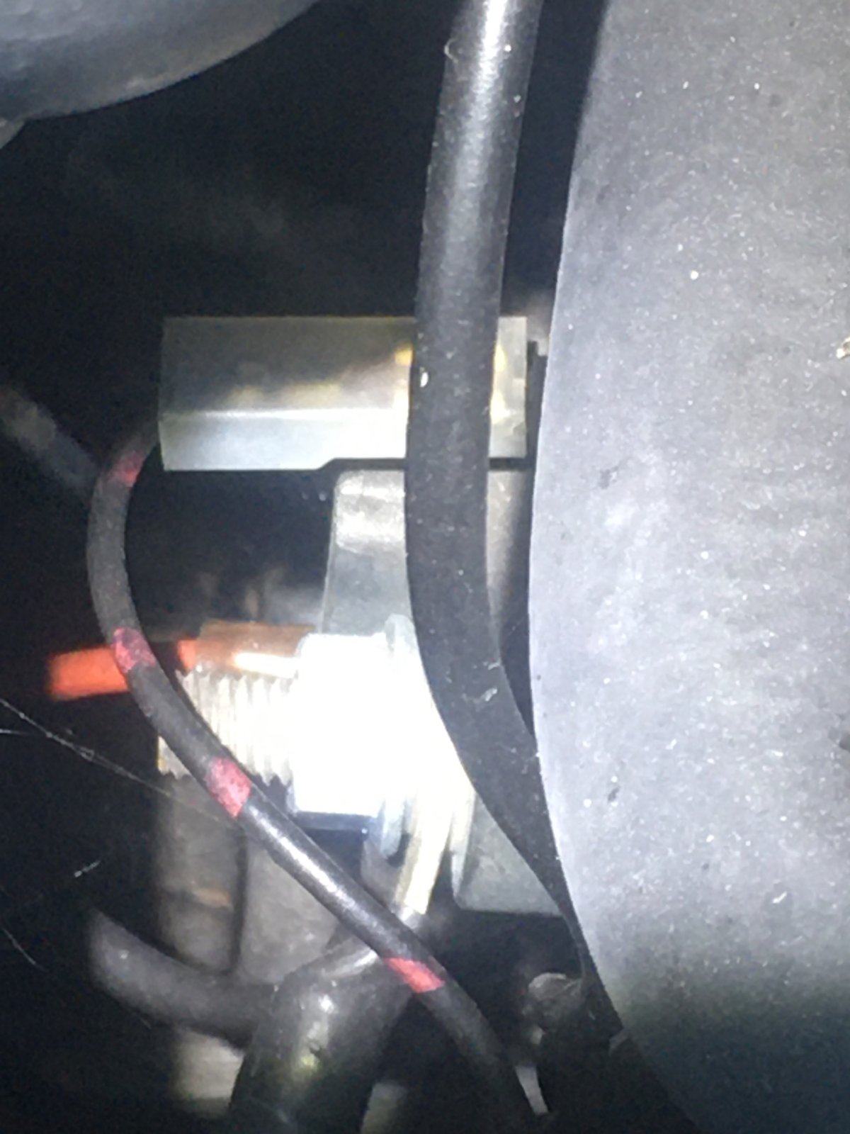

There is a red wire coming from the battery that goes to the ignition switch
There is a another red wire at the 6:00 position on your starter. (Only on the djet engines!)
Thats all you need to know. That red wire at 6:00 position cranks your engine when you turn the key.
Forget about the ecu, forget about the relay.
Remove the red wire from its spade connector at the starter at 6:00.
Crimp a female spade connector onto a 2 meter long wire and connect it at the 6:00 position.
Strip a bit of insulation from the other end.
Tap it briefly onto the positive terminal of your battery.
The key does not need to be in the On or Run position. Leave the key out.
IF!! Your engine still doesn’t crank- Check ALL your ground and positive connectors to the battery and the engine/chassis AND remove all spark plugs and try again.
Please make sure your tranny is in neutral and parking brake on!

Thanks for that. I'll dust off the voltmeter and check for grounds then go under the dash. We're in a mega lockdown in Melbourne, so I can't say I don't have the time :)
sfdon
8,300
4,657
sfbay area
Ummmm- no dash. No voltmeter. No checking for grounds (yet)
just a 2 meter piece of wire, a spade connector and a charged up battery.
