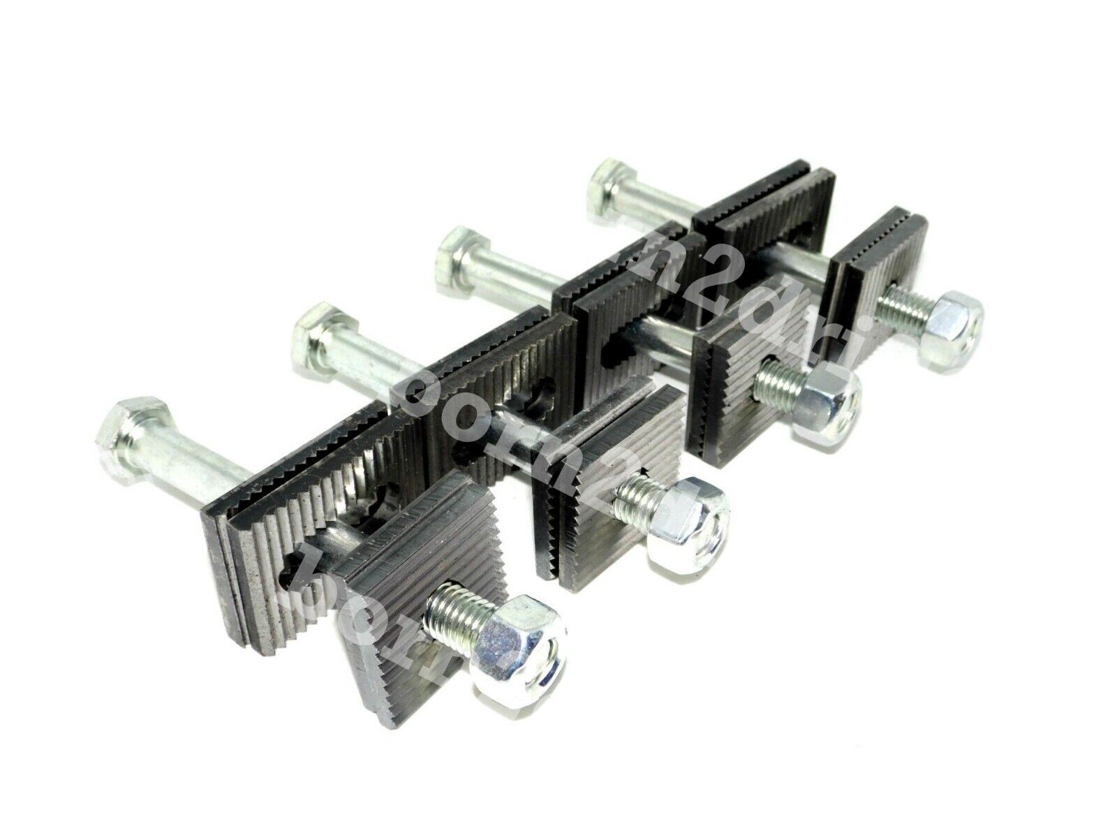

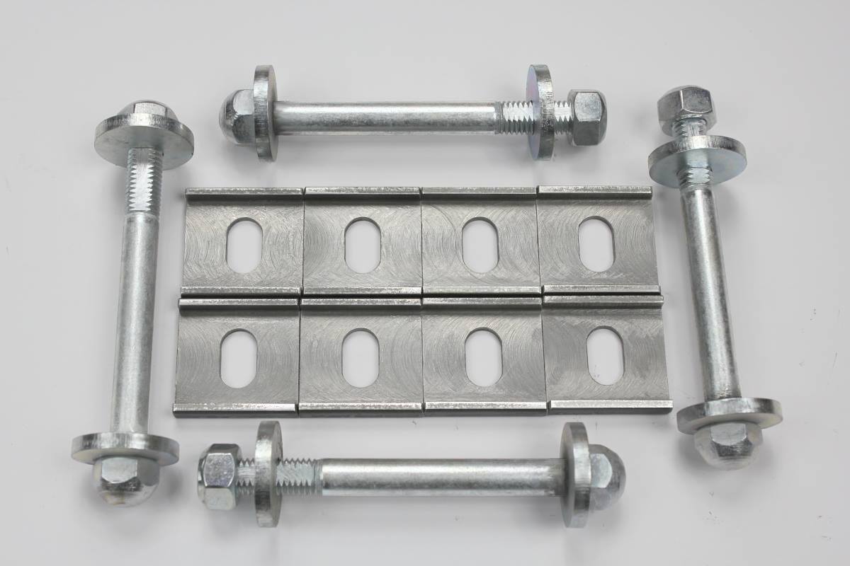

I'm planning to install Camber and Caster plates on the rear axle.
There seems to be two variants as pictured below, any experience/preference of which is best would be appreciated.

I have a lot of difficulty with the version on the right getting them to hold position. The through bolts and grooves are not robust enough to deal with the forces involved.
