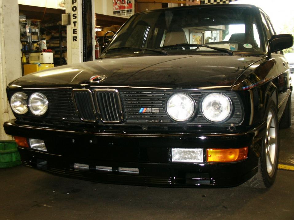

Walter- I sold three Ferrari's for my client last week. He still has a e28 Dinan stroker for sale in incredible condition. After I tune it it will be available.
