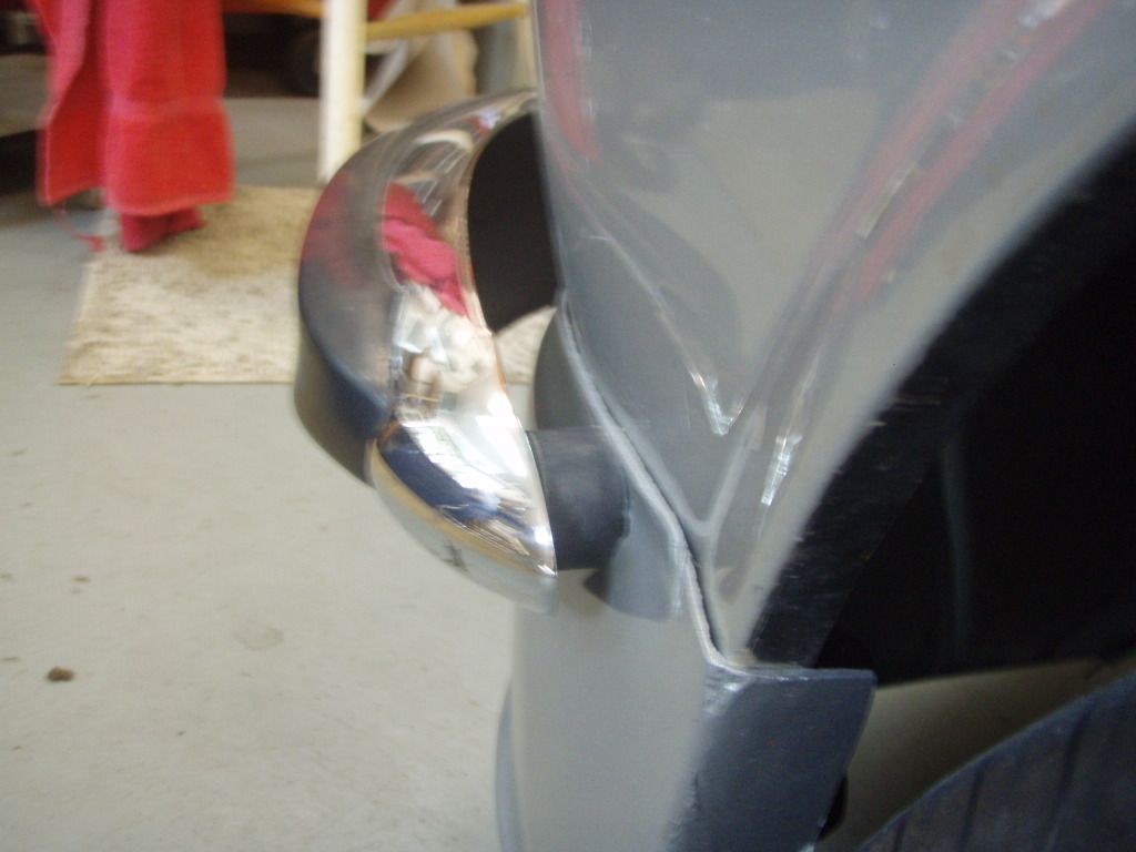

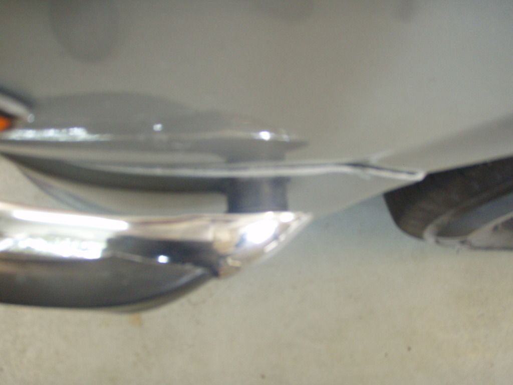

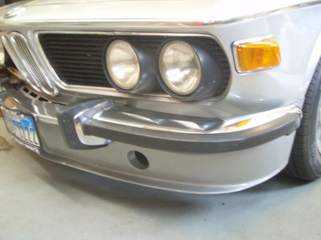

Yep, I have the same color (colour :grin: ?) and I put the bumper back on. Not sure if the "protection" aspect is true but I think it looks better with the bumper.
Note you need to find some sort of rubber spacer to act as a stand off at the end. These are some sort of Chevy engine mounts
Getting the slots correct can be a bit of a challenge. I used a lot of tape and a helper to get it set correctly then marked the spots with a grease pen. Still ended up longer than necessary.
