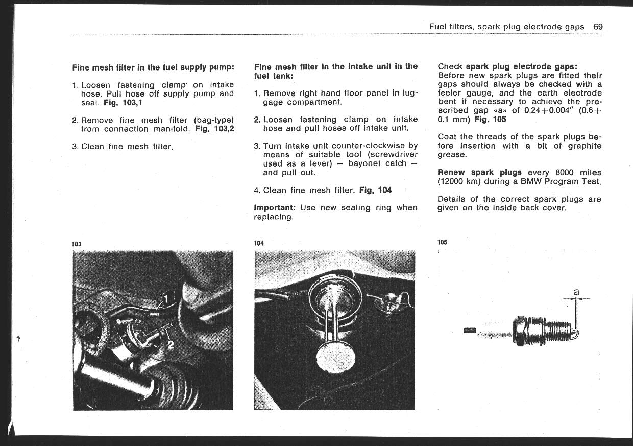

I also have a set of blue books......and they are a bible, but products have moved on as well and they are now relying on loctite to help solve the overlooked spray bar bolt problem that got past the finest minds of 1972.

some comments:
first- please do not use anti-seize compound while inserting the plugs, it is specifically enforced in the blue manuals NOT to use anything there.
my tip, before installing new plugs, i clean the thread (in the head) with a tool for cleaning the gun tubes (you know that long thing with a lot of small flocks at the end), i dip it in gasoline (only a bit) and introduce it in the hole while turning in both directions, i have discover that this is the way of being able to then introduce the new plugs smoothly by hand with a special tool from BERU, basically a rubber hose that holds the sparkplug and allows you a better angle to install
DQ, as always, your advice is sound. Cleaning/chasing threads is always a wise practice. So is using a torque wrench - especially on aluminum threads. That being said, the use (or non-use) of anti-seize remains unsettled and will likely remain so.
In most instances, plug manufacturers recommend avoiding the use of anti-seize. See collection of manufacturer quotes: http://www.garagejournal.com/forum/showthread.php?p=1376508#post1376508
Suffice it to say, spark plugs having a tendency toward developing surface rust might be good candidates for anti-seize. This includes spark plugs with a black finish (e.g., older style Autolite and AC Delco). Silver (nickel or zinc) plated plugs, e.g., Bosch, NGK and Nippon Denso are not typical rust'ers. !! >(ever see plugs coming apart at the threads?)> http://www.ngksparkplugs.com/pdf/tb-0630111antisieze.pdf
BMW's owner's manual adds to the confusion. It specifically recommends "coat[ing] the threads of the spark plugs before insertion with a bit of graphite grease." (See below.) It is a guess that when the manual was written the authors erred on the side of caution respecting both the average owner-mechanics' aptitude and knowledge, and the wide range of available replacement spark plugs - including those without nickel or zinc plating.
