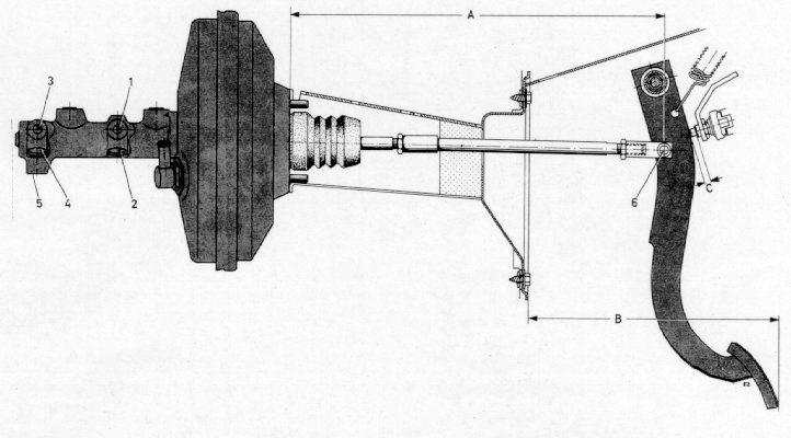

Looking at the booster diagram, it appears that there is no way to adjust the resting position of the rod against the master cylinder. There is a slight amount of slack between my brake pedal and the rod engagement so how else would the booster be putting pressure on the master? Or is there in fact a way to adjust this? I'd hate to pull this crap off and have nothing to work with. Perhaps it's an internal issue in the booster where it's not releasing back to equilibrium once the pressure is let off the pedal? Maybe the master cylinder is sticking?

Hi Steve
if you have the factory manual, have a look at section 34 31 000 Master cyl removing and installing You need to have .5mm between pushrod in booster and sleeve in M/C at the bottom of the page it describes how to check / achieve this There is a nub at the end of the pushrod that is threaded and can be adjusted to get the right clearance Page 34-31/1

Hi Steve
Thanks, Rick
Will do, thanks much
