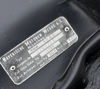

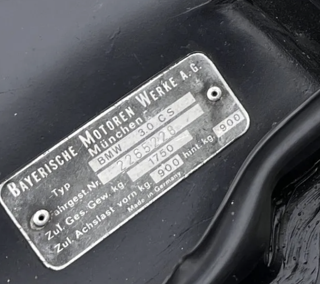

Sinister. Almost look like B&W photos. Are the lenses tinted, or the hue is just dialed down on the photos?
And a CS with CSi badging? I look forward to the BaT commentary on that discrepancy.

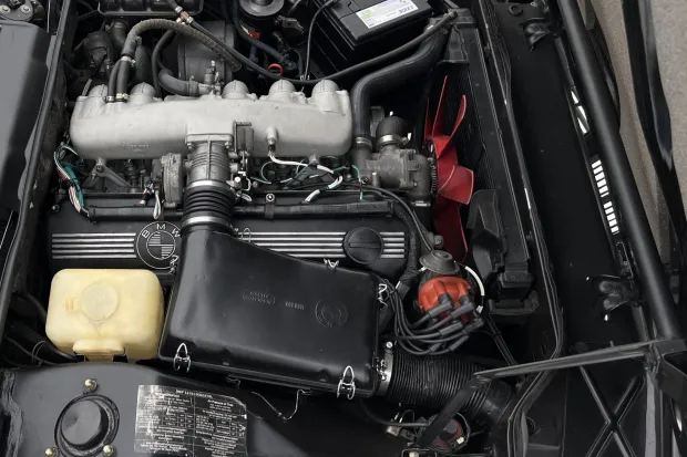

This car is 10 minutes from me and I have a friend who's pretty interested. Is this car as much of a cobbled together pig as it seems? The barren trunk, the misaligned body panels, no front bumper, inop stuff all over and blacked out everything? It seems almost tasteful in the pics so on the one hand it could end up being a deal if bought at a reasonable price, if someone wants to put the effort in post purchase. On the other, is it even savable or is this a mountain of work to end up with a tarted up disaster of a car? The original engine is seemingly gone, the 4sp is a waste, and the engine, well. No words really, and all the little stuff isn't helping.
Edit: and when I say savable, I mean to turn into something halfway respectable. It's already a color change with the wrong engine so it's never going to be more than a decent driver.

Is that an old York A/C compressor w/o a belt on the pulley? Where's the evaporator,etc. in the center console? Saying the A/C is non-functional seems like an understatement.

Not trying to pile on , Not sure its a B35 , the distributor as mentioned ( can be retrofited with Cam and upper timing cover change) but also has very early style Oil filter housing ( also not hard to retrofit)

Yes, I modified a dizzy by staking it. Motronic needs a temp sensor and doesn’t use vacuum advance. @teahead

Rotary compressor
