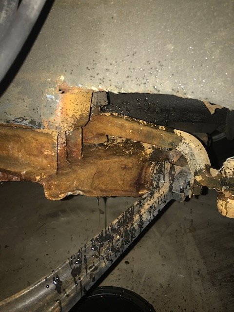

As I am sure most of you know from my posts that there is some rust on my car (underneath and on the body) and I am trying to figure out a way to deal with it. Now would it be better to get an angle grinder and just grid out the rust form all these surfaces? Or do I need tool that would cut straight through the metal? Or should I look for a good sand/media blaster? And if so, where can I find an affordable blaster or angle grinder (-: (I'm checking craigslist as we speak too). Thanks guys!

Before you venture into all this you have to plan the whole shebang so
1) I bought a 4inch angle grinder from Home Depot years ago , Makita I think. Have beat it to death and works great still. Not expensive either. Smaller= get it into tighter spaces
2) Source for sheet metal?
3) MIG welder.........read tons flux vs gas, Lincoln vs Miller, 120 vs 220amps. How to weld videos etc
WRT sandblasting. I have limited experience but to do yourself, OMG what a mess. I use it in spaces I cannot get the angle grinder into. Mask off everything, the media goes everywhere. You need a compressor and not some small Harbor Freight thing. Then read about diff media.
Basically trying to convey this road you want to go on is long, somewhat costly and has a huge learning curve.
BTW: expect an ER visit or two. Very few benefits left being a doc these days but being my own ER is priceless.

honestly, for just starting out, go to harbor freight and buy yourself a $7 angle grinder, a cup shaped wire brush, and a stack of cutoff wheels and flap disks. (about $20 for everything) ask at the cashier if they have a coupon, they always do.
by the time I burn out the carbon brushes on my HF grinder, I just throw it away and buy another. lol
the carbon brushes are replaceable but for $7, they are also disposable

That's a pretty good price! I think I'll try that :D

You got everything right except he needs to buy three grinders. One with a cutoff wheel, one with a grinder, and one with a flap disk. Don't waste time changing the disks.
