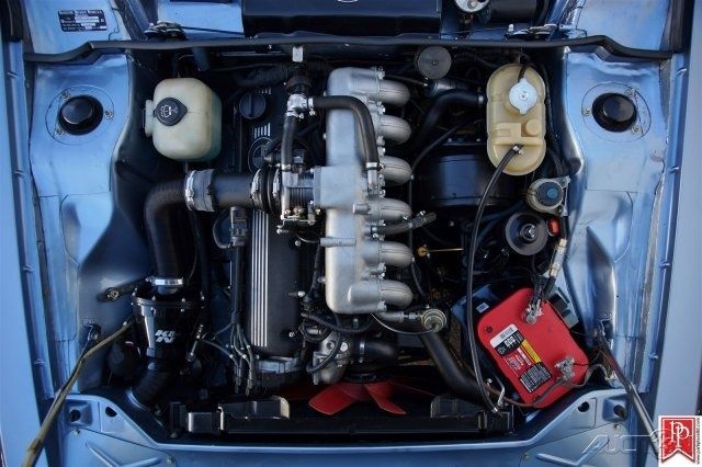

Hello all -
I am putting a b34 into my Bavaria and will be running it EFI via the motronic box that came with the motor, harness, and intake. I would like to use the pyramid intake instead of making the older style log intake work.
Does anyone know if that intake will clear the brake booster? I know that it doesn't work in an e9 so people do the log intake or tii booster but wasn't sure about in an e3.

You must mean the banana intake akin to the old CSi D-jet system (only instead, newer ones are L-jet)?
No problem clearing brake booster:

Yeah the banana one is the solution that I know for certain clears. But compared to the later intake on b34's and b35's, the banana intake robs a good bit of power. But before I spend the dough to get a tii brake booster I want to get clear if I even need one.
I could be wrong but the booster in the photo looks like the smaller diameter tii brake booster. So, sure, it should clear with that booster.
