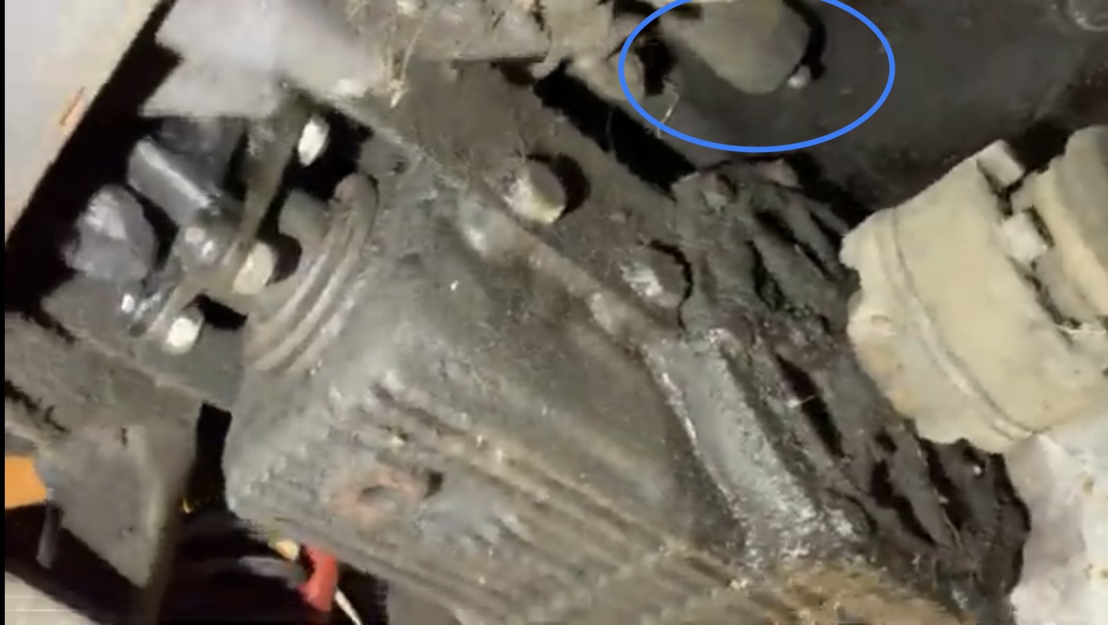

Looks decent, but w/a little bubbling on the rear quarter lip, wonder what the underside looks like.
CSteve
3,817
1,303
Bucks County, PA
Here is their website: https://www.vacmotorsports.com/
Chris, I thought that it was ??? until I looked at the website. Lots of local experts within 50 miles of this shop who could motor over for a look see and PPI. A euro coupe, sunroof, etc that needs to be up on a lift to tell the tale.

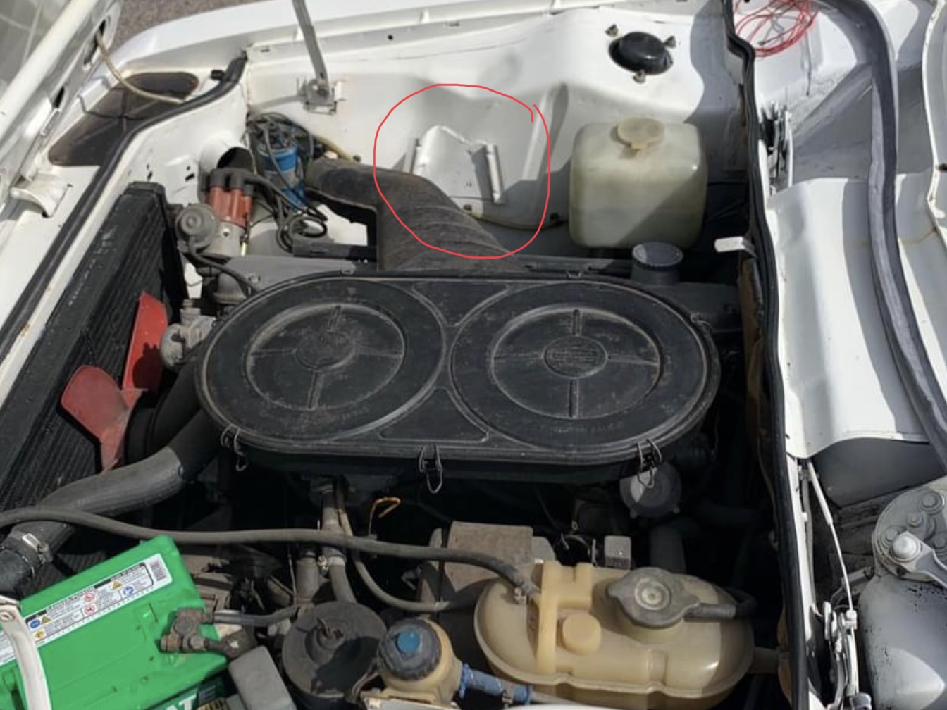

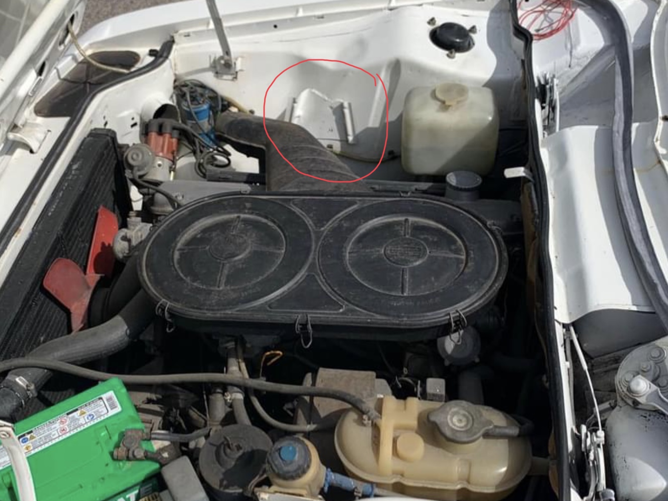

Looks promising. No VIN listed (VIN plate MIA) but appears to be Euro spec. No side markers, has rear fog light and what looks like a fuel injection air cleaner bracket on the right inner fender. Is or was a CSi?
Markos
13,369
7,503
Seattle, WA

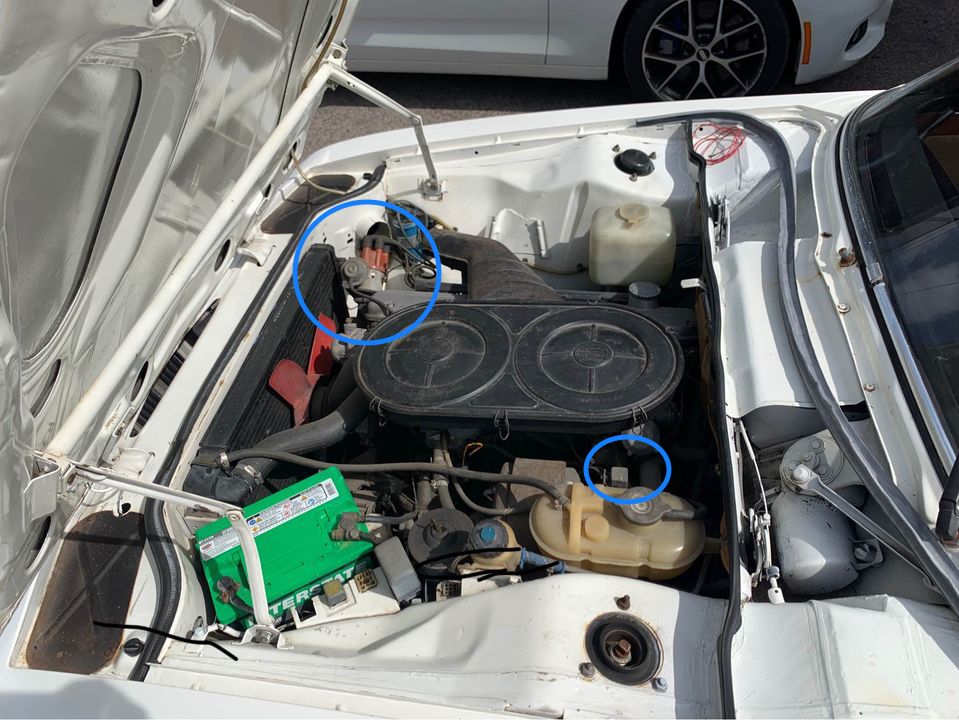

Lots of strange parts on this one, but my vote is CSI chassis.
D-Jet bits:

Floor repairs don't look great, but overall not as rusty as some we have seen. Even with the video it is an incomplete picture of the trouble prone areas.
