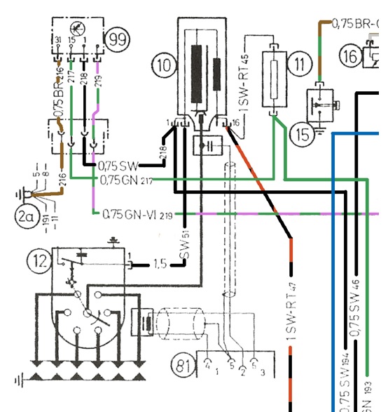

Hi everyone,
I am trying to figure out how the balast resistor is to be wired in the 1973 3.0CS.
Currently running the 123 coil and distributor (if that matters).
Can anyone help me out?

Ballast resistor is 11
Coil 10
Distributor 12
Ignition distributor sensor 99 (on the picture is showed CSI) but for CS you should have green wire anyway
Black and Green go down to diagnostic plug
Red/Black to the starter

Being clear here- under 1 ohm resistance will be hard on a 123 unit.
Ed definitely will tell you to avoid.
