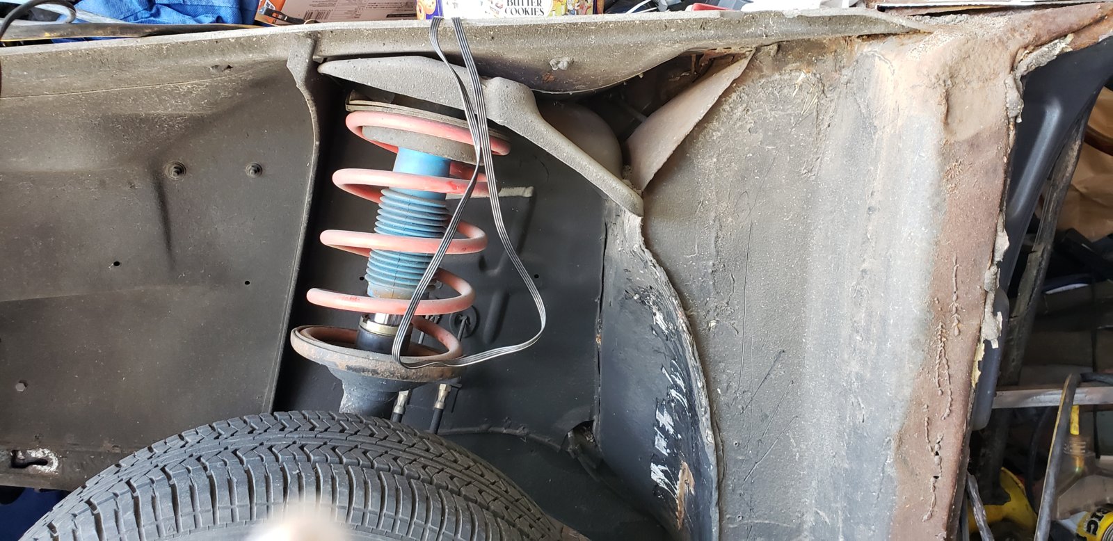

Got the front driverside fender off over the weekend. The overall condition is not as bad as I thought under the fender wise. Just missing a bunch of parts. I'm surprised it held together so well without all that internal supporting structure

Got the front driverside fender off over the weekend. The overall condition is not as bad as I thought under the fender wise. Just missing a bunch of parts. I'm surprised it held together so well without all that internal supporting structure View attachment 71797
Wow. Just wow. Good thing you opened her up.
