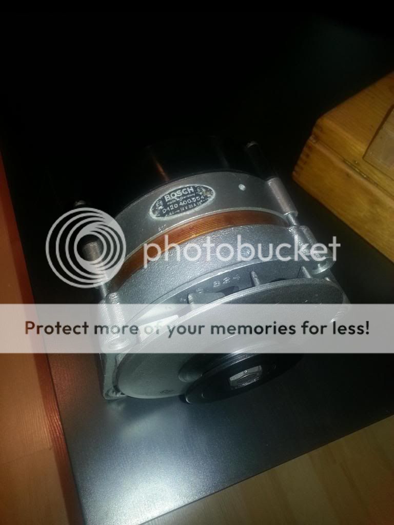

I also had to have the alternator rebuild... all 9 diodes were dead, the slip ring was toast and so were the bearings and brushes.

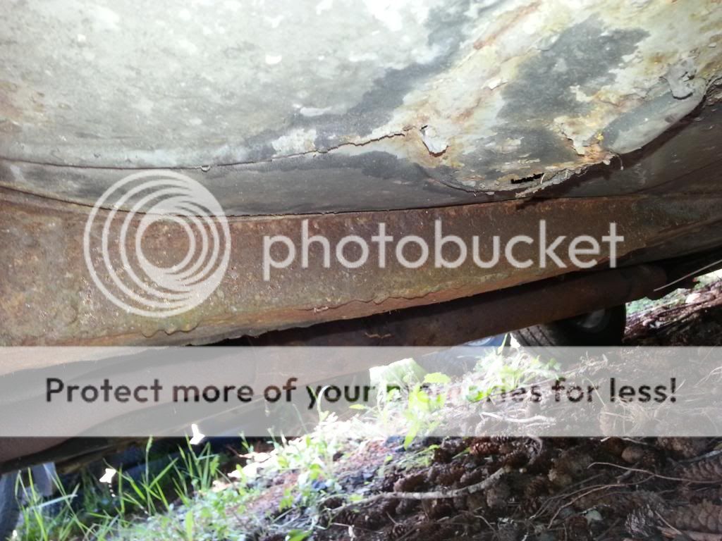

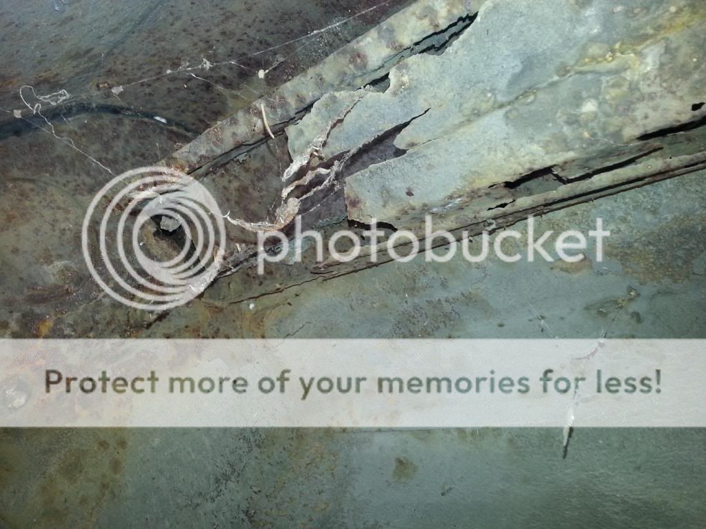

I also took some pictures of the rust on the drivers side (worse side) of the car.
Driver's side fender well, left side is towards the headlights.
Driver's side floor and frame rail. I knew someone had been in here repairing long before I got the car, but I didn't expect to see the frame rail fishplated with 1/4" steel plate lol.
quick picture of the rebuilt alternator, rebuilt at Brian Roberts Auto Electric here in Victoria for $200CAD.
