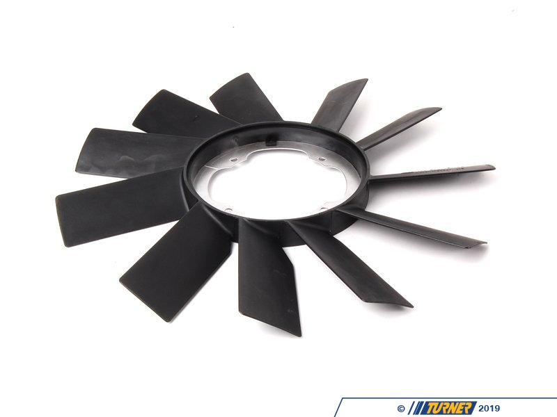

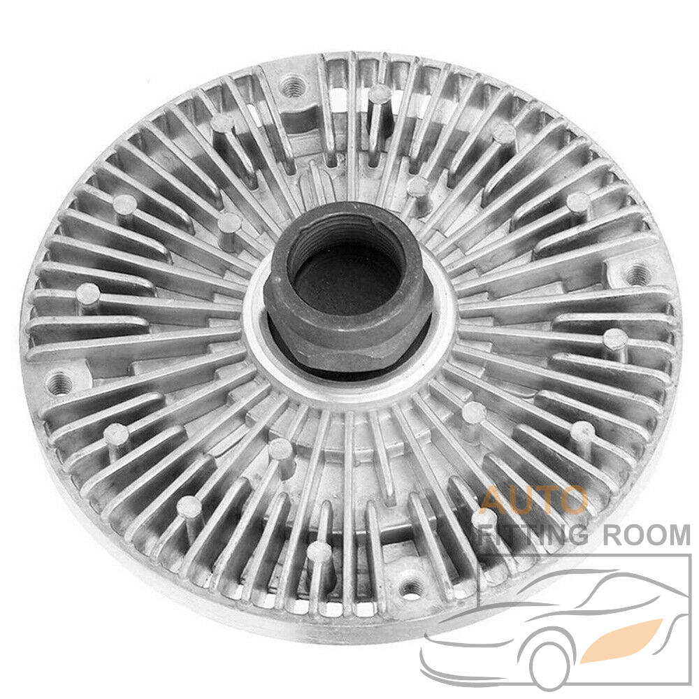

While your part numbers look OK, it may be preferable to order the eleven blade fan (11521723363). https://e9coupe.com/forum/threads/cooling-fan-upgrade.10468/ I also wonder if you need to separately acquire fan-to-clutch fasteners. (These fasteners and the pump gasket may be included with the ordered parts.)

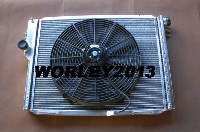

As an afterthought, if you have a clearance issue that cannot easily be corrected by mounts or even a thinner radiator, you could always consider an electric pusher fan.

If you are mounting an electric fan to the radiator in lieu of an engine fan, which I think is what tochi is recommending as an alternative, that fan should be a puller, not a pusher. And if your car has a/c, you would want a two temp switch, with the puller fan going on at a lower temperature, and the pusher fan on the condensor set to come on at the higher temp on the temp switch (in addition to coming on when the a/c is on).
Also, if you go with a radiator mounted puller, a fan shroud is a good idea as it makes the fan more efficient.
