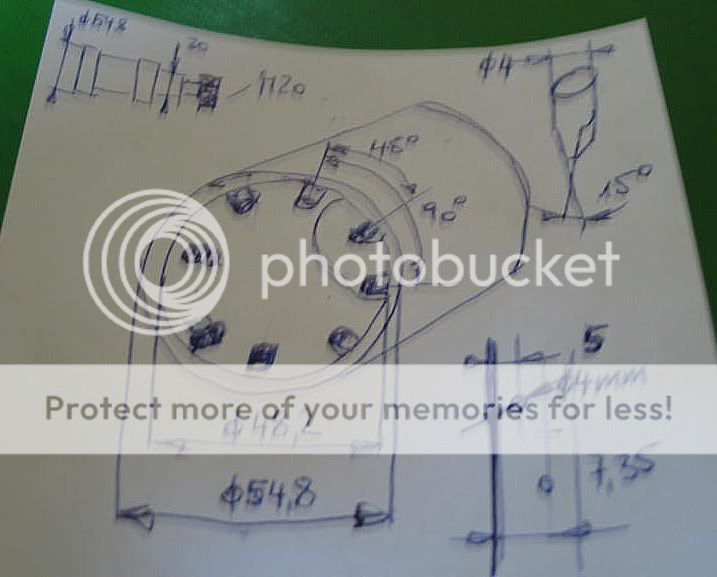

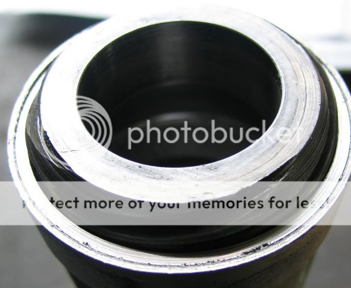

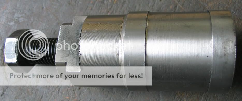

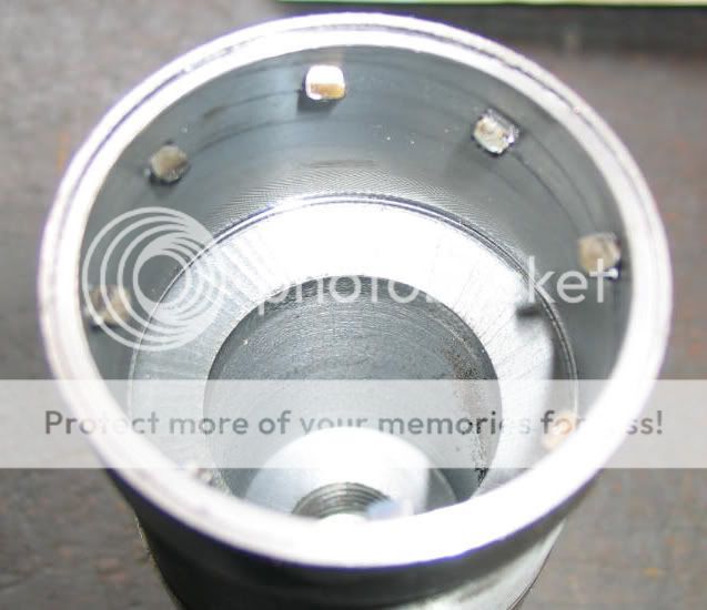

Oranger, could you please elaborate on the extractor? Are you speaking of a gear puller type device? I'm afraid I am going to have to search the yards for one of these since nobody seems to have one for sale. I am converting from and automatic, by the way, hence the need for a drive gear.
EDIT: Ahh, never mind, I see be your photos what you are talking about. Is there another method for removal?
