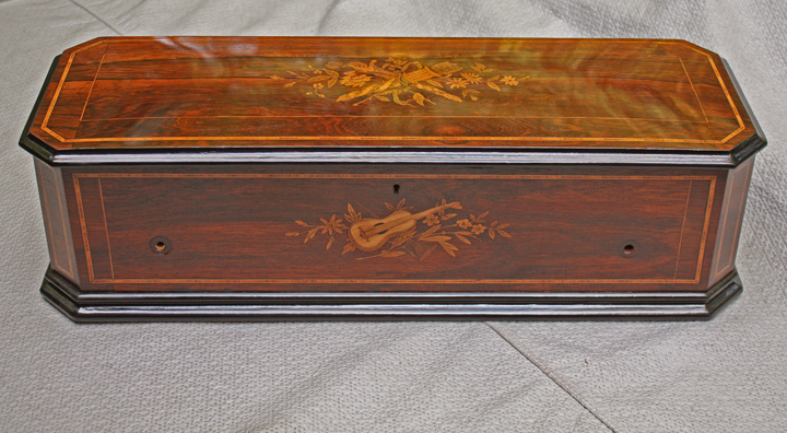

Most of my french polishing involved music box cases like this one.

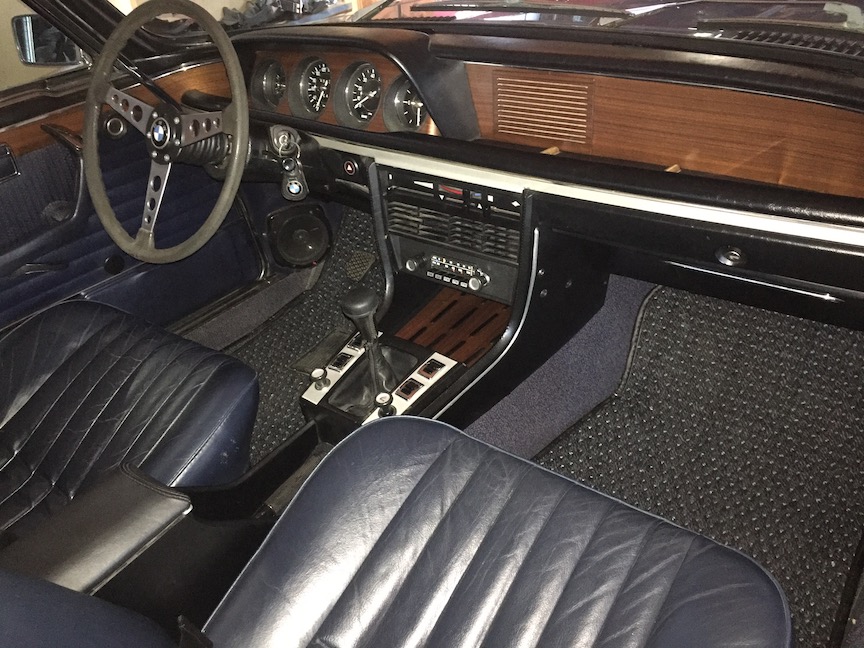

Andrew's, above, looks very good.
