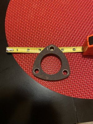

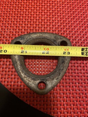

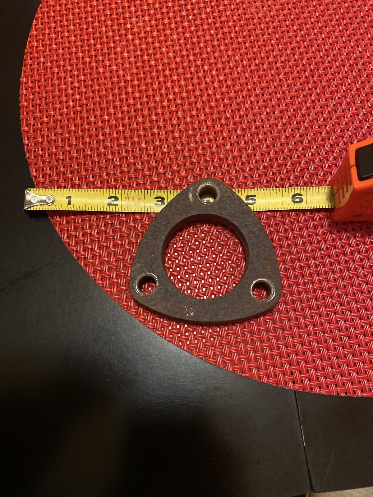

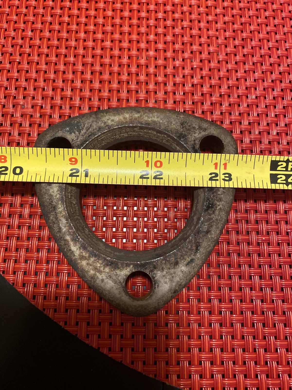

It's from my W&N downpipe, I need another to attach the headers to the 1st muffler. It's about 42.5mm ID (1 5/8") and is beveled to accept a compression ring. Center of bolt hole to another hole is about 58mm. Thanks.

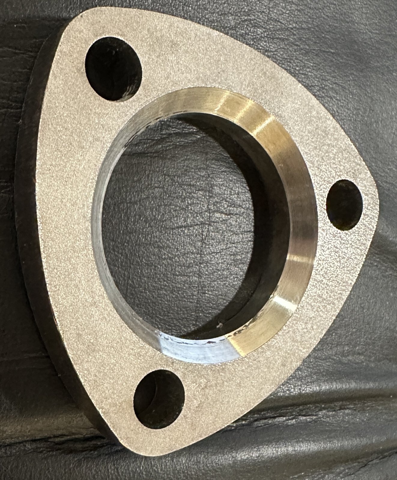

Did you try an muffler shop or specialty exhaust shop, they usually have these around as well as compression rings, some were made of steel, some were more like a crush sleeve style, I found that these tended to burn out quicker
Thanks, Rick
