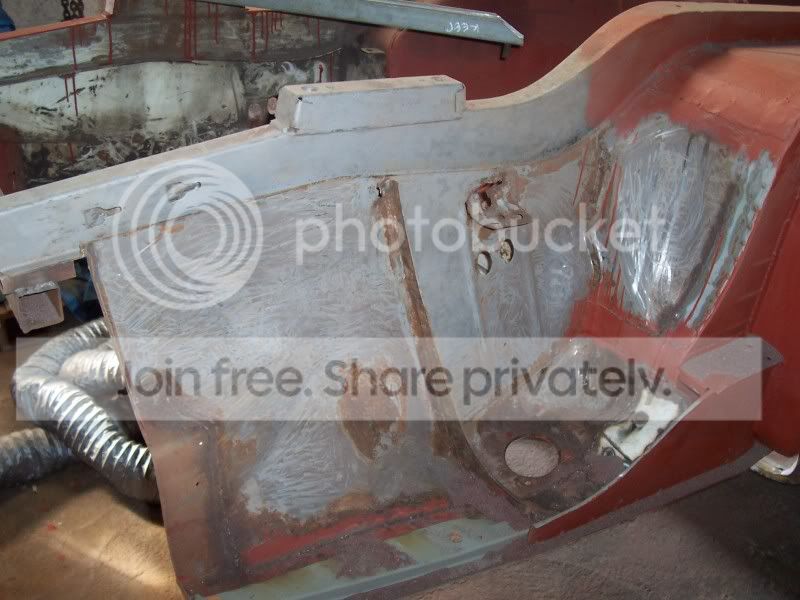

Rear LHS arch work continues, remember the car is currently upside down!
I finally got brave enough to attack the remains of the rotten outer arch. Note the use of the "white out" and black marker pens so that everything lines up. The most important being the swage on the forward part of the arch for the lower rear wing
After that its time to fettle the bottom rear part of the wing (to be continued) to get it to sit right in conjunction with the arch.
Both the outer arch and the lower wing part are Jaymic repair sections. You have to be brave (IMHO) and cut them up, bend, and hammer into shape as required to get the best fit. I suppose I could of bought whole new rear wings but my budget doesn't stretch that far
Once I am happy with where they all sit I'll tack weld them into place before finally commiting to full welding.....
The saga will no doubt continue as I try and match up the repair panel for the bottom of the wing infront of the arch

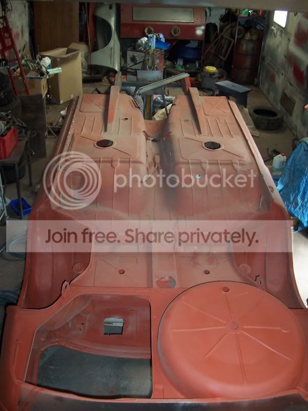

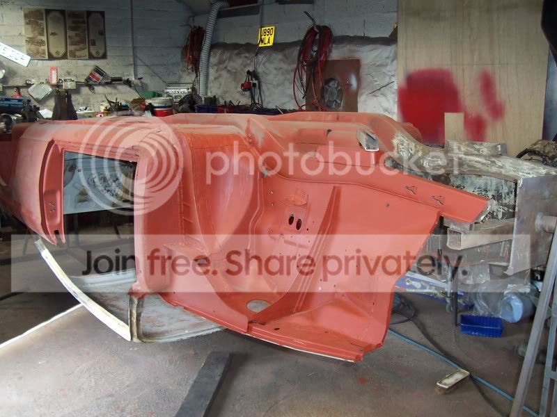

Anyway I have finally finished removing rust all the way forward to the bulkhead. Its been a long laborious process with many interruptions with work, lack of funds, and all the other stuff that gets in the way. Hope this is of interest.
I have started forward to the bulkhead
Just this side to clean up and repair, then it will be add the rebuilt nose cone time.
Once that's done its clean up the engine bay and cabin.

Malc,
I have enjoyed watching your progress. I am currently rust deep in the front A pillar area, so your photos are timely. Have you completely sealed off the "cave" area from below (behind the shock tower)? I am considering welding the support arm opening closed and even sealing all the weep holes around the edges of the heavy gauge strut support plate. In this case I might cut in a small access port from the top side just behind the strut mount - just large enough to provide some ventilation?

Hello Sven
No I haven't. The BMW inner wing extension piece has some holes in it, why I haven't a clue. However I have left them open and will be injecting the area with cavity wax. When the whole area was exposed I did remove all rust and paint with anti - rust paint.
I might have some pictures of the area before welding it up!
