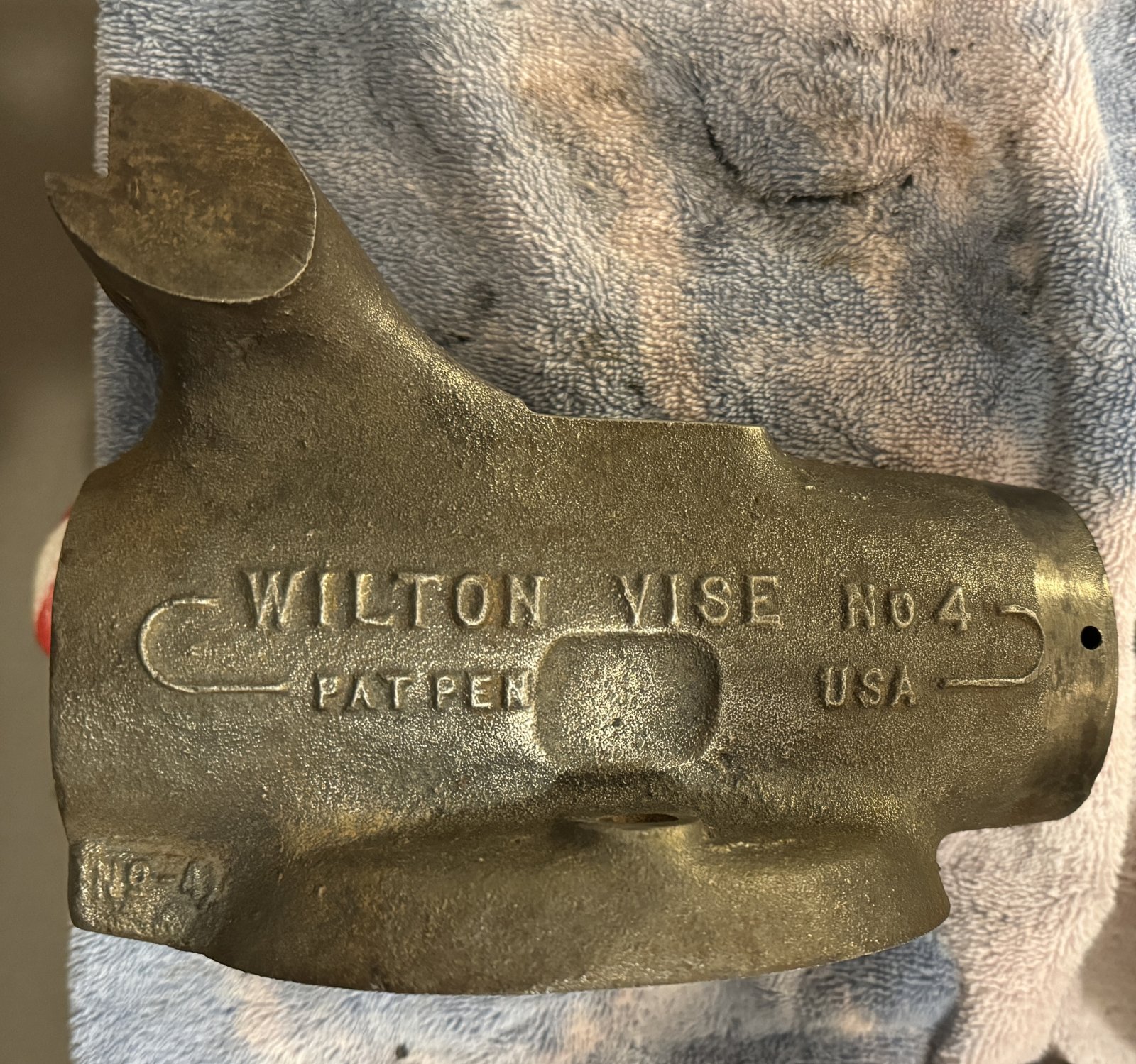

My neighbor gave me his work bench so obviously it leads me to needing a vise. A vintage one of course. Not knowing a damned thing about vises, off to Craigslist and Facebook marketplace I go. Discovered the Wilton bullet style-very cool looking. Want. Apparently there is quite a collector following for these. Many for sale but not cheap. Stumbled upon one on FB that the PO painted everything flat black and priced right. Looked promising to this blind squirrel. Off to the Garage Journal forum for some research. Apparently this is a 1940’s model. Purchased it even though it was frozen. As found:
Paint stripped and disassembled for cleaning:

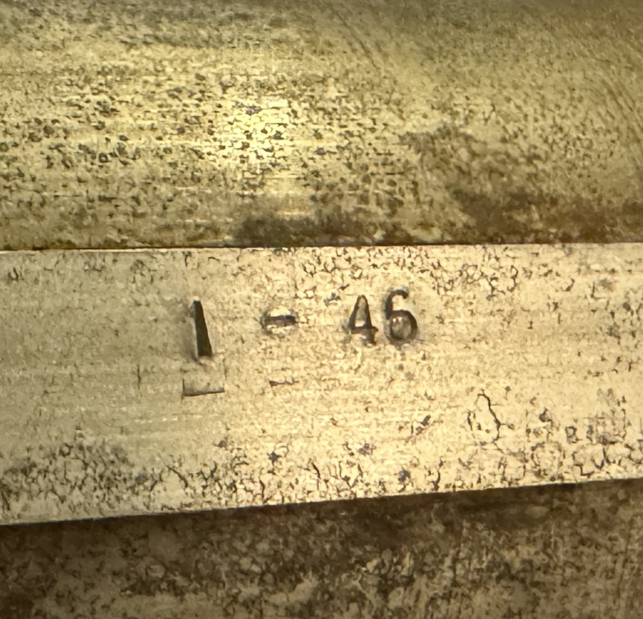

Forum experts tell me I have a rare pre-war casting, all Wilton vises during WW2 were sold to the govt for war effort. Cast in 1941-1942 based on markings. After the war ended they sold surplus to the public. Original jaws. Mine was sold in Jan 1946:
So I disassembled, cleaned, primed, painted, satin cleared, greased, and bare metal dressed with boiled linseed oil. Smooth as butter after 80 years. American iron. Weighs 40lbs. B-17 livery as an homage to it’s cast period. Lights make it look more glossy than it is. I’ll be putting it back in use keeping the E9 on the road!

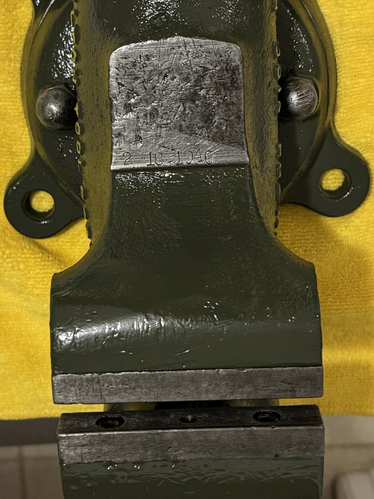

There’s also a date stamp on the anvil pad, 2-18-1946, apparently this is when the purchasing company put it into service. Fun stuff!

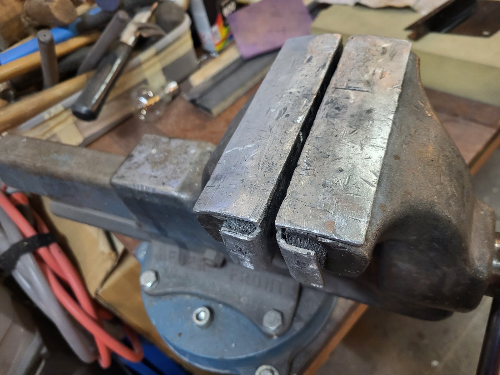

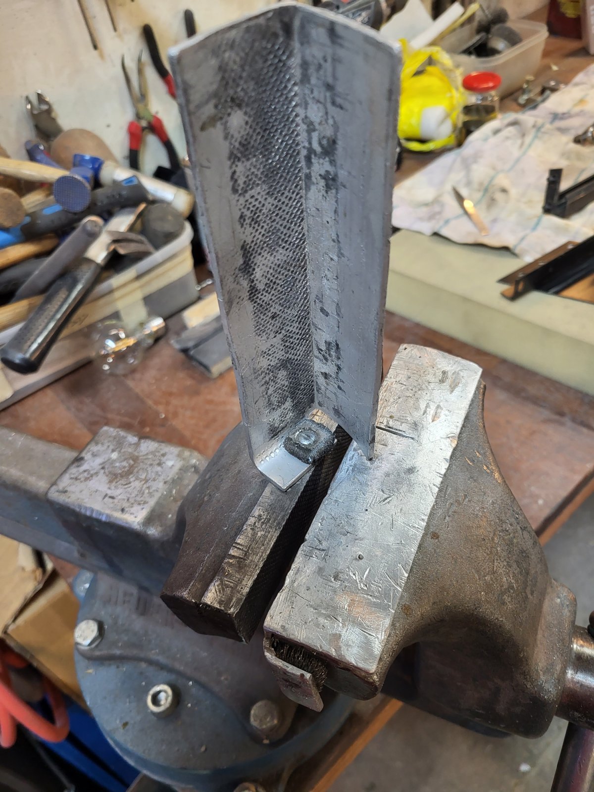

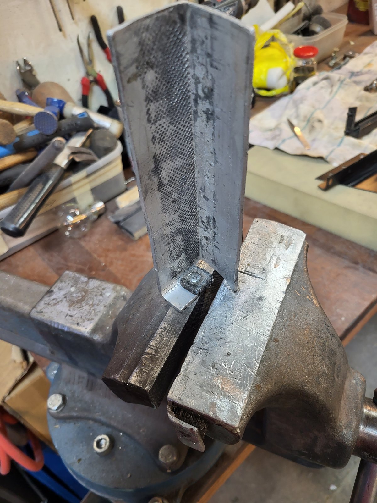

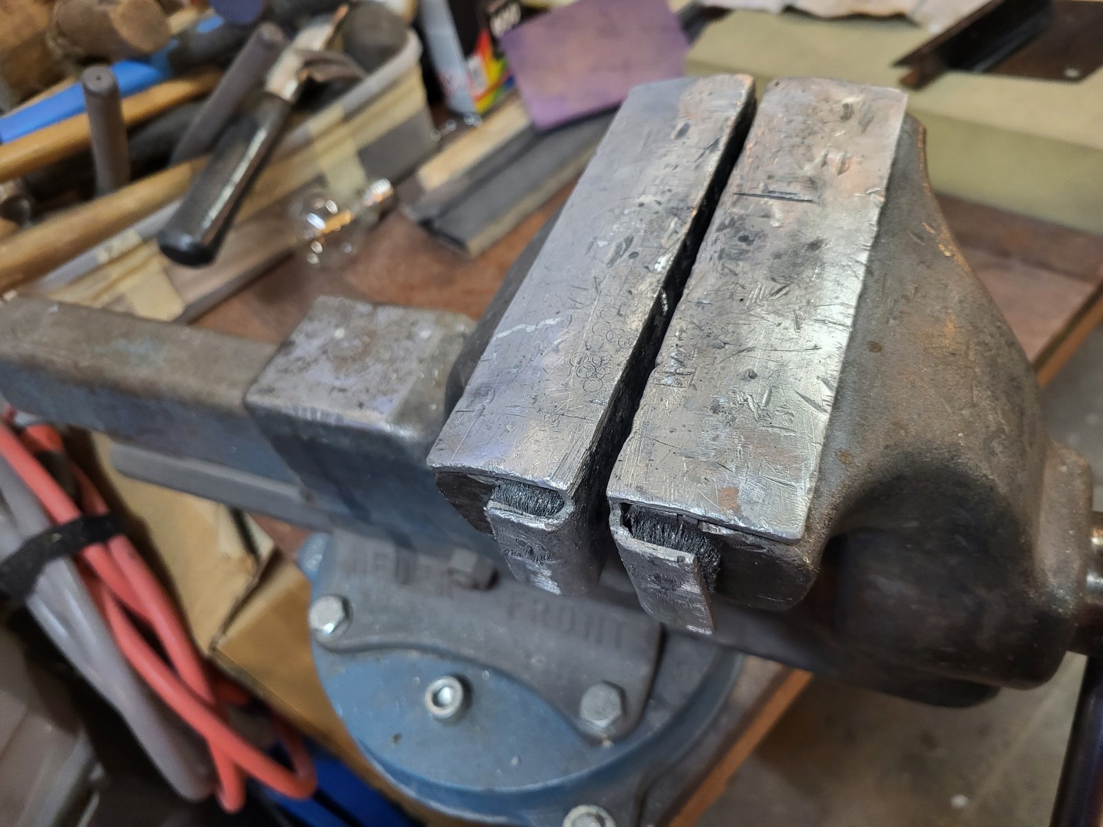

You might want to invest in some aluminium jaws for the vice. The convenient ones have strong magnets to keep them in place.
Very handy if you want to clamp, for instance a thread without damaging it.
I make my own from a piece of angled stock and a screw on magnet. I replace the alu part every few years as it gets gnawed.
I also enjoy the rotating base under my vise, as it allows you to better position your body relative to your workpiece .

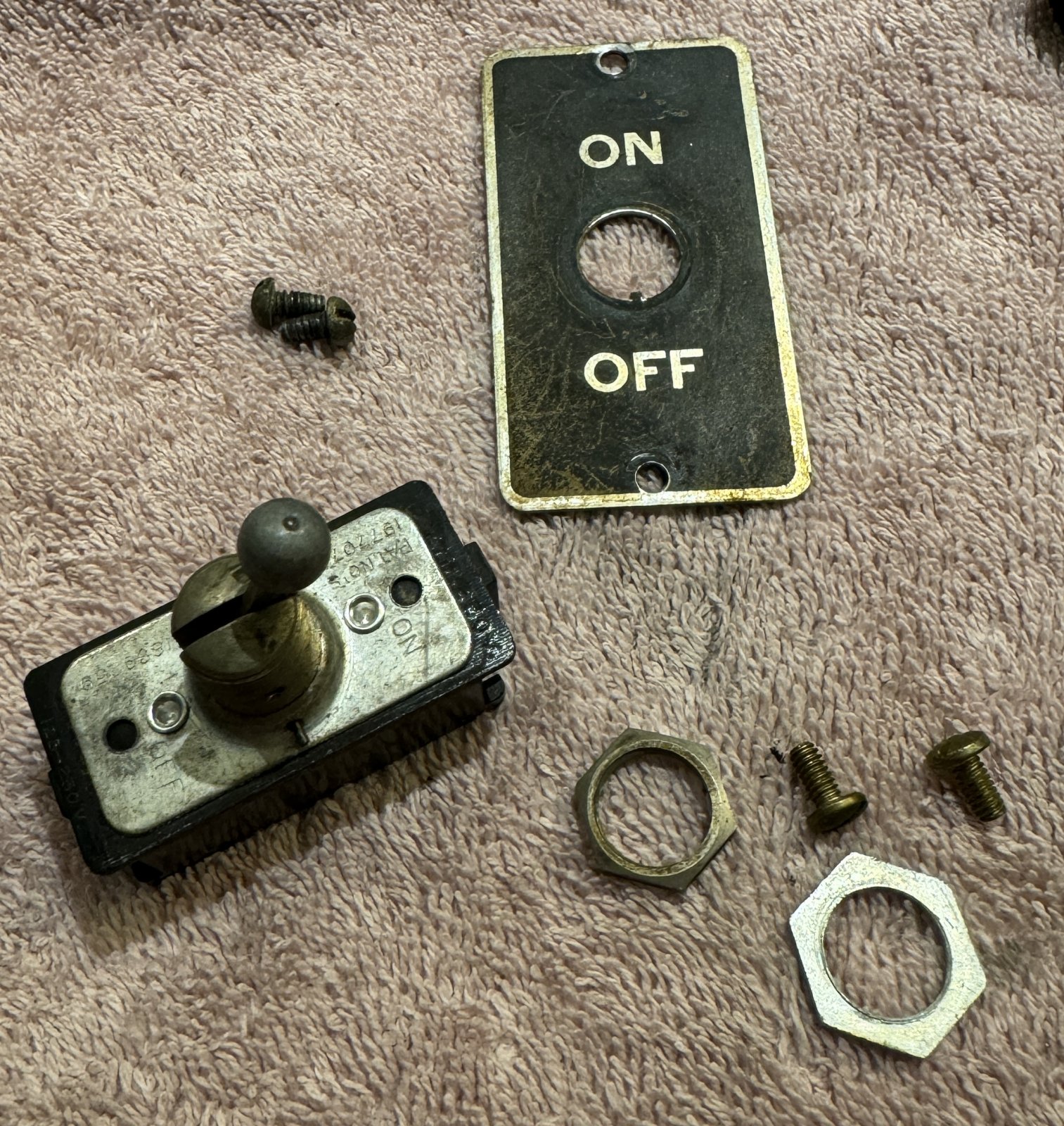

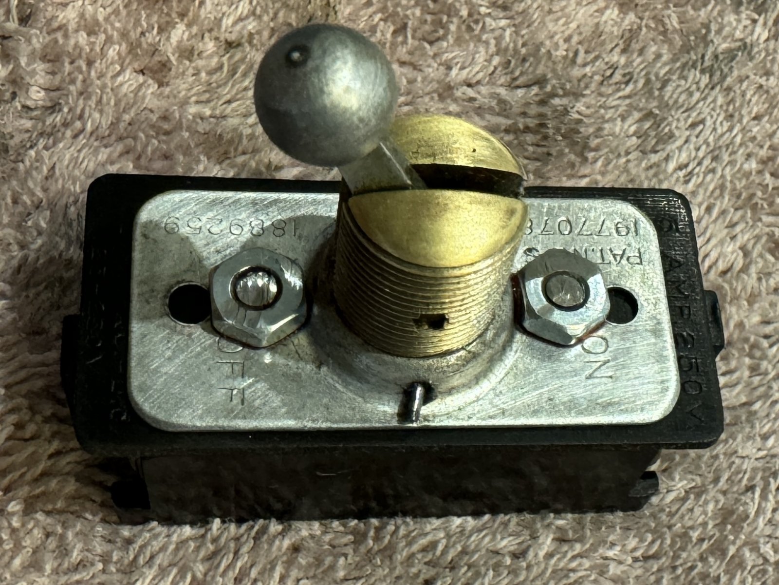

For those wondering, the setting is my daughter’s kitchen this time :D It has no “arc of shame” which I’ve learned is drill press lingo for no one drilled through the table along it's axis. He said it works fine but the switch has been broken for ages so it starts when plugged in. I took an hour today to fix it by drilling the rivets to disassemble, cleaning and bending the contacts back in place, regrease, and replaced the crusty old cardboard internal insulator with thin plastic gasket material. The bakelite insulator is in perfect shape and the "Hurst 4-speed" ball head switch is also brilliant in its design and now works as new. Before and after pics:

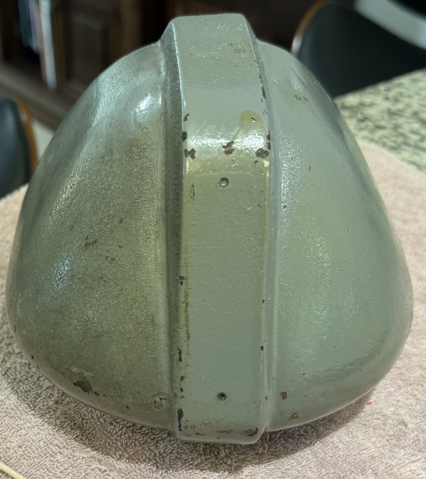

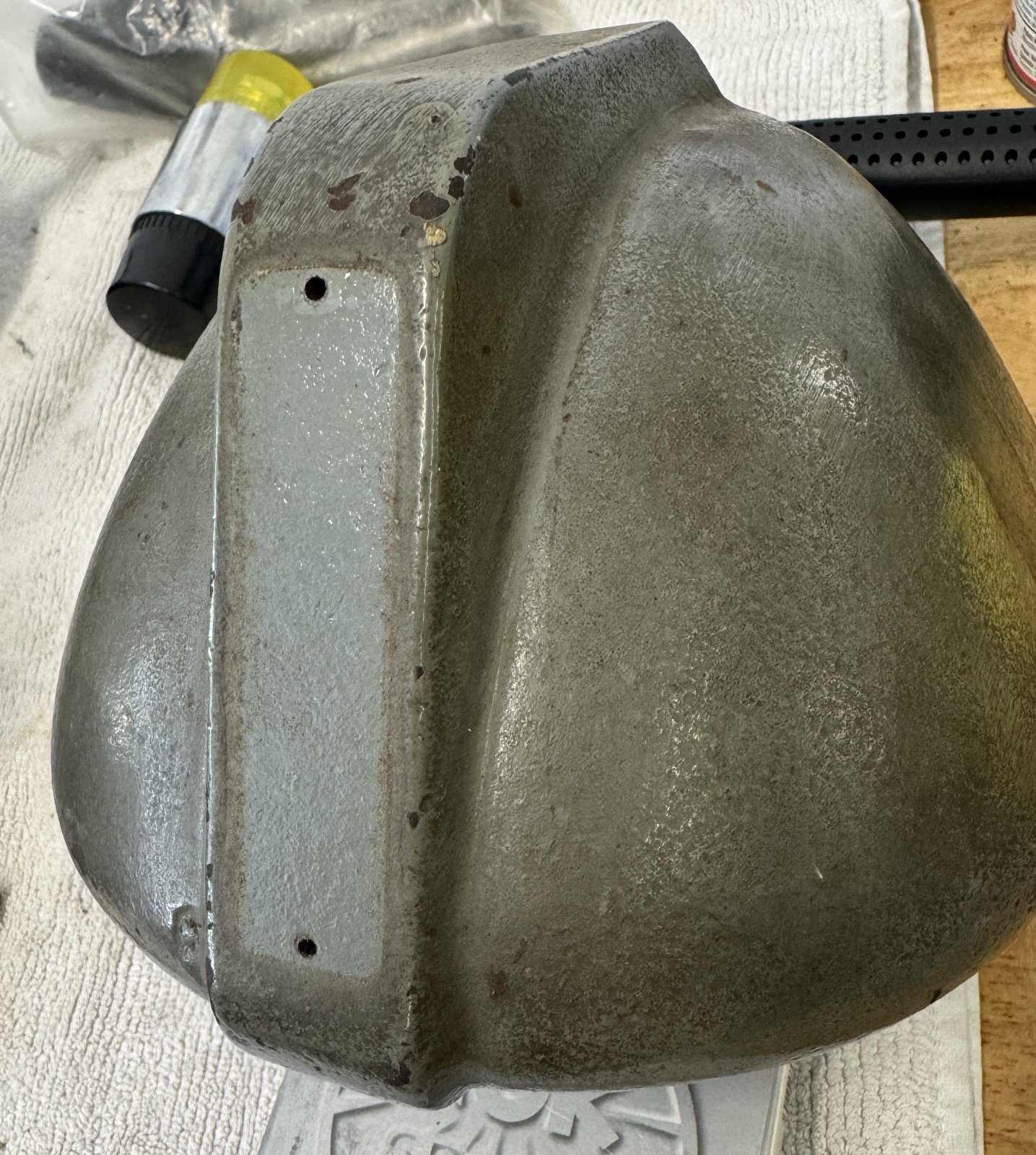

I removed the pulley guard to asses whether to repaint the entire press 1940’s hammered silver/pewter (WW2 era Mercedes/Auto Union look), try to match the paint, or leave the patina. So I punched out the press screws (never seen these before) from the back side and freed the metal emblem to reveal the original color, a green/grey not too far off from one of the E9/E3 air cleaner colors:
I cleaned half of it to compare and it has come back so nicely I am considering the patina look. Looks like 77 years of cigarette smoke and diesel fumes preserved it pretty well. What would you do?
This drill press is original and in amazing condition the more I inspect it.

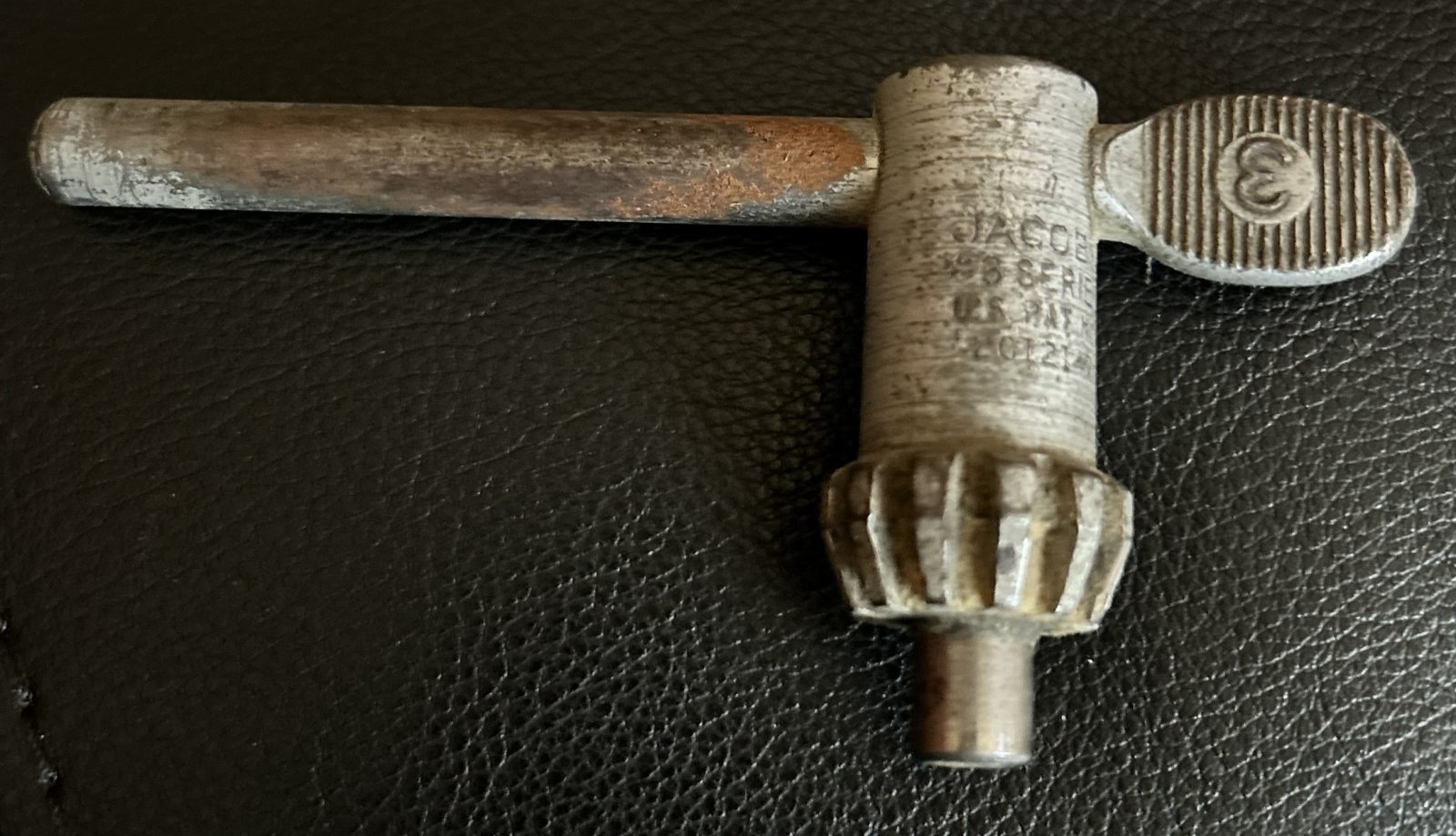

Came with original chuck tool!

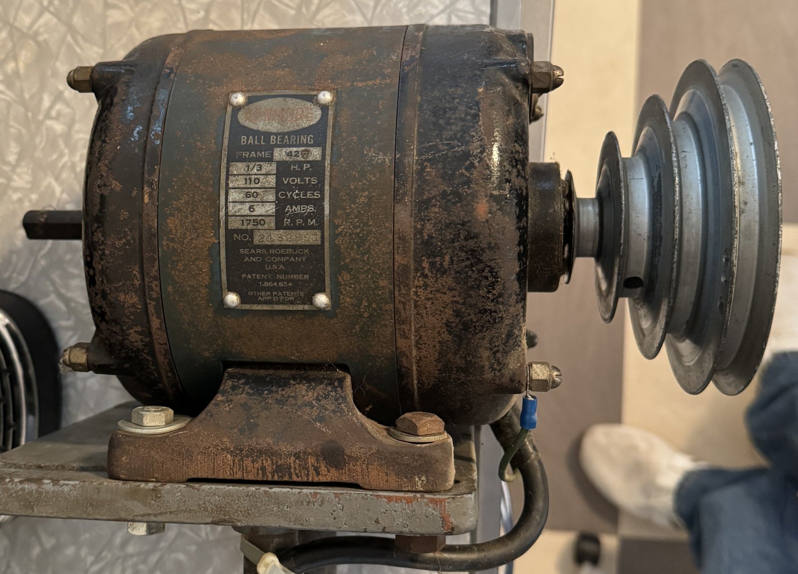

Next up for analysis is the late 30’s - early 40’s Sears Kenmore 1/3 hp motor (actually made by the Sunrise/Packard company) that powers it. These machines are built like tanks. I will clean and de-rust the metal, inspect the bearings in both the press and the motor but I won’t be surprised if re-lubing is all they need. I’m going to clean out, rebuild, and repaint the motor.

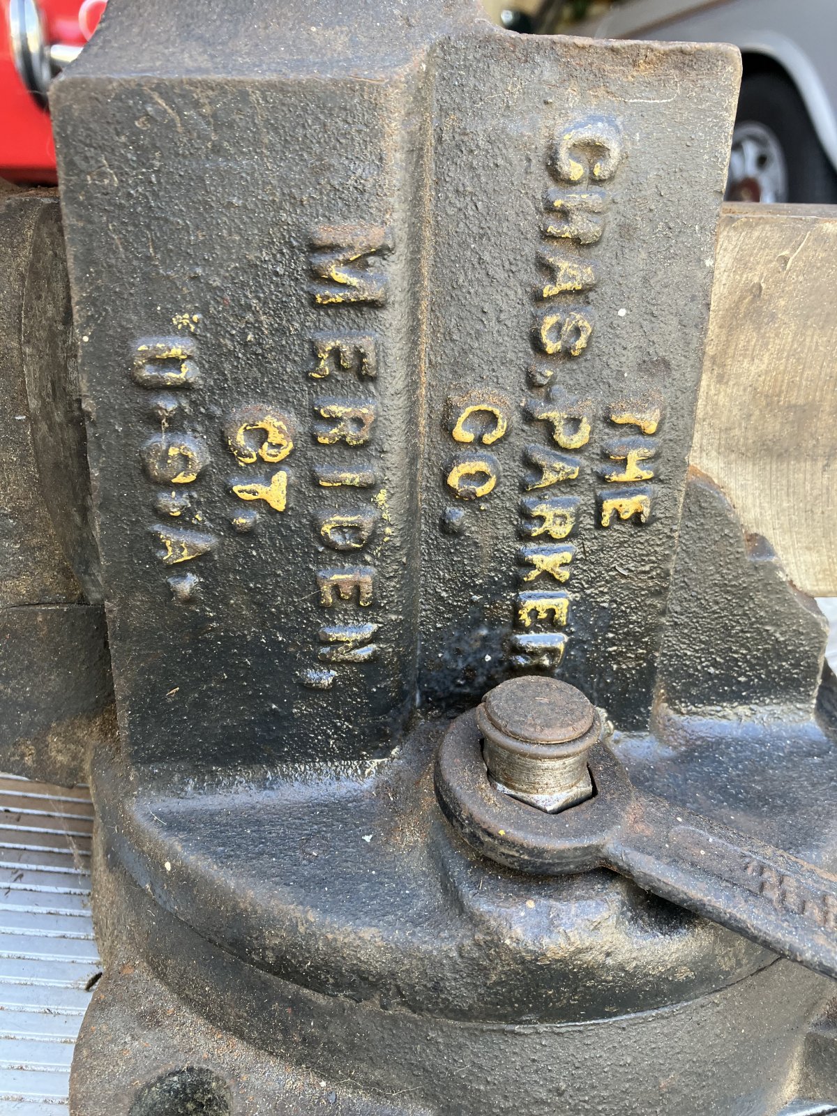

You guys are making me feel guilty about selling a couple of my father's old tools on Craigslist earlier this year. I had his old Chas Parker vise and a 1960's era Craftsman drillpress. I have duplicates of both, wanted to reduce the clutter in my garage, so out they went. I was surprised at how many inquiries I got about the vise; the buyer explained that they are collectable.

Me too when I started looking, I think it is a combination of quality and nostalgia. The Parker is definitely collectable, I almost bought one but was too big for my needs. Atlas made the early Craftsman drill presses then they moved to another manufacturer for that era press. Both were well made.
