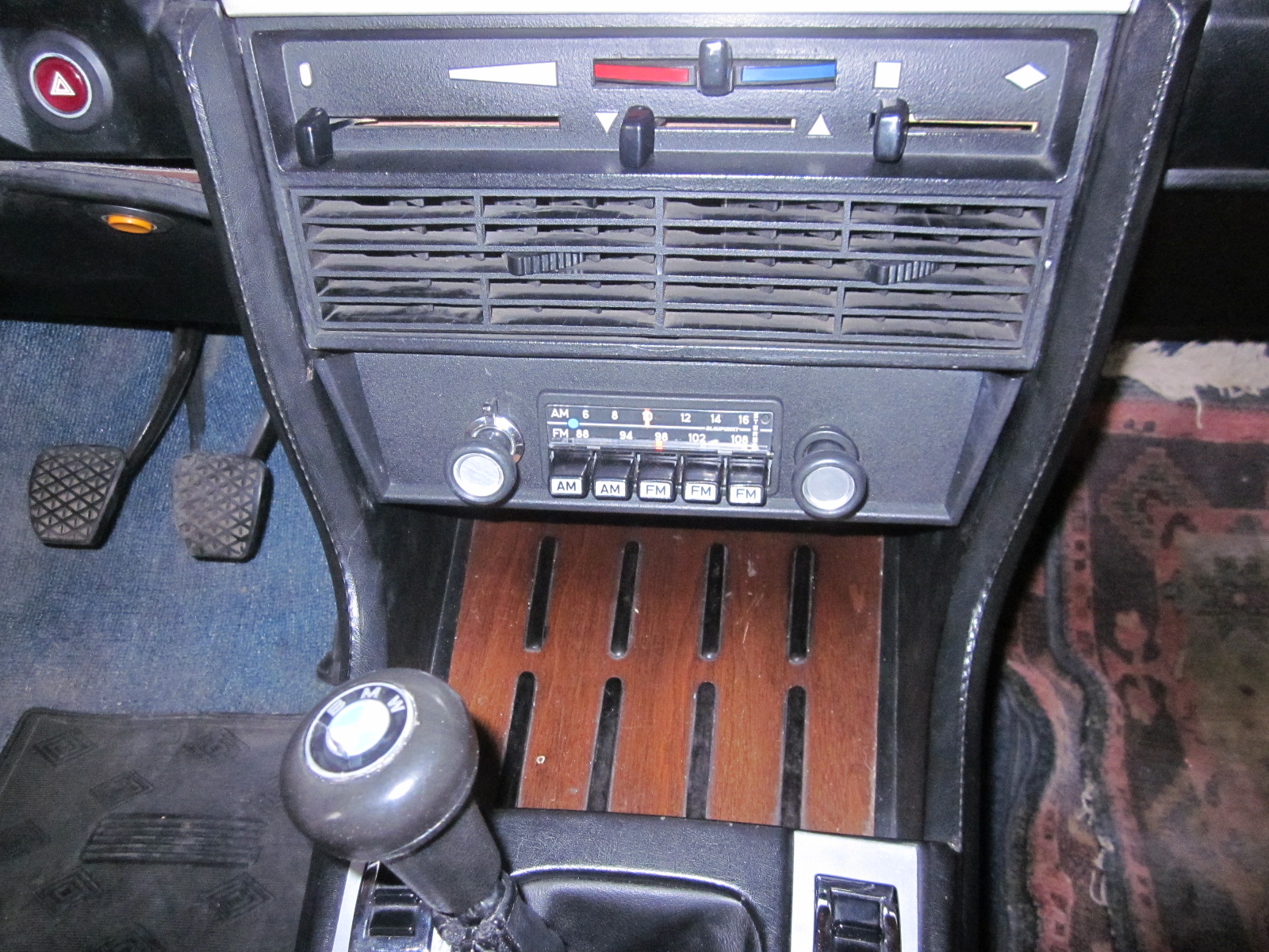

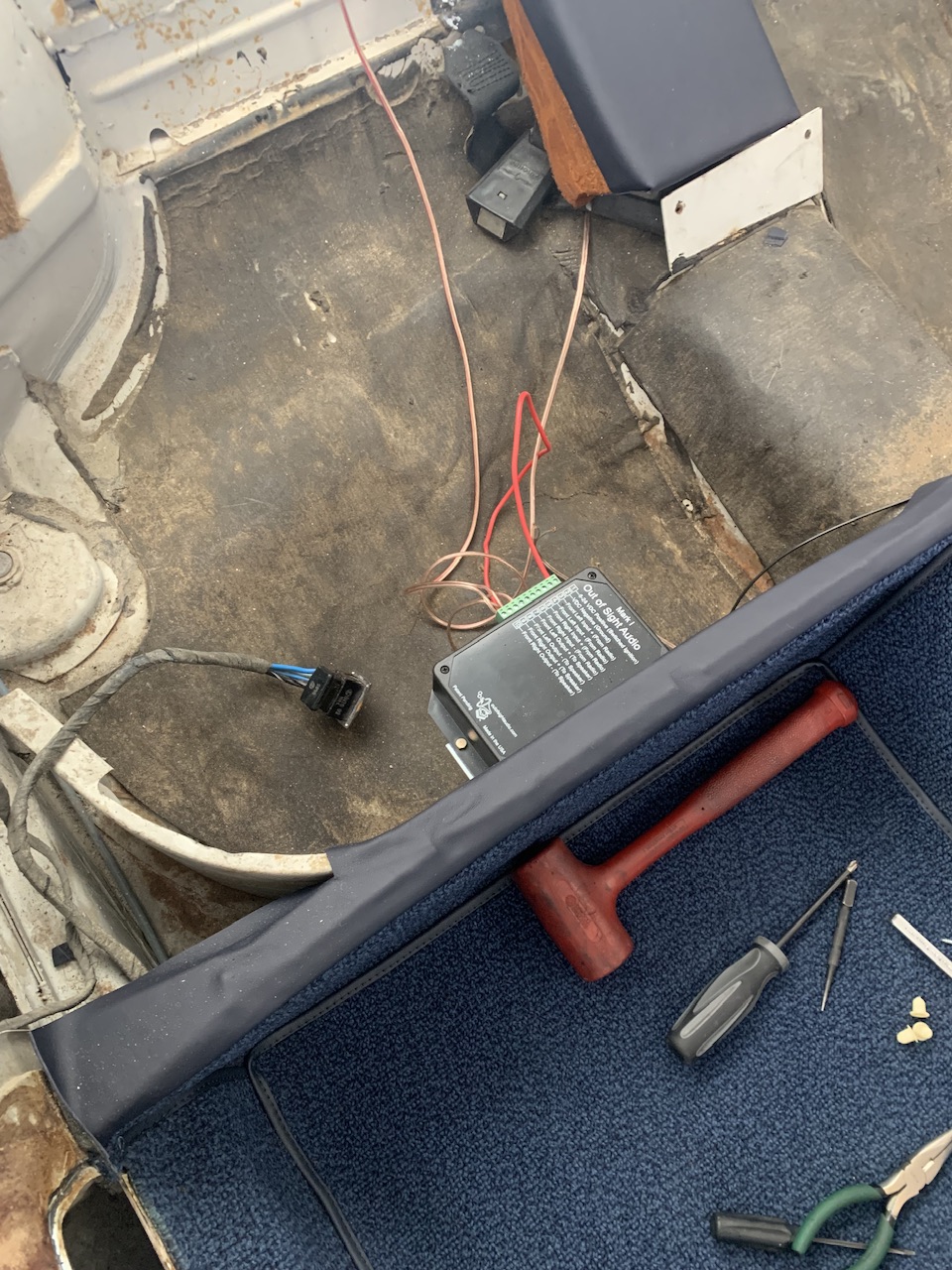

At Andrew’s recommendation I just installed this Out Of Sight two channel Bluetooth amp driving two 6x9 3 way speakers on the rear shelf. I was amazed at the quality of the sound as well as the volume! I tested the BT but have not yet hooked up my Blaupunkt Frankfurt Stereo radio just yet.

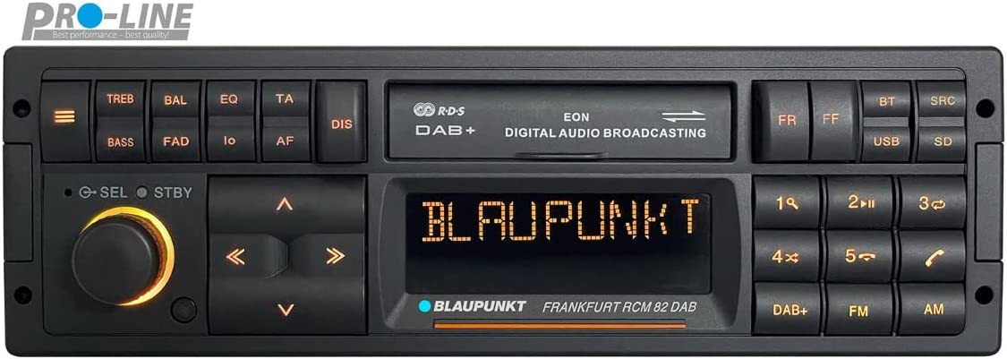

Blaupunkt has relaunched "modern" versions of the single DIN Bremen and Frankfurt head units called "Retro Classic". MSRP is up around $650 - but Amazon sells them for around $500. They look stunning and sound very nice - and the original cassette tape slot now cleverly houses ports for USB, SD and AUX. However, unlike a Chrome London conversion (which is more expensive, but quite good) where they start with a vintage, 1970s or 1980s "Made in Germany" chassis - the chief complaint of the Retro Classics is that they are now made in China, and the buttons and dials feel "cheap" compared to refurbished versions of the originals. The Chrome London is a refurbished analog radio with Bluetooth and Telephony added - so as a stereo head unit... it doesn't sound any better than it did back in the 1970s or 1980s except for the digital sources being cleaner than the hiss-filled sound of an analog cassette. Moreover, if you go to the Chrome London website, you will see many of the period-correct radios for an e9 (early 1970s) were not even stereo units (they were mono-radios). Also, there are multiple eras of the Blaupunkt Frankfurt, Bremen, and many other models. The period correct Frankfurt is going to be more simple and crude looking than a 1980s Frankfurt... and the current Retro Classic Frankfurt is patterned after the 1990s version of the Frankfurt; and the early versions of these radios put out a whopping 5, 7, maybe 9 watts per channel. Bluetooth and Telephony equipped period correct radios from Chrome London will start around 600 to 700 euros - before shipping; and they charge a lot for shipping.
By contrast, the Retro Classic Blaupunkt is just the opposite of the above - a newer, modern amplifier putting out 50 watts per channel; optimized for digital sources with a retro interface- so as a stereo unit, it sounds better because it is a modern stereo with built-in bluetooth and telephony styled after the old unit that's made in China for $500 from Amazon. So which is more important to you - pure audio performance or the retro look and feel of old world Made in Germany ergonomics... at a higher price point?

Scott, I bought the Mark 1 as I only wanted two channels and phone was not important. When hooked to radio output it operates as an amp with radio on. When paired with your phone it bypasses radio and you can stream Spotify which I do or play music saved on your phone. Radio does not need to be on as it is powered by a switched power source, fuse 10 in my case. And it does not need ungodly large power wire, I just used 12g but it says 14g is OK. Phone does not control radio, volume is controlled by your phone. Cellular used for all streaming services obviously. I love it so far but I haven’t driven the coupe yet as it had no seats.

I hid a USB charger in the glove box mounted to console side of inner box, wired to switched fuse 9, if pig-tailed in to radio power you may get feedback.

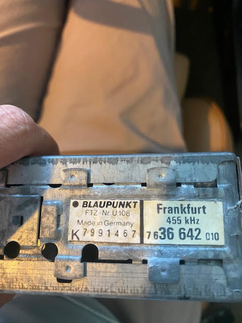

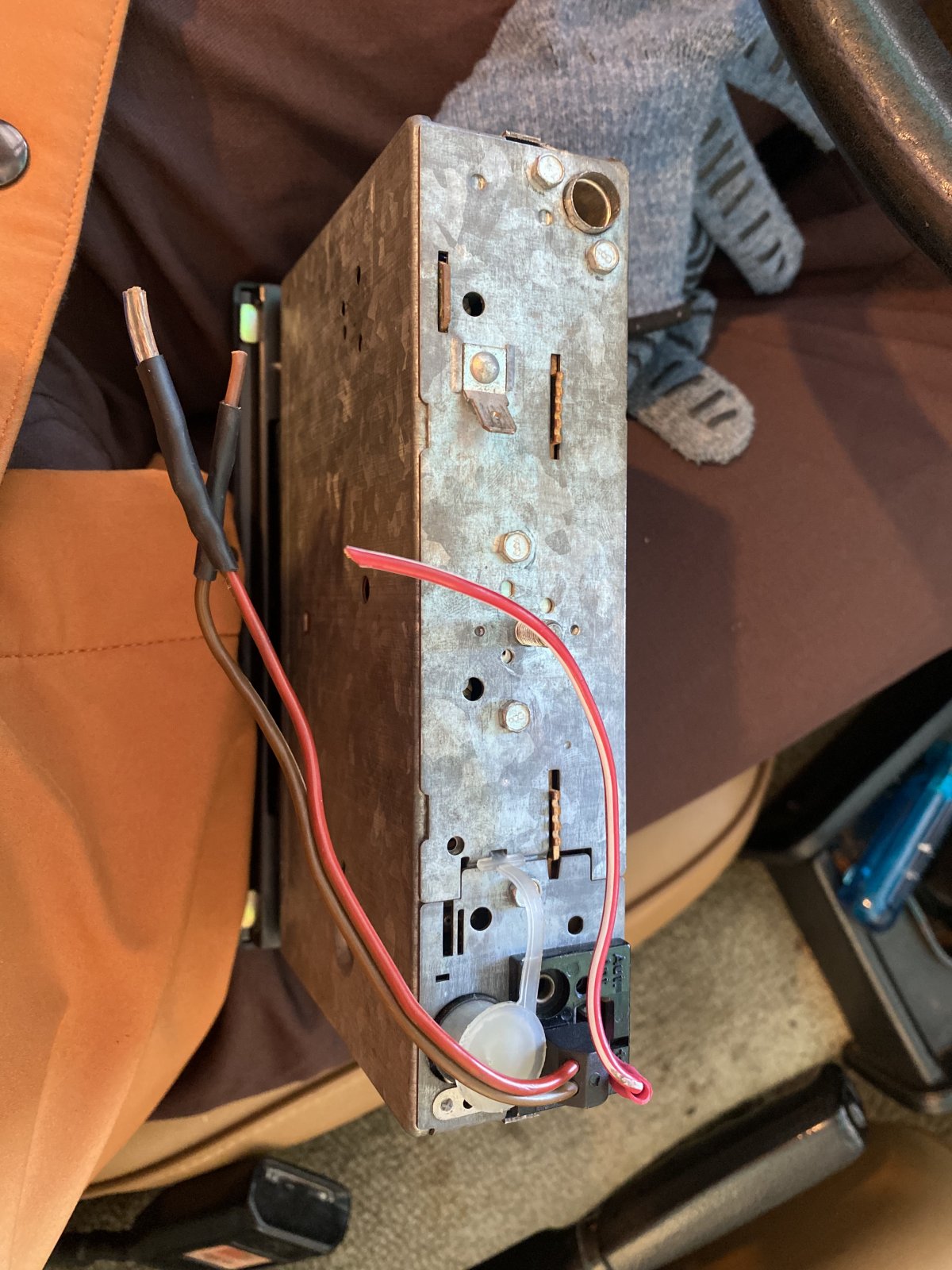

I was a little hesitant to start a new thread for a question I had, since it’s more E12 than E9; I was searching the archives here for info and thought I’d piggyback on this one.
I have a mono Euro-model Frankfurt from about 76-78 for my E12. Bought it from the guy I bought the car from, who had taken it out of another E12 he briefly had. My car currently has an ugly modern head unit that doesn’t even fit in the dash because it’s a CD deck. Works well enough, looks terrible. I want something that looks good, sounds good enough, and can support playing music from my phone and hands-free calling. I got the Frankfurt with the car, and I picked up a Bluetooth adapter for it that plugs into the 6-pin DIN plug on the back. I figured all I needed to do was install it. Yesterday I took the modern deck out and started looking at the wiring and where I needed to cut it, and I seem to be stuck.
Head unit is mono. I didn’t know what speaker impedance it was designed for, or what the internal amp is rated at, so I started looking into that yesterday. I eventually got a hold of Ingo Prangenberg (vintageblau.com) who told me it’s designed for 4 ohm speakers and has a 4W internal amp. If I just look at the math (P=V^2/R), I could in principle wire a pair of speakers in series, ditto the other pair, then run each of those sets in parallel and I’d get 4 ohm total impedance. Seems like that should be OK? But he also told me straight up that a mono radio is not going to run four speakers - It’s too much of a wattage draw, and I’ll quickly ruin the amp. The guy knows these radios so that’s worth...a lot.
Options seem to be:
-trade for the same radio in stereo
-only run the front two speakers (little things in the kick panels, look original)
-put something else in this car, like a Continental, put this one in my Fiat (only two speakers) or maybe the 911 or something
-add an external amp that takes speaker-level inputs, wire appropriately. This seems like it will add a lot of extra wiring work, though, unless I can fit it behind the dash somewhere.
Thoughts? Have any of you successfully wired a mono radio to four speakers without eventually killing it? I really want to put this radio in this car but if it’s going to be a lot of extra money or work then I’ll look for something else.

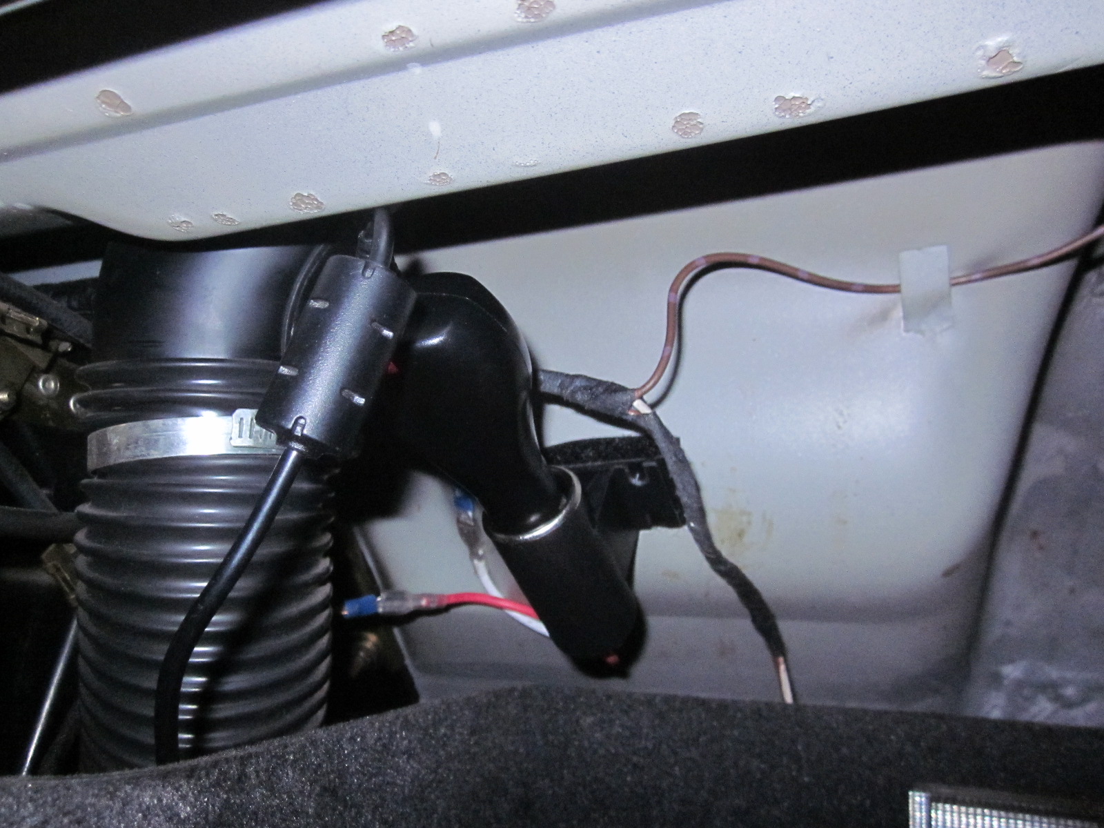

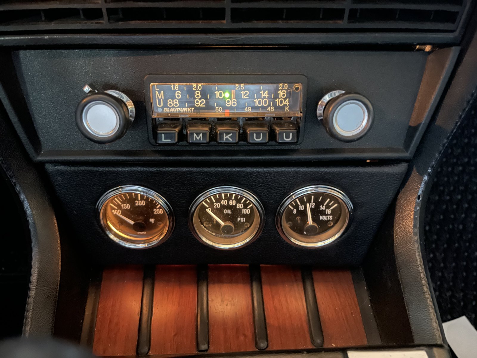

For the record, I have had 2 different Bluetooth radio systems over the years.
First was the 7 pin wire in the rear of the Blaupunkt Frankfurt accessory plug connected to an iLive Bluetooth receiver. This is powered to the keyed Purple wire to an accessory plug Velcroed it up & out of the way. Both the radio & accessory plug have inline fuses as redundancies, located near the fuse box for easier access.
When a resistor or diode failed inside that first US AM-FM Blaupunkt Frankfurt. I bought a proper European LMKUU Blaupunkt Frankfurt.
I explored several options from a Crutchfield Mini Amp & generic customizable wiring harness to having a local Auto Stereo place install something.
Chris Langsten at VSR sent me a link to Out of Sight Audio & bought the Mark 2 for stereo front & rear speakers. It's mounted to the back of the shifter console behind the accessory gauge panel & radio. The best feature about the Out of Sight Audio modules is one does not even need a radio as the units simply need power, ground & speakers to work.

If the only thing I wanted to do was listen to streamed music and otherwise use my phone, I'd probably do that. But I do listen to the radio (NPR) and want to be able to continue to do so. So a radio has to stay.
I still don't see how sending the speaker output to an external amp that boosts and splits the signal to four speakers is going to overpower the amp in the radio.

I would think the solution is to run the mono output to a 2 channel 4ohm impedance splitter, then run that to the high level inputs of a power amp which could drive 4 speakers of your choosing, including a subwoofer.
