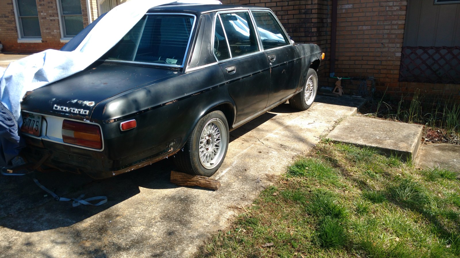

What are the thoughts on these E36 wheels on a bavaria? Think they'd look good? Do they fit? I haven't looked into it any further than this picture...they seem like they would sit inboard too much.

The styles represent the overall look and each one has a variety of sizes and offsets. The style 5's the most recommend are 17" from an e39. The 17's don't look bad at all but you have to be comfortable with the look.
The wheel that you spotted are Style 32's. The ones on the e39 are a more appropriate offset for an e3, but they are 17" as well. You can get them staggered with 9" rears.

Style 5's are available in 15x7 et20 from e34's and e32's...16x8 ET20 from e38's and 17x8 et28 from e39's...The 17's are true 2 piece wheels. The e36/46 wheels have too much offset. There is also the 17x8/9 staggered 20 spoke wheels from the 540i Sport package...Also pictured 15x7 OZ Fittipaldi ET20
