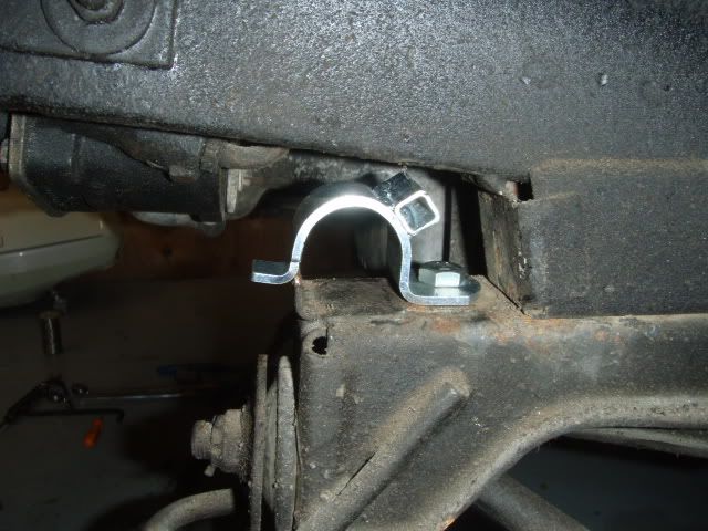

Here's a shot of what inovermyhead is talking about with the front bar clips
Not an easy installation!
I think I used a crowbar, vise grips, and a hammer and punch to finally make it all fit.

my installation included solving a problem with the existing stock sway bar mount so I assumed if your car had good condition mounts it would be fairly straight forward. Guess not. Yes, I do have access to a hoist which makes any work under the car easier.
The two photos show the welded existing problem and the plates I made up to deal with them. Having the plates I made for installing the 28mm bar pretty easy - install the rear bolt loose, clamp/pry down and tighten the front and then tighten the rear.
