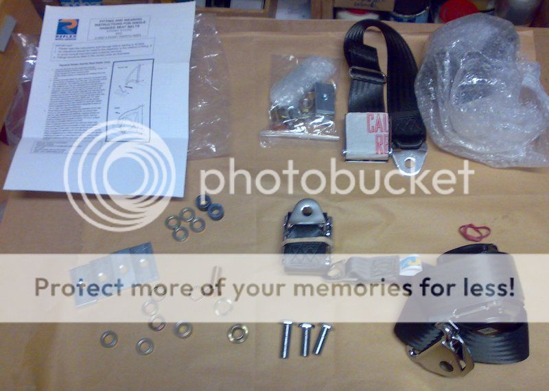

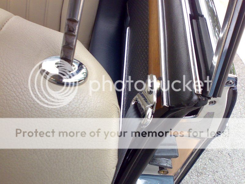

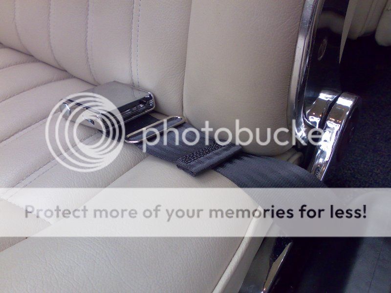

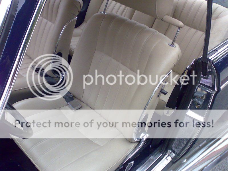

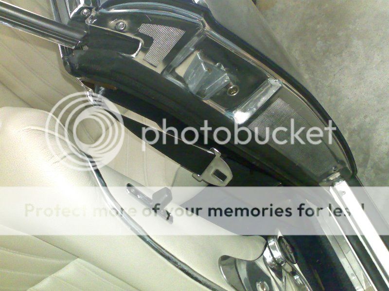

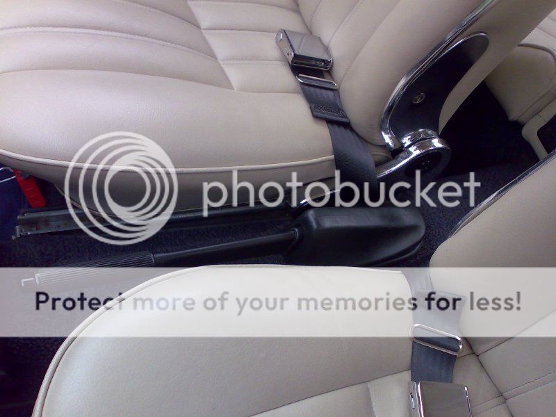

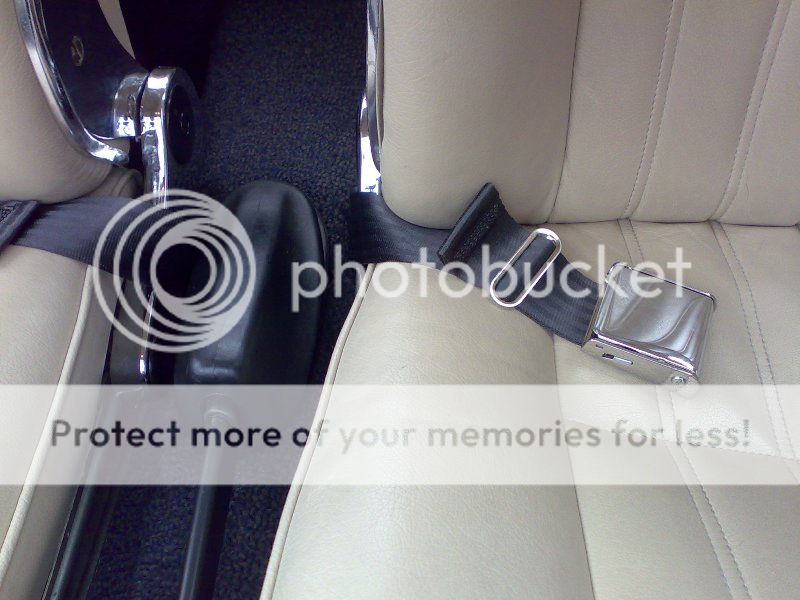

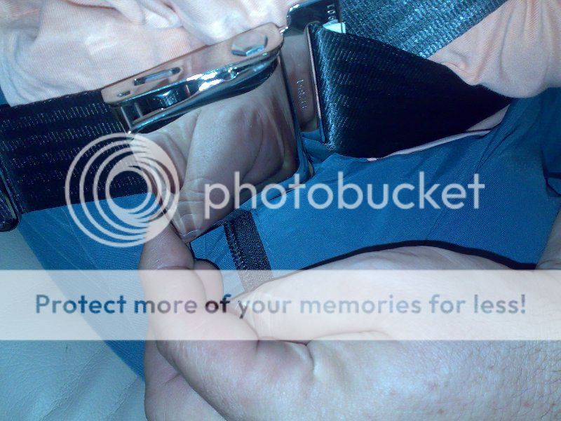

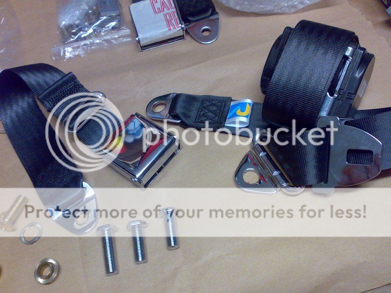

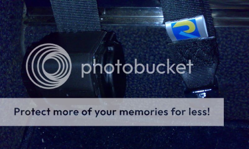

i had very badly worn seat belts, so for some years i tried to find a new set everywhere, but the seat belts that I was founding were no good, most of them made in china, or very expensive NLA+NOS ones usually only or RH or LH, but never both altogether
...until i found these people located in the UK three months ago

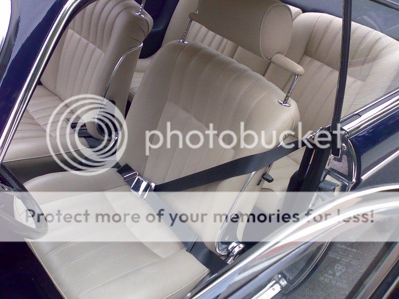

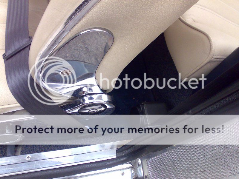

an incredible set of period correct inertia automatic seat belts with aircraft style chromed buckles (homologated in UK for cars older than 1972)
you choose the colour of the belt within a wide range, and you order them, its 5 or 6 weeks to get them done and shipped to you, kind attention and help from these guys
easy to install,...and not really that expensive (i found a set, made in china, of black plastic seatbelts rh+lh for 278eur+shipping),
...e voilà !

hi bfeng,
do not know which kind of job they did on your car, but in my case as to the price:

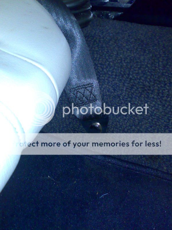

the whole set that you can see in the last pic, of two chrome buckled inertia safety belts in the strip colour of your choice, for 280£+shipment, total 300£
as i said i was comparing with other alternatives,as someone having alist price of 400eur for left hand original NOS seat belt, or a french company offering a fixed design set of black plastic seat belts made in china, for 287eur+shipping
300£ IS A LOT OF MONEY !, right, but when you see the alternatives...

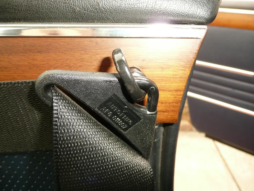

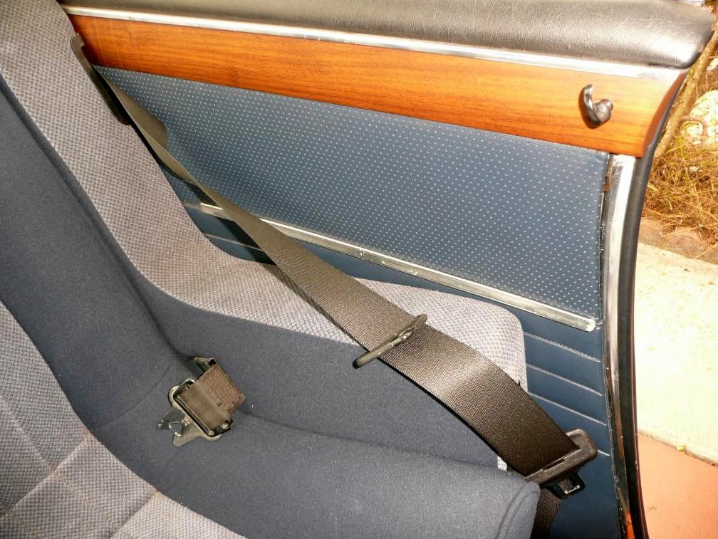

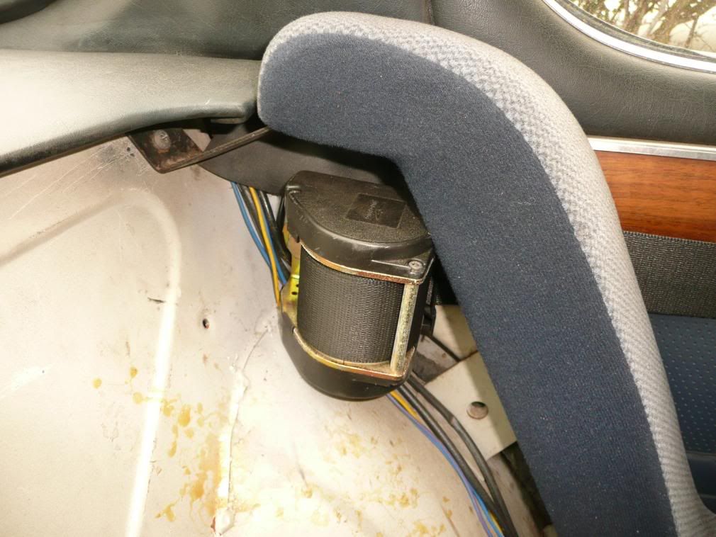

Here is my 74 retractable seat belt setup from my 72 coupe. The reinforced mounting holes for the retractable belt reels look factory and don't look modified. Suppose most coupes, if not all, were fitted with these upper mounting holes. On the 74 side armrests, a wide shallow dado the width of the belt webbing is cut into the substrate wood core and then covered with a countoured steel bracket. This feature allows for the seat belts to move freely, thus avoiding binding. Don't know whether the 74 and the earlier years armrests wooden cores are different or not, although from the outside they look identical. With this 74 seat belt setup, the roof mounting holes are not utilized. Also, one of the pics below shows a loop fastened through the side wood trim, this is not a structural mount, it is there to just "hang" the belt while not in used.

Somebody asked what mine looked like, the post above is exactly what I have. Or at least what I started with. It's a bit scrambled right now, a work in progress, so to speak. I've got to locate the hanger hole. One issue with this location is the belt has to be really long to work correctly.

Thanks all. It's now clear how BMW did this originally.
My '71 doesn't have the upper reel threaded mounting holes but my thoughts today are that a hooded inertial reel such as shown below might fit in the lower hole and the belt snout would slide behind the armrest without too much "adjustment". The snouts come in different lengths or could be trimmed to where it just peeks out into view. I'll see what Autoflug has made.
Bert's pictures show the '74 armrest sits a little farther to the rear at the bottom and a little higher at the top, thus giving a wee bit more clearance for the reel. The armrest mounting bracket at the top is different (see my '71 armrest picture) as is the profile clearance around the reel but these adjustments in mounting could be easily done without being apparent when installed. I'll get a reel and see how much space is actually required. I notice in Bert's third and fourth pictures the screw hole for the original upper armrest mount is evident.
