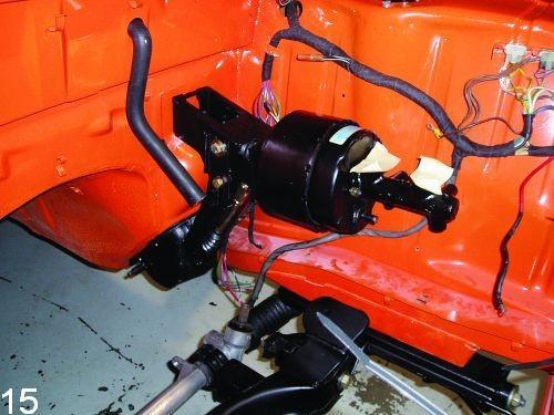

Here's a r&p setup on a coupe, perhaps JB can shed some light on it.
Hmm. That looks more like an '02...
If you can deal with the extra weight during parking and low speed maneuvers, the manual steering setup improves steering feel considerably on these cars, IMHO. Although I'd imagine finding a RHD manual setup would be even more difficult than a LHD setup.
