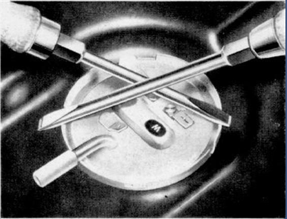

This sender rubber caused me issues with fuel smells too. It seems that when the sender is tightened, using a C spanner or the BMW 'two screwdriver' method, the rubber seal is damaged or sits in a distorted fashion.
I tried the approach of greasing the top and bottom of the places where the seal sits. It improves things, but it still has the faint whiff of fuel.

The picture that Rek has posted shows the plastic sleeve on the sender tube at the 8:00 position. If you replace the flex line in the trunk, sometimes the plastic tube comes off with, and is discarded with, the old flex line.
The o-ring between sender and tank does in fact have a circular cross secti0n - when new. Decades of pressure later it will have deformed to something approximating rectangular. Add this to my list of possible faults above!
I tried the approach of greasing the top and bottom of the places where the seal sits. It improves things, but it still has the faint whiff of fuel. View attachment 50255
I installed a new seal to ensure I was starting with a round ring, and used a tiny bit of petroleum jelly in the process.

The plastic tube at the 8 o-clock position in the pic above (post 23) also develops cracks. I've had 5 NOS sending units last year; 3 of them had severely cracked tubes, 4 of them showed a maze of these little plastic cracks that develop over time when they get brittle; for sure a easy way to get that smell of gas in your car.
Now I do think you can do without them, if you have a fuel line that can be effectively compressed to 6 mm internal diameter. But I think our standard fuel line is made for a 8 mm ID; not sure if that compresses well to 6 ID without leaks.
