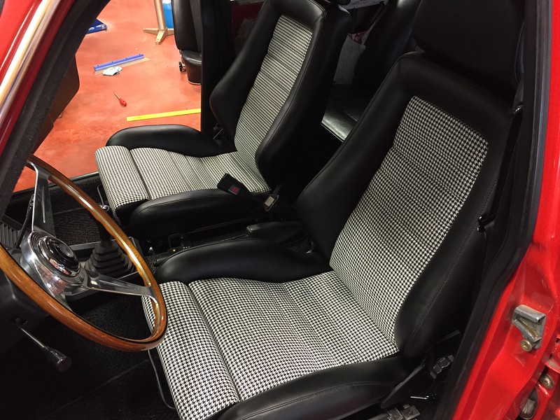

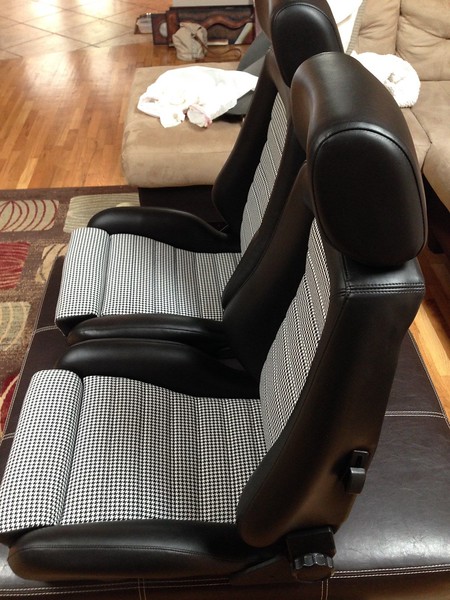

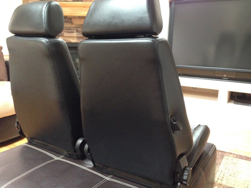

And then, about 14 months ago, a pair of nicely re-done Recaros appeared on Ebay which jumped out at me. They had been done by a guy performing a Camaro restoration who ultimately decided that they were a bit too narrow and so went off in a different direction for his project. They not only appeared to be nicely upholstered but had houndstooth inserts, a Camaro option back in the day and a look which I had grown fond of from my early 911 days. His posting was nearing its end so I did the "Make an Offer" thing and received an acceptance in about ten minutes! I don't know about you, but when it happens to me that someone accepts my first offer my initial thought is "Crap, I could have gotten it for less". Not a big deal, however, as I likely couldn't have reproduced these from a tatty pair for the same price and I avoided all of the running around and finding an upholsterer the get the job done.

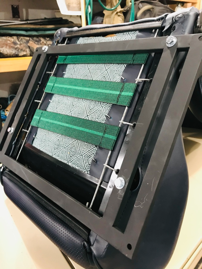

The seller separated the backs from the cushions, did a great job of packaging them and included a drawing of the assembly steps, a gesture which I appreciated when reassembling.
These are the seller's images from the posting:

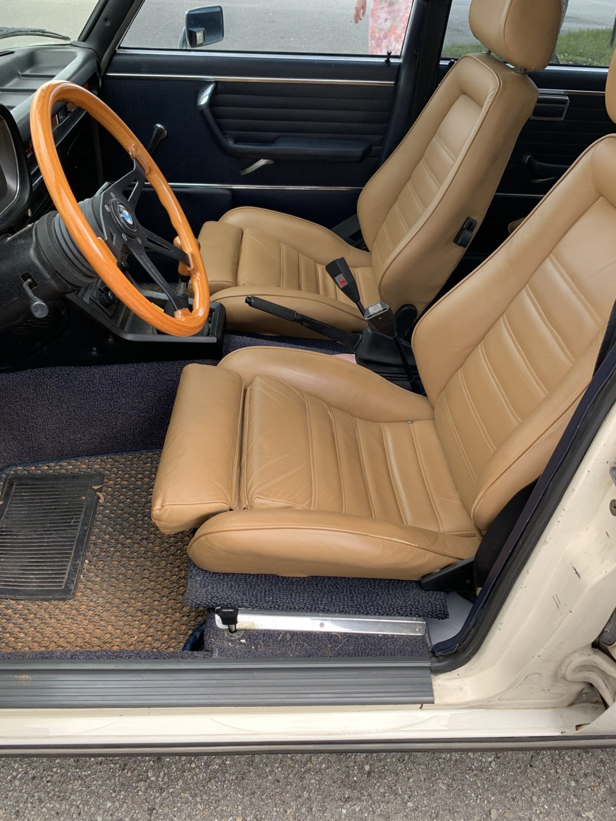

Here are the seats on the day of installation.
I still regard the Scheel 400 as top of the heap comfort wise but these guys are a very close second and have eased my "all day at the wheel" back issues to a great extent. They're also a huge leap forward in terms of lateral support and (as my wife accurately stated) the houndstooth helps to break up the otherwise sorta' lifeless black interior. The extendable front section is an added bonus as it's great for me in the long position while my prefers the retracted position.

That looks freakin awesome, second that! I always loved those being an ex-SWB 911 owner myself. LOVE THOSE! Houndstooth is timeless, always classy, just like the E3!

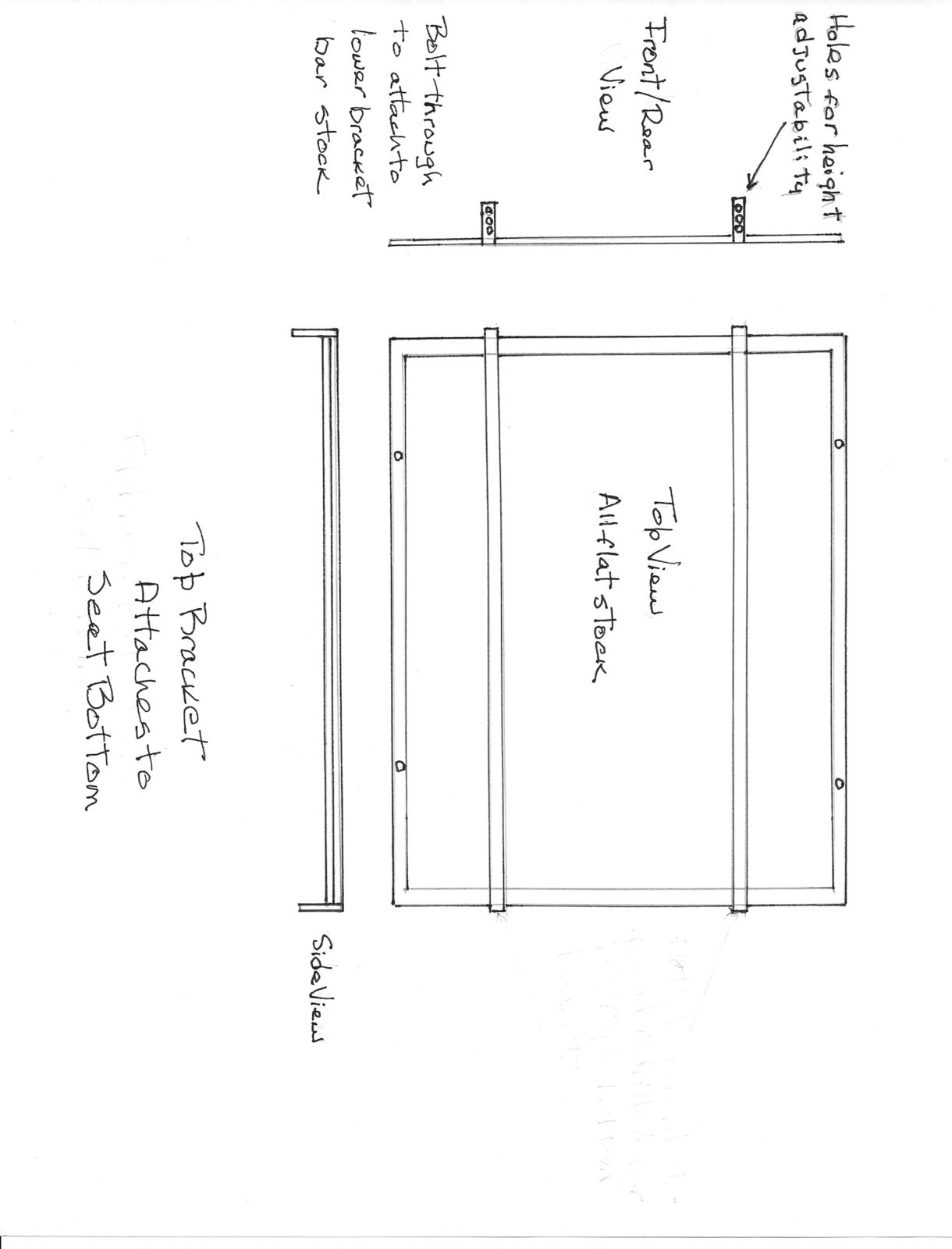

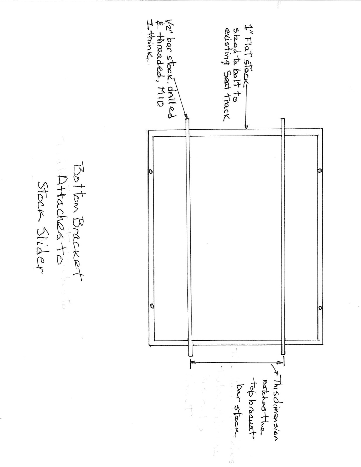

Sorry for the tardy response. We escaped Wisconsin for a warmer latitude and I wasn't paying attention. I sketched a pattern for the brackets and a talented fabricator friend made them. They are essentially the same design as found on Scheel brackets with about two inches of vertical adjustment both front and rear while fore and aft uses the stock mechanism. I'll make a quick drawing if you'd like and post it here.

Thats cool Jim. Very cleaver. Thanks! Yes please...if you could send as Word doc that would be great!! Also, when you can, a few pictures would be great too.

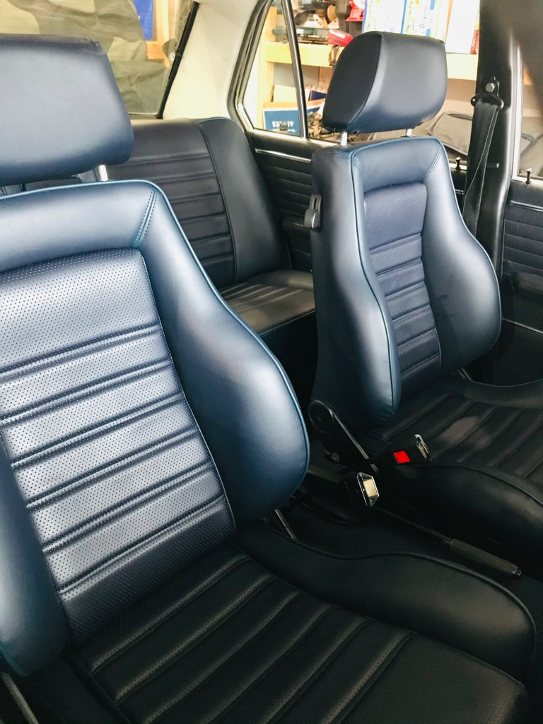

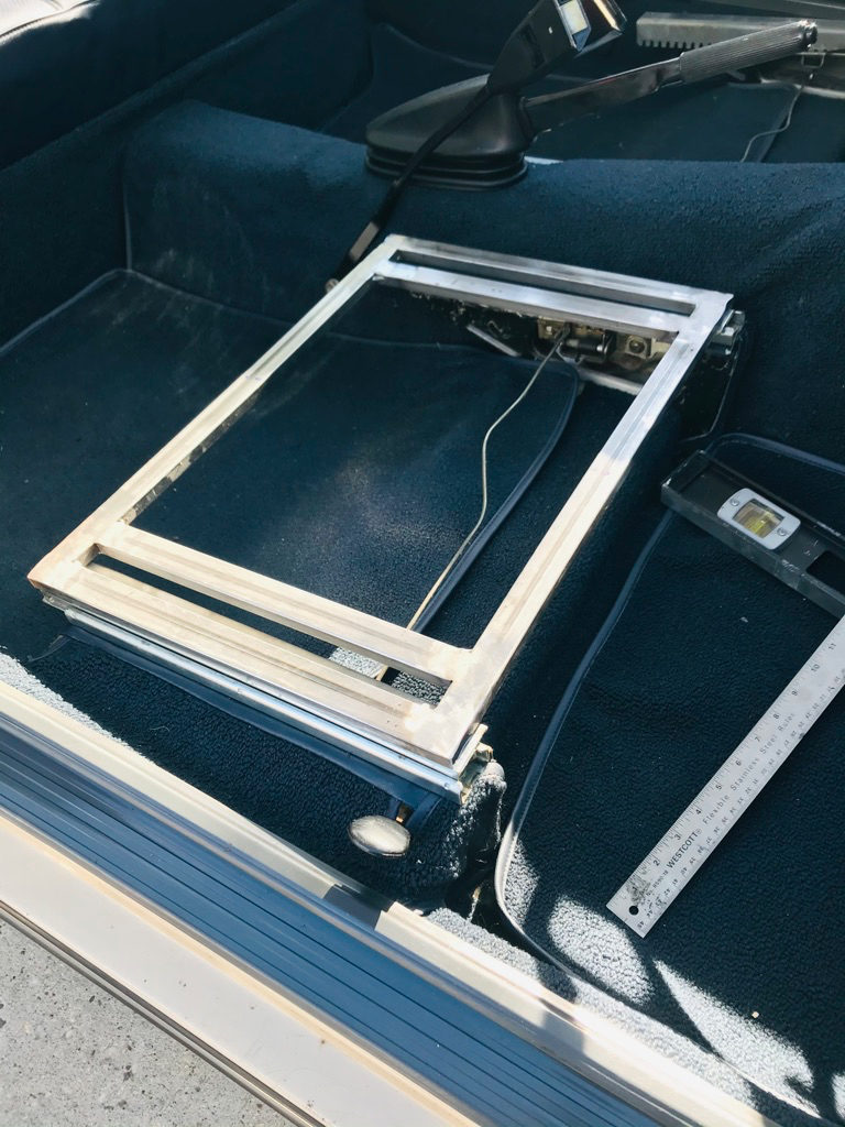

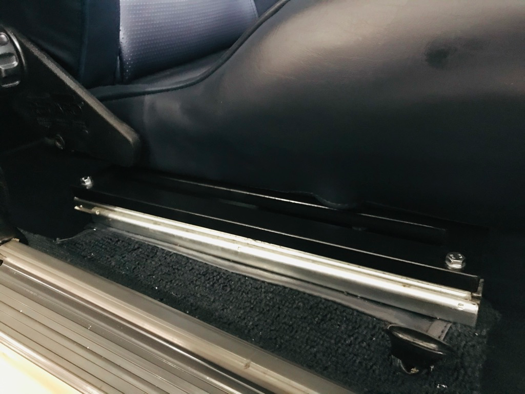

Hi Jim

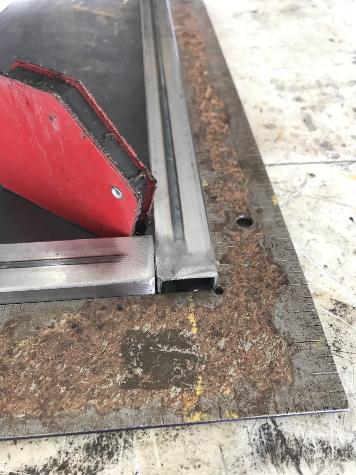

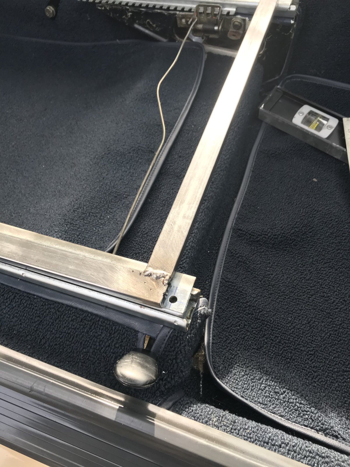

So I pulled the trigger and replaced my seats with recovered Recaros and a rear seat kit by https://www.ebay.ca/str/zoomzoomzooming. Steven Sperling is very nice to deal with and I think his shops quality is top notch. I test fitted and figured I only need 1/2" of spacer between sliders and Recaros; so I built a set of adapters out of 1/2" X 1" rectangle tube. I think they turned out great and the seats are very comfortable and supportive.
Regards,
Bill
