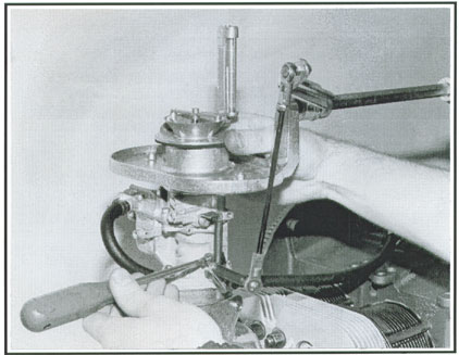

The cross bar linkage is next. The aluminum linkage arms and the throttle cable bracket slide on the steel hex cross bar and are locked in position by allen set screws. The throttle cable bracket locates one hex degree down from the linkage arms. Internal tension springs are placed in each end of the cross bar to aid in centering the linkage. Install the linkage arms and throttle cable bracket as shown. Don't tighten the allen screws at this time. We'll do that when we line everything up.
Place a small amount of heavy grease inside the support holes in each end of the hex bar. Insert the tension springs and place the right end of the hex bar over its respective cross bar swivel ball. Push the cross bar on to the swivel ball and line up the left side end of the hex bar with it's cross bar swivel ball.
Screw the swivel balls out until the cross bar is fully supported by the swivel balls. Center the hex bar linkage assembly by rotating the swivel balls. Adjust the length of the swivel ball mounting screws until the hex bar is centered. Leave about an 1/8" of side play and tighten up the swivel ball locking nuts. Make certain that the cross bar is free to rotate on its axis.
The linkage rods and heim joints are next. Please note that each linkage kit is set up with two standard right hand threaded heim joints and two with left hand threads. The linkage rods are equipped with matching left and right hand threads. Each linkage rod needs to have a linkage extension arm threaded onto one end of the rod. The linkage extension arm is attached to the carburetor end. Once installed you'll be able to fine tune your throttle adjustments by rotating the throttle rods. Once adjusted, you lock them in position by tightening down the lock nuts. The lock nuts are also supplied in left and right hand threads.
When you think you get all of this left-hand/right-hand stuff figured out, and assembled, install the throttle rods into the aluminum linkage arms. A suggestion here is to position the heim joints with the left hand threads at the top. Install the heims with the right hand threads on the bottom or carburetor end of the throttle arms. Don't lock anything down just yet.
Position the aluminum linkage arms on the cross bar so that the throttle rods are vertical when viewed from the rear of the engine. Lock the aluminum linkage arms into position by tightening the allen set screw to prevent the aluminum linkage arms from sliding on the hex bar. Slide the aluminum throttle cable arm into position to line up with the throttle cable tube in the fan shroud and tighten down the allen set screw.
The trick now is to get your linakge aligned to match your pre-set carburetors. Don't adjust your carburetors to line up with the linkage rods, adjust the linkage rods to fit the carburetors. The linkage rods are held in place with shake proof lock nuts. Work the throttle a few times to make certain that everything is free, doesn't bind, and that the throttle stops on the main shafts in the fully closed position. The main shafts in the carburetors are spring loaded. Both of the carburetors should return to their closed position with a solid snap. If they drag, or return slowly to a closed position, check it out because something is not right. If everything is in correct working order, tighten up the shake proof lock nuts that secure the heim joints into the upper and lower linkage arms. Tighten these to no more than 2 lbs. of torque.
Now let's check out those left and right threads on the linkage rods. By rotating the linkage rods you'll be able to extend or shorten the rods. This will allow you to align the linkage to match the preset carburetors. Don't adjust the carburetors to match the linkage because you'll throw 'em out of sync. Adjust the linkage to match the carburetors! Don't mess with the pre-set idle speed control screws or you'll throw your carburetors out of sync. Make the necessary adjustments in the linkage rods to level or equalize the cross bar and linkage arms.
When you think that you've got the linkage dialed in, push the aluminum throttle arm downwards and watch the linkage arms as they move from closed to open. If one carburetor "leads" the other, you've got some more dialing in to do. The opening and closing throttle action has to be precise. So play with your throttle until it works just right. Don't attempt to reinvent the linkage system. Simply adjust it to match you pre-set carburetors and then lighten up the four lock nuts on the throttle rods.

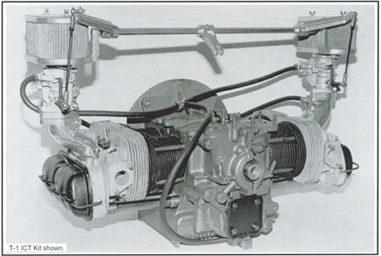

Your carburetor kit should look something like this. Check it over carefully before putting it on the road. Check for any possible fuel leaks and tight or sloppy linkage. Make sure all tools or misc. items are picked up and removed from the engine compartment. If everything checks out all right, you're ready to go and try those new carburetors out.
