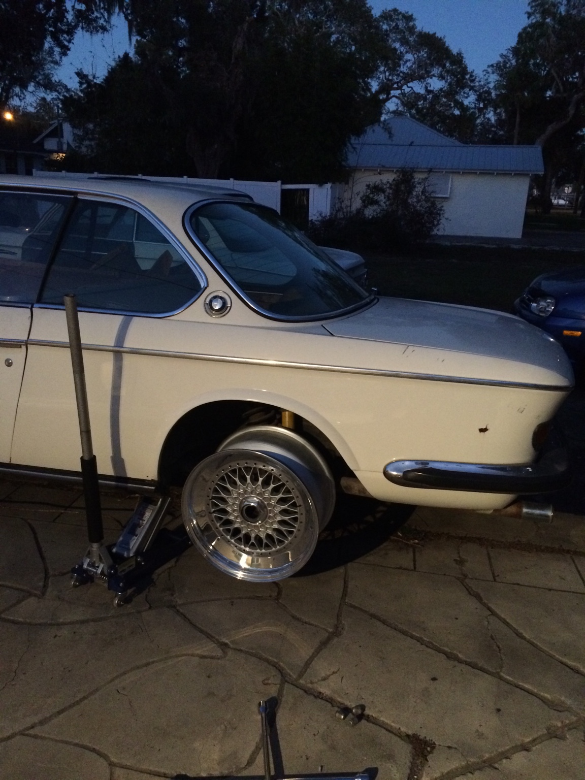

For the rear, I believe it is possible to run 10" wide with and ET10. I state this because I have put a 9" RC91 on the rear and there is still close to an inch space. By decreasing the offset to 10 to bring the wheel out further and increasing the width by an inch, I think the face would be near in line with the edge.
While I have an RC91 barrel, I have RC90 faces to decrease the offset marginally. I attach a photo of the result at the rear. Tomorrow I will install the front and take a picture of that too.

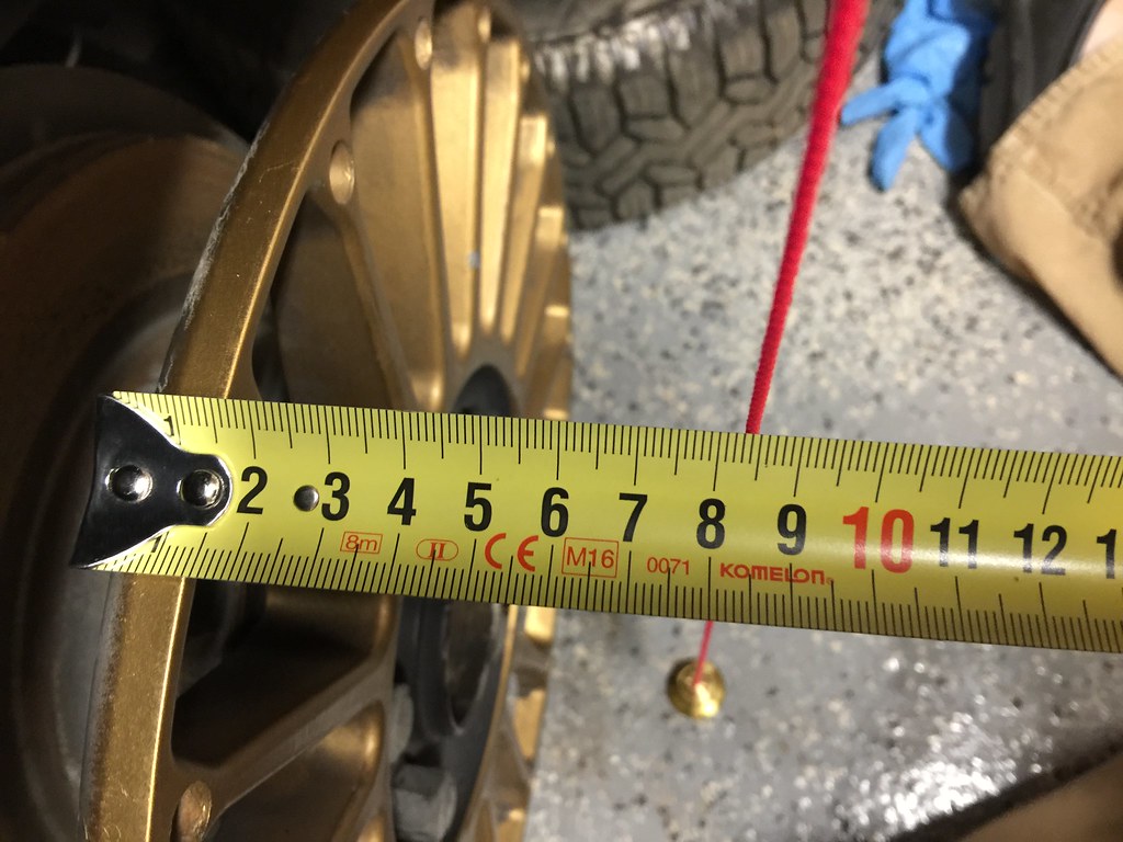

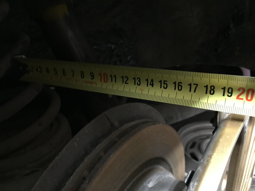

It looks like you have a little too much droop in your suspension for an accurate measurement. I think every millimeter counts when you are stuffing the arches with big wheels. I measured 34cm from the center of my hub to the fender arch on my project car (you can see the wheel gap in my profile pic). I measured my rear the other day and set my suspension at 38cm. I ran out of room so I picked up a bottle jack at HF the other day to help cycle the trailing arms. I'm going to remeasure at 34 cm then bump it up more until I'm at no wheel gap and see how the clearance changes. With my WEDS faces installed at 38cm ride height, I had 3.3" of clearance to the outer fender lip, or about 3" to the inner, and 7.2" from the coil spring to the wheel face. Now I know that a member is running 3.5" lips on his custom widened WEDS without rolling the fenders, which leads me to believe that I need to remeasure with the suspension compressed more. BarryG is running 4.5" BBS RS lips on his 10" wheels, with rolled fenders and a very low suspension.

I hear 9" in the max wheel size you can fit back there and that probably DOES include rolling the fenders.

Surely you can speculate but many people run 17x8 up front with no rubbing, and 9.5's will fit in the rear. If you look at my measurements above there is nearly 11" of fender clearance in the rear Also, lowering the car creates more negative camber and generally helps one fit larger wheels.

Thanks for the feedback all. Markos, I agree that there must be a fair amount of drop in my springs as they still look original. Thank-you also for taking some comparative measures. I take it that you loaded the suspension to normal ride level for those measures. I lowered my car down to level to take mine. I am yet to take more as I had suggested as I did not get my wheels back from the refinisher.
As far as considerations of height go, the drop won't affect measure as the geometry of travel will be the same and the spring determines the static position and the rate of travel under load... just stating the obvious :). I will be interested to see how it all shapes up once I get my Ground Control setup.
With regards to the feedback on rim widths, I think the warning of rub beyond 9.5" is fair by teahead. While we can roll the edges of the arches, I tend to agree the from of the arch will lead to rubbing with a rim that is in line with the edge of the wheel arch lip. Running a wheel in line with the edge of fender would need an alteration of geometry in my opinion and is likely how others have run 10" wide at the rear.

Wise9uy,
My ride height at that measurement was 38cm. My project car is 34cm with plenty of wheel gap. I'm going to try again this weekend and do 32cm and 34cm.
