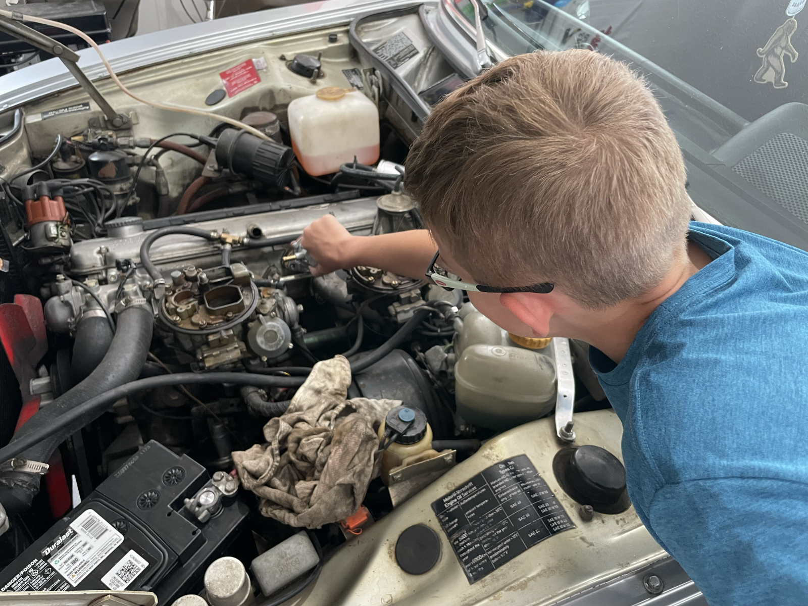

New Pierburg fuel pump and Bosch coil arrived today. I'm still waiting on Pelican to ship the points and rotor I ordered. My son was eager to lend a hand to swap out the fuel pump. Another 6 mile trip was without incident.
