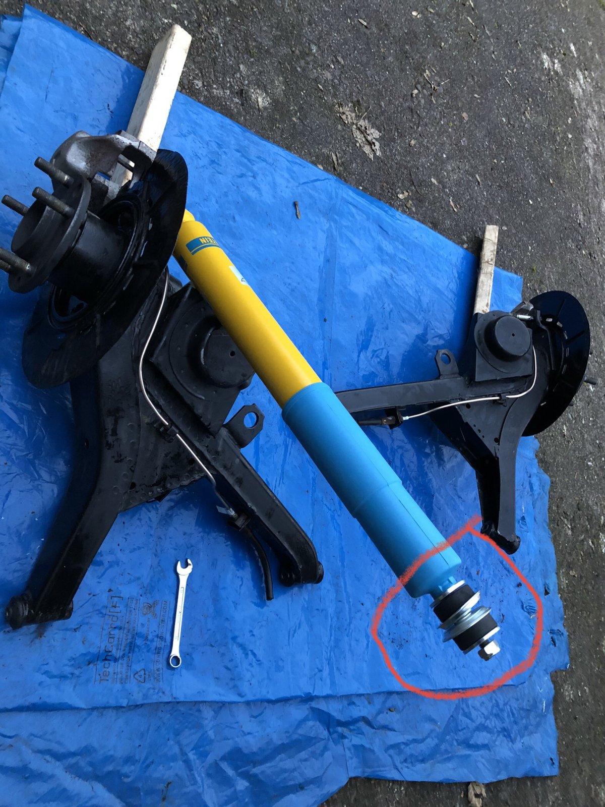

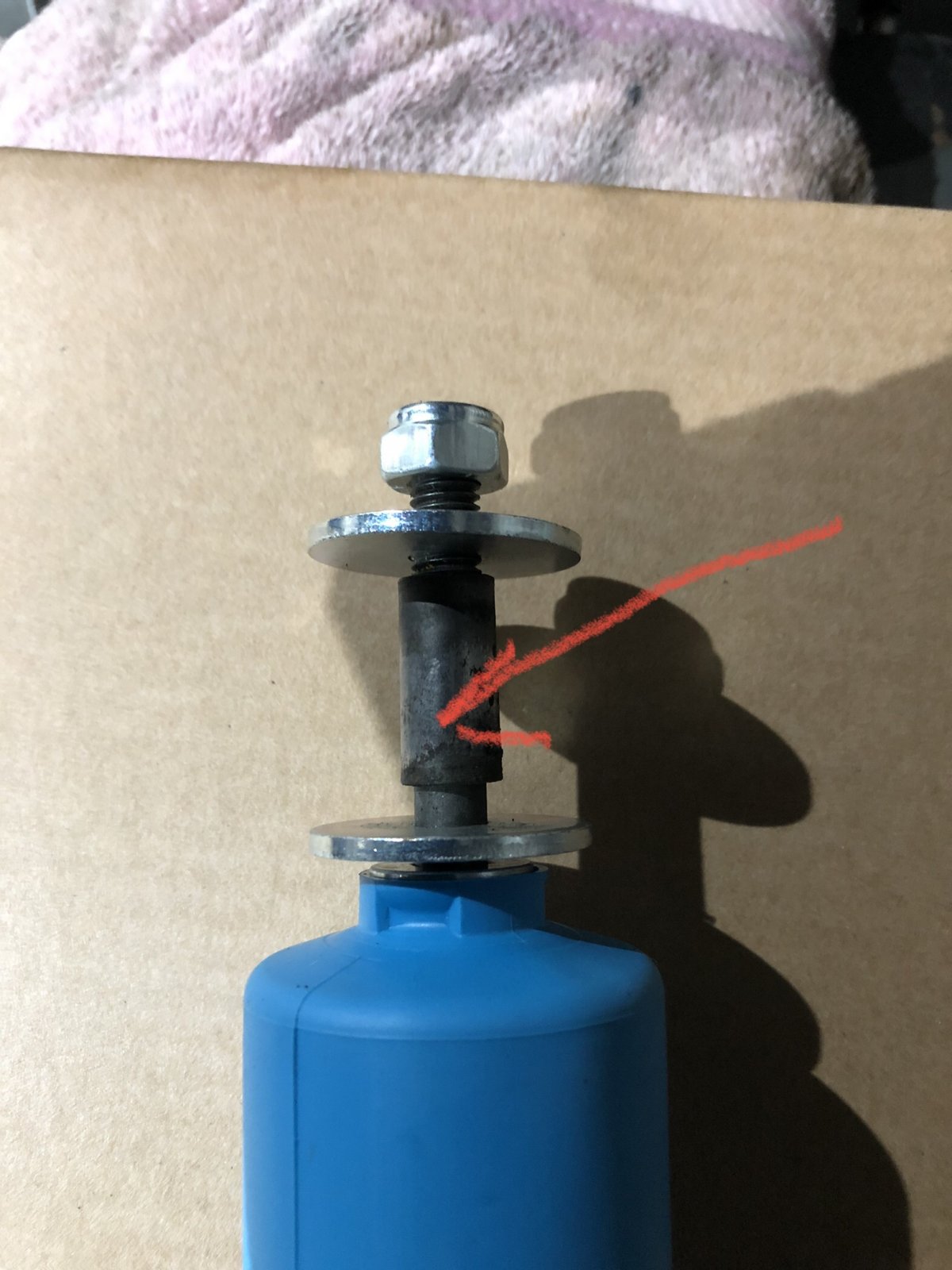

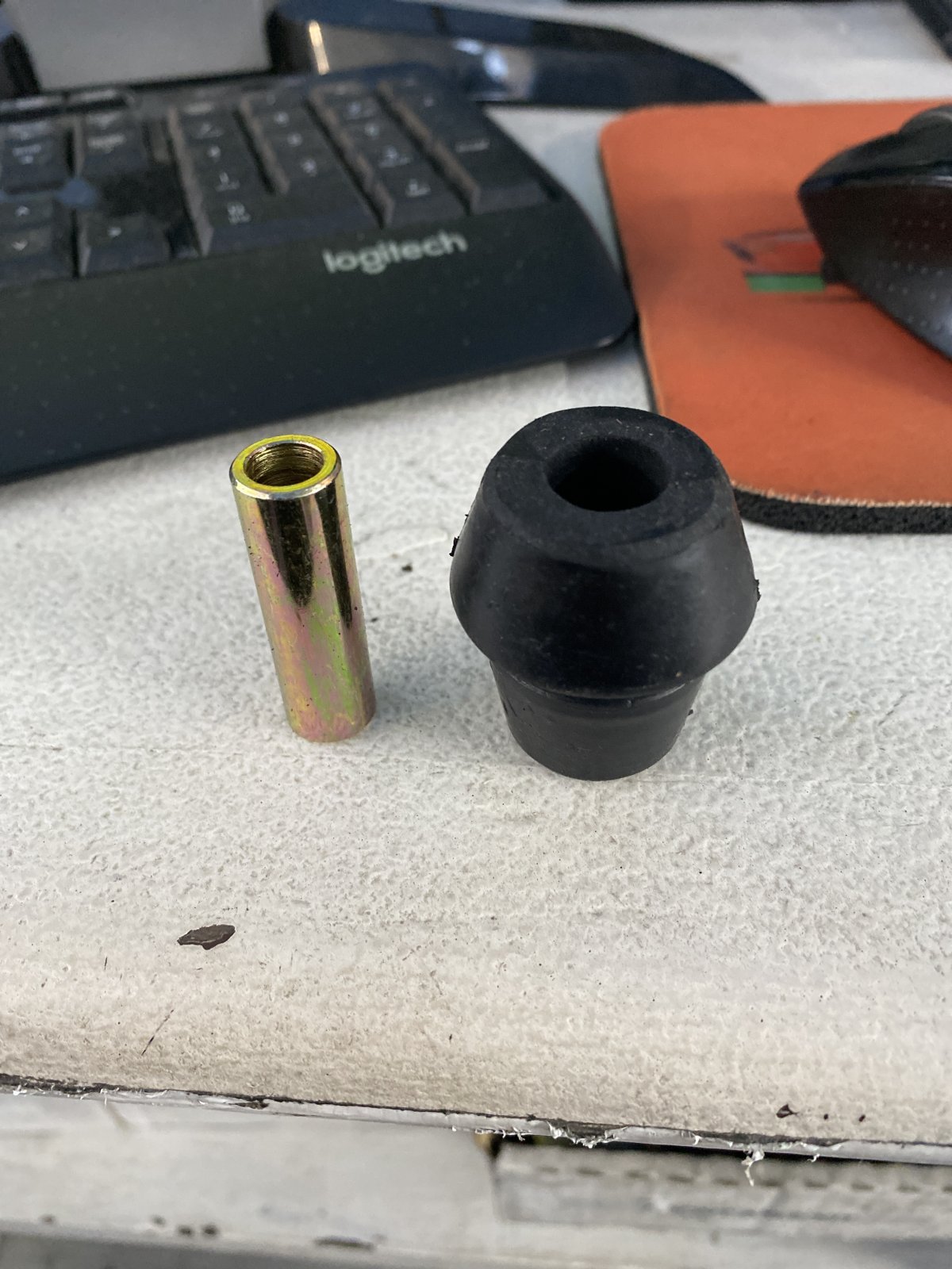

Hi Don
I was trying to fit my bilsteins earlier and I kept just pushing the metal sleeve / bush up out of the rubber part
Is there a trick to aligning them easily ?
Ie should I have the metal sleeve on the new shock or should it be already in the rubber part waiting for the new shock ?
Obviously in the photo the nylock nut and washer are still there , I have those removed before I tried to fit the shock.
I will not be using the stack that came from bilstein in the 2nd photo.

Put rubber bushing into fender, push metal sleeve into rubber bushing, install shock from below. Your first pic has a rubber sleeve on the shock, remove that.
Thanks Chris
I will try that.
