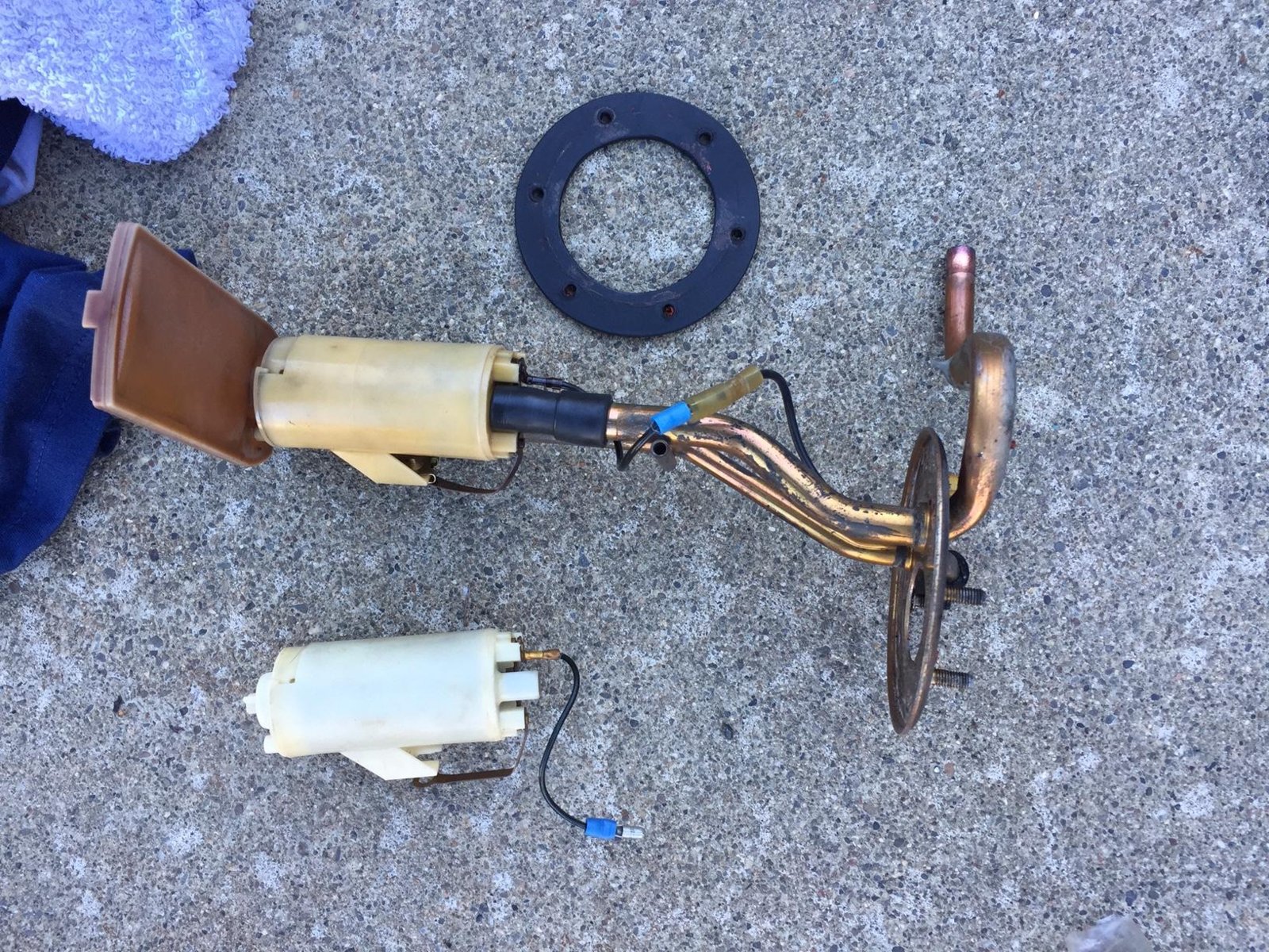

I use the VDO lift pump from any of the dual pump FI systems. It supplies about 3# of pressure and mounts directly in the tank. For my E3 I use a E28 mounting bracket with the six mounting screws with the accompanying sender. I've had this system in my car for many years and it works very well.

Can you use the sender from it also?
You need to use the sender as well because it plugs up a big hole in the pump mount. I wired it into my stock gas gauge and it works reasonably well. Not very linear, but it has the low fuel warning meant for the injected cars. This gives you a little extra cushion when you're running low.
I've been using these pumps for 10 years and they've done an excellent job. No fuel starvation problems, and they're easy to change if it fails. I had a pump failure a few years ago and it took me about 20 minutes to install my spare. As you can see from my pic on #12 the spare is ready to plug in.
